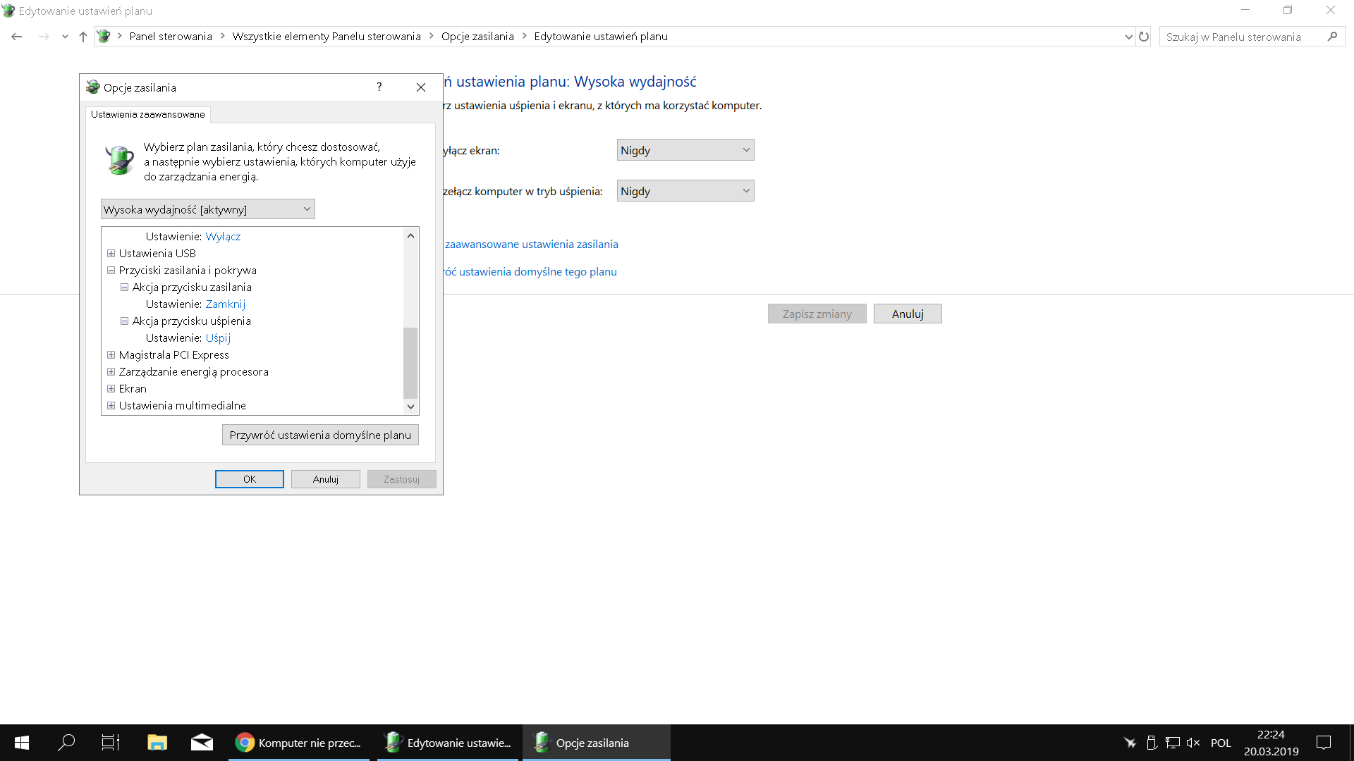

    Hi,
    My computer does not go to sleep after selecting this option. Only the monitors turn off. The computer itself works / fans are running. Amazingly, after logging out the user and enabling the sleep option from the login screen, it is ok - it goes to sleep. Anyone know what to do about it?

  • #6 17856344
  • #7 17856658
    hipperion
    Posts: 19
    Tomequ123 wrote:
    It's rather clear that Win 10, Z390 is the only one that allows you to install it. Home or Pro?
    Check Control Panel> power options> change plan setting> change advanced power settings, which is set to sleep.
    Windows 10 pro
    In advanced, I have "sleep after 15 minutes" and "allow resumption of work according to the timer: enable"

    hipperion
    Posts: 19
    Interestingly, I only have two options under sleep ... I don't have hybrid sleep or hibernate. But I'll set the rest and check.
    EDIT: It didn't help.
