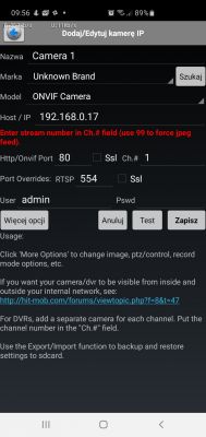

    I managed to set the camera in the IP Cam Viewer Lite program, even the control works. Chinese INQMEGA IP camera - is it possible without the manufacturer's cloud?
    In the pswd field, enter 12345.
    We enter the IP depending on what we have set.
    Regards
    PS If someone is interested in the preview itself, there is streaming in the VLC application and it even works fine.
    We enter in rtsp:// (IP address of the camera)
    Of course, it's all over the LAN.

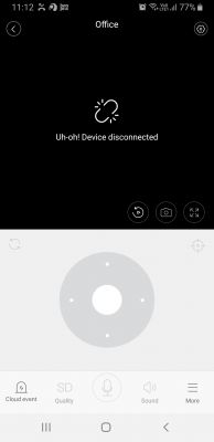

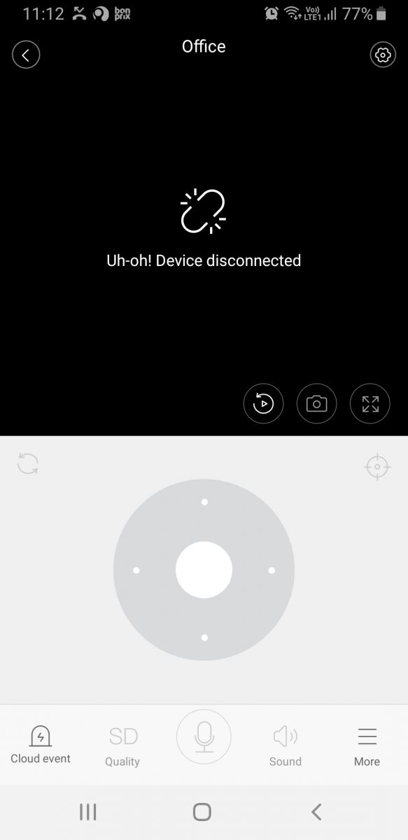

    Hello. Please advise and help. It hangs up after inserting the card. Even after a reboot it works for a while and then disconnects again.
    Chinese INQMEGA IP camera - is it possible without the manufacturer's cloud? Chinese INQMEGA IP camera - is it possible without the manufacturer's cloud?

    Looks like a weak power supply how many amps is yours?
    Try on another
    Regards
