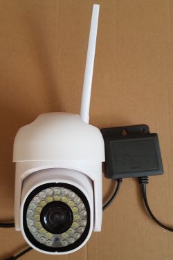

    White rotating camera with WiFi antenna and mounting plate.
    I bought the camera on a well-known auction site, it cost PLN 75 then, now it costs PLN 85.
    Product image of an Asato outdoor rotating IP camera on an e-commerce platform.

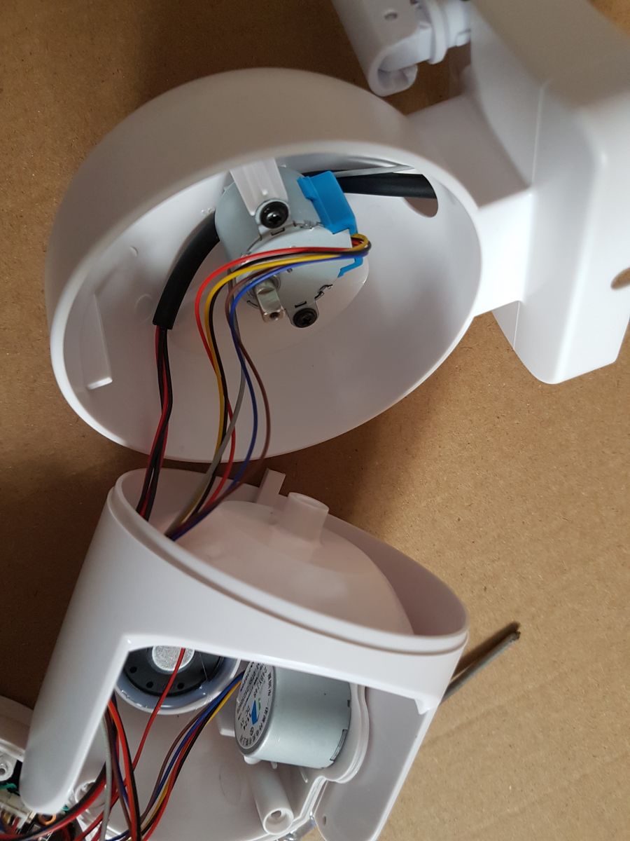

    The device can be easily disassembled, 3 screws connect the balls to the camera and the whole thing is suspended on the ears of the rotating mechanism (1 screw).
    I had to disassemble it to replace the power cable - the original one was a 15 cm cable with a plug, I replaced it with a longer one.

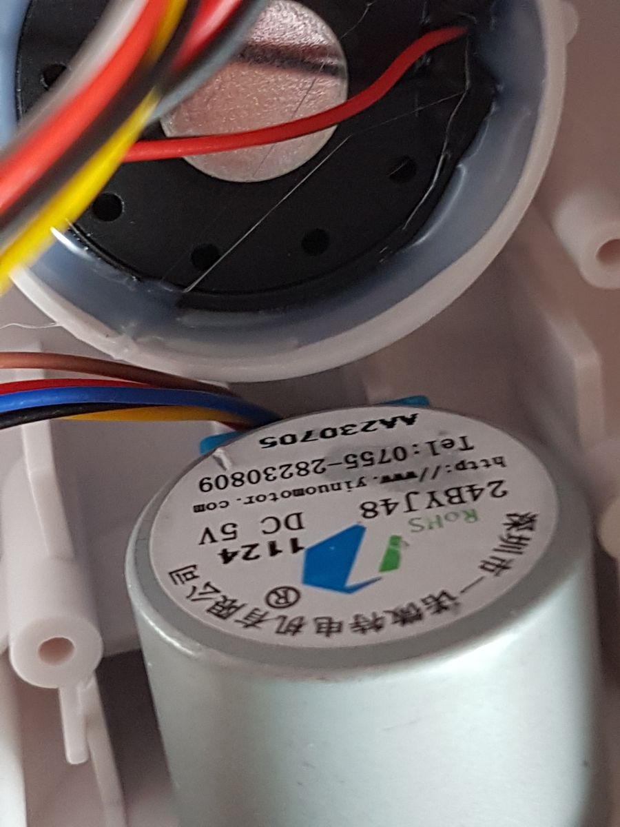

    I don`t want to go into the details of the construction - one note, the rotation mechanisms do not have information about the position, everything is based on the number of rotation steps,
    at startup, full-range calibration must occur in both axes.
    Below are some photos of the interior.

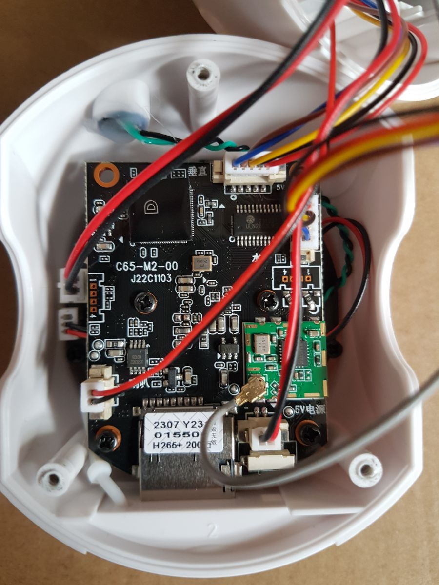

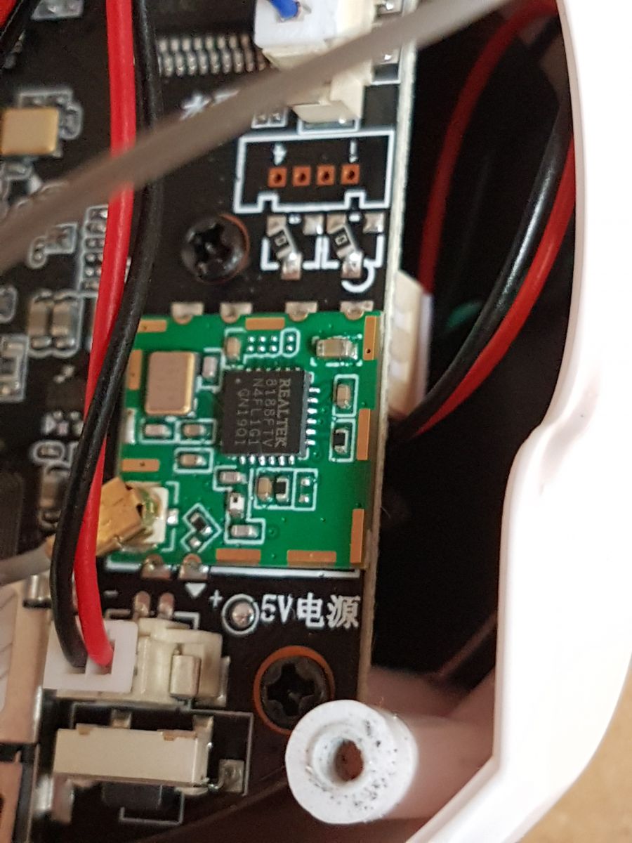

    Main board:
    View of the interior of an IP camera with visible main circuit board and wiring.
    WiFi module:
    Interior of an IP camera with visible main board and WiFi module

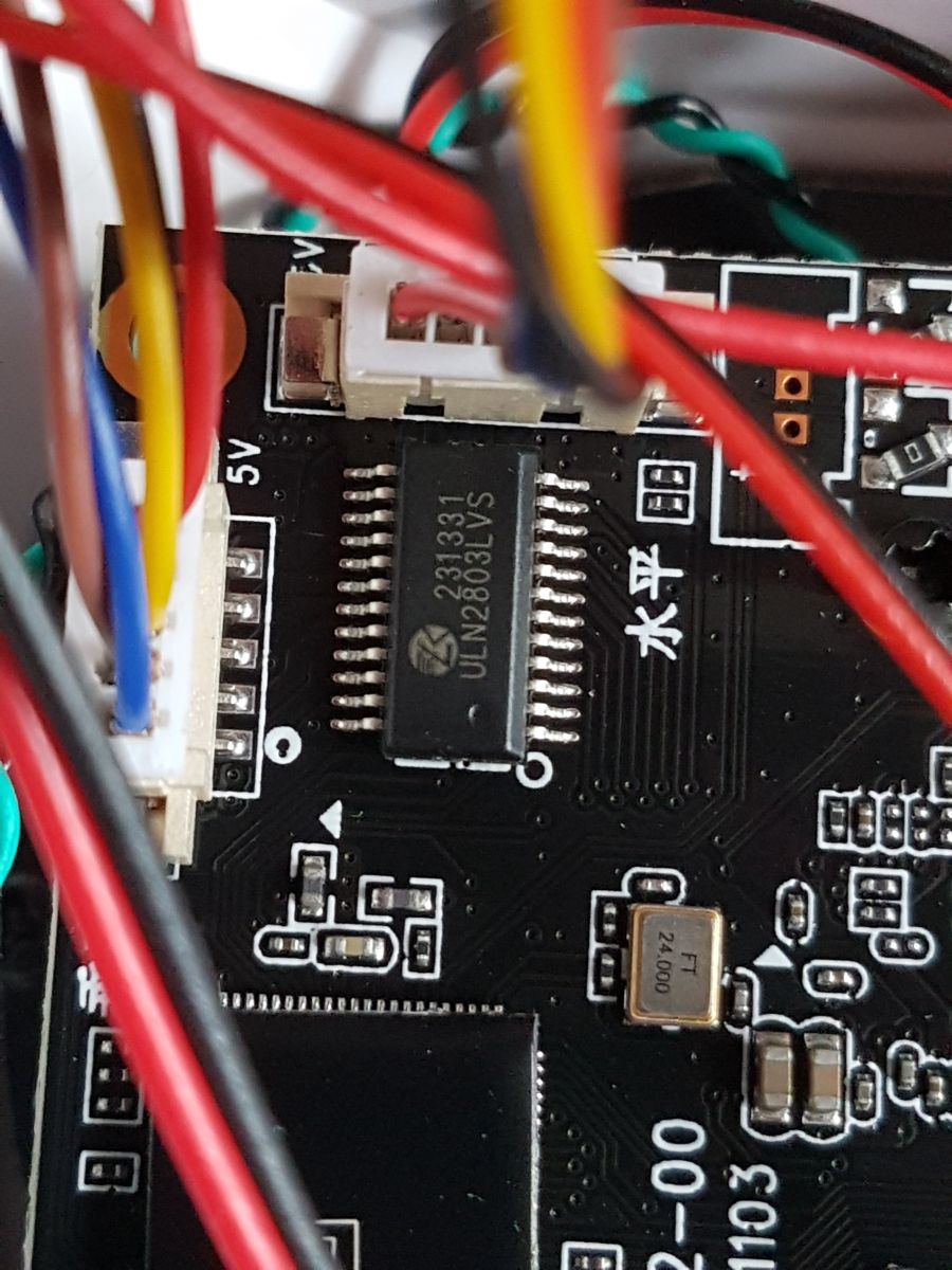

    Motor controls and their appearance:
    Close-up of a camera's main circuit board with wires.
    Interior of an IP camera with visible circuit board and wiring. Close-up of the interior of a camera showing the motor and wiring.

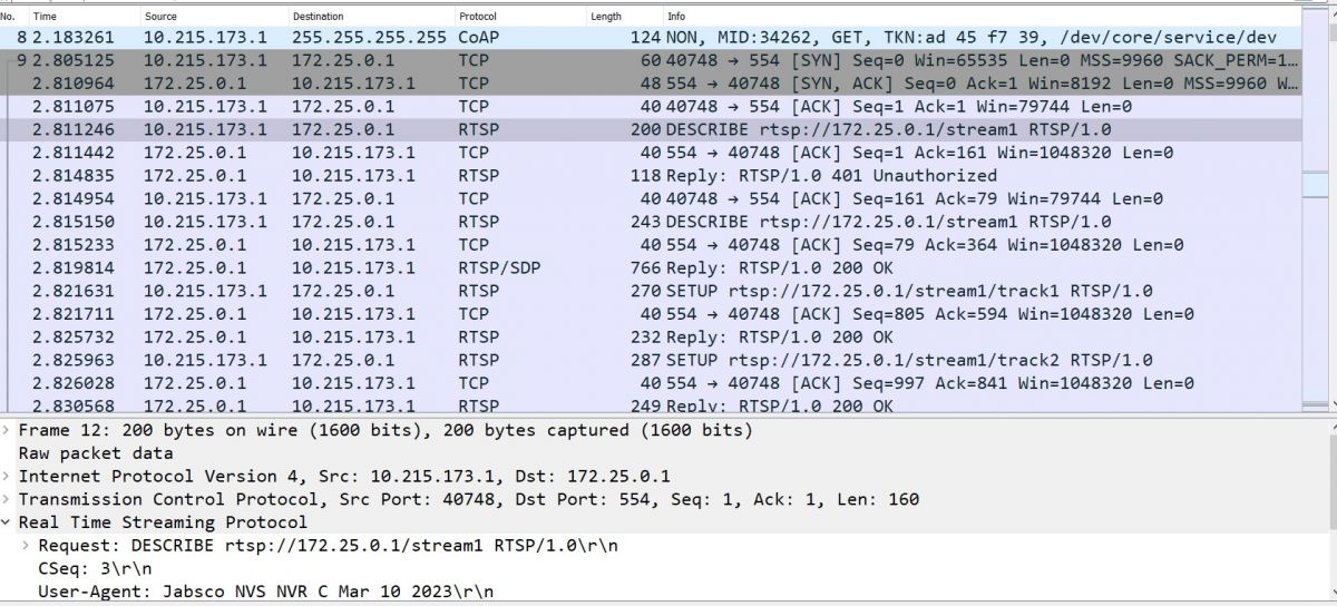

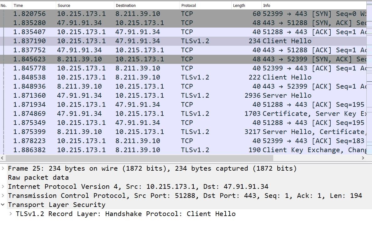

    I decided to listen to her communication using PCAPdroid (on the phone), but the communication with the external cloud was immediately secured by TLS, so I didn`t learn much.
    Frame examples:
    Screenshot showing network data of TCP and TLS packets.
    Changing the connection mode to AP helped, I reset to the factory and connected directly.
    It turned out that the application easily uses only RTSP for communication and without encryption.
    I saved sample packets from the phone while I was working and analyzed them.
    Screenshot showing network traffic analysis results using the RTSP protocol.

    Peel off the plate from the CPU. But generally speaking, I see that it`s an ingenic board, so you can upload openipc there.
    They come in various configurations, even with 3 cameras
    I didn`t know there was an alternative to this processor, I didn`t even care what it was like.
    It meets my needs, so I didn`t interfere that much.

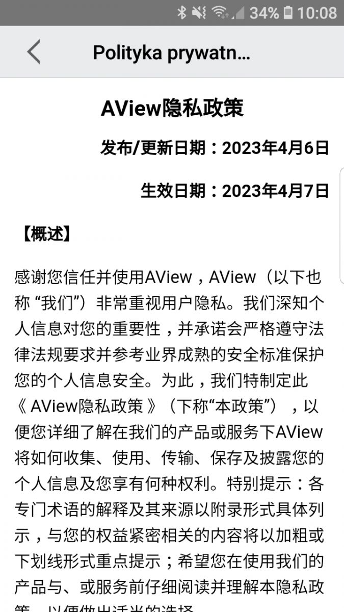

    I don`t understand this approach to today`s technology. Users lack imagination. The Chinese may not be evil to the core, but unlike others, their imagination is exceptionally extensive. They have a lot of experience with painting. Their society has accepted surveillance, do we want it too?
    This is the beginning of the Privacy Policy of this app. Who read and agreed?

  • Tuya cloud requires exposing the device
