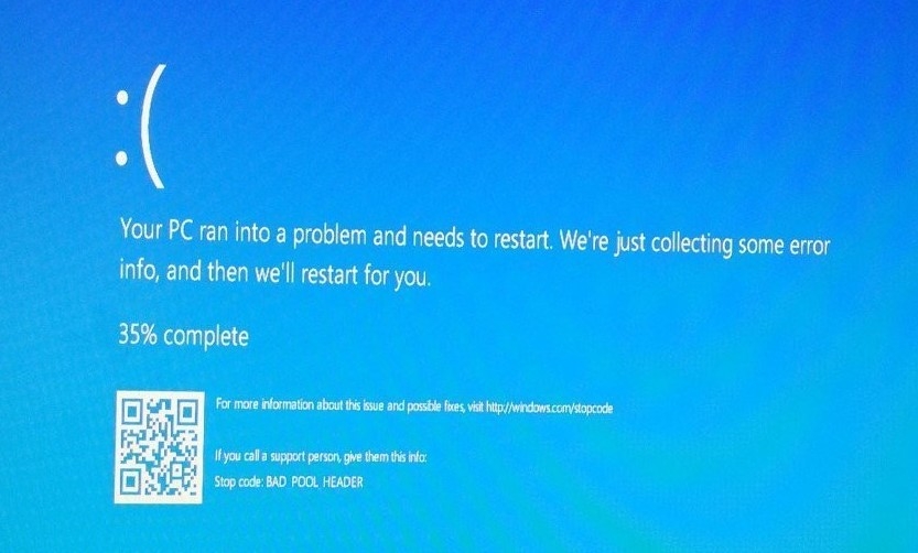

    Hello, as in the topic of windows loading for 3 hours, I did restart all commands, etc. I do not know what to do and I wanted to play because I was in high school on Wednesday, so I am asking you an idiot when it comes to the system and computers.
    Please help
    Cooperator2000
    edit after more than 1.30 h popped up that the computer could not start and restarts

    After trying to turn on pc, windows 10 keeps loading endlessly this circle
    Tomequ123 wrote:
    Show this message.
    It could be disk fault, damage.
    http://netdiag.pl/artykuly/mhdd/
    If you cannot check the disk on another computer, create a medium from MHDD.
    If everything is ok with the disk, you can try to repair it from the Windows installation media.
    here's the mistake After trying to turn on pc, windows 10 keeps loading endlessly this circle

    in the computer, not with the system itself, I only replaced the graphics with the gtx 660 and the power supply for 550 wa the specification is a dell inspired computer only with a changed power supply and graphics card
    edit the drive is supposed to be functional

    Did the problem occur after replacing the graphics and power supply?
    edit the disk as if it is working
    The drive is either functional or not, you have to be sure of that.
  • #9 17919604
    cooperator2000
    Posts: 9
    well, that's the gtx 660 card
    atx plus gamemax power supply
    intel i 5 4460 processor
    hdd drive from dell 1 tb
    Dell motherboard 088DT1 88DT1 Inspiron 3847 MIH81R / Great 13040-1M GGDJT
    I will not give you a photo because I have a broken camera on the phone but it was scanned that the disk was functional, after I put the disk in the old pc, it worked normally
    the graphics work normally, everything displays without a problem I have it for a month now
    How to restart the bios as I said, I'm an idiot when it comes to the system, etc.

    Tomequ123 wrote:
    Probably yes, but I thought we wanted to avoid it.
    You still haven't shown the crystal disc info screen.
    I'll wait 1 more hour my cousin will be he knows he knows so we'll try your methods I'm green in computers so I don't get it too :D

    However, we did the format, it turned out that I had a mega-filled disk with viruses thanks to everyone for help, but there are normal and helpful people on the Internet, not just trolls
    thanks still races and have a nice day
