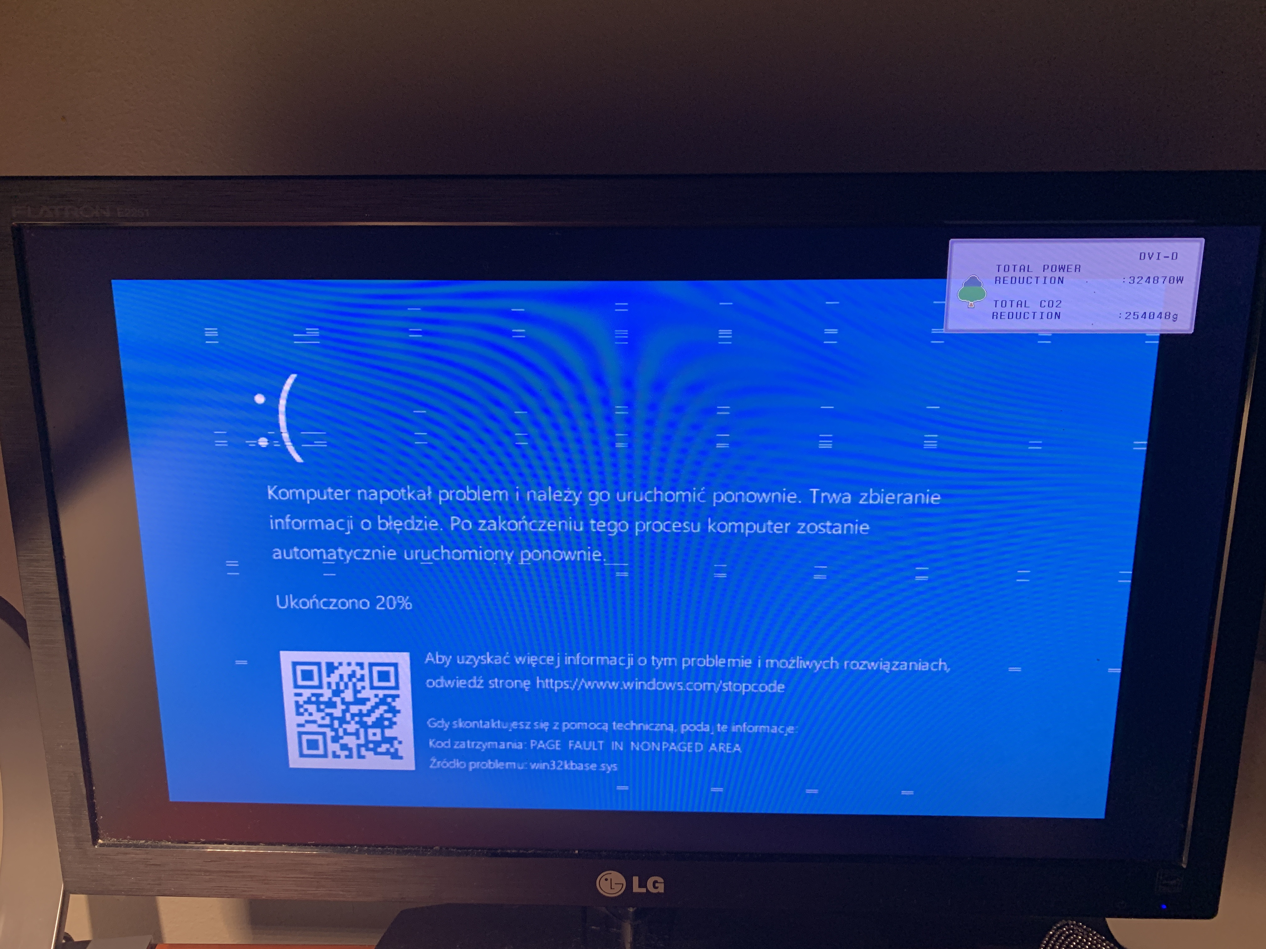

    Hello, I have a problem with my Windows 10 computer - a message like in the picture appears
    The computer ran into a problem and should restart it over and over again.
    and nothing else happens. The computer turns on and off all the time, I can't do anything. I am asking for some advice

    probably on the bald on the disk, turn on the SMART disk:
    - connect to another computer and read
    - boot from Linux live
    Why did the problem suddenly arise? unusual system shutdown? updates?

    It happened when the Fortnite game was launched but my daughter has been playing it for half a year and it never happened yesterday she started the game and something like that popped up so I don't know ? I don't know computers I have no idea what to do thanks for the answers

    These could be symptoms of a bad disk, for example bad sectors, but it would be a good idea to investigate, maybe ask someone who has this concept not to damage more.
    How old is your computer? how long used, maybe you know something about its parameters?

    Windows installation CD and "repair system" option?

    And it is known that the disk has failed 100%?
    but it is not known 100% that he did not do it, so there is a risk.
    Everything indicates that the disk has lost something, but why we are trying to find out.

    That's it.
    The service technician first checks the hardware and then starts repairing the software. Never the other way around.
    And it would be good for everyone to absorb it.
