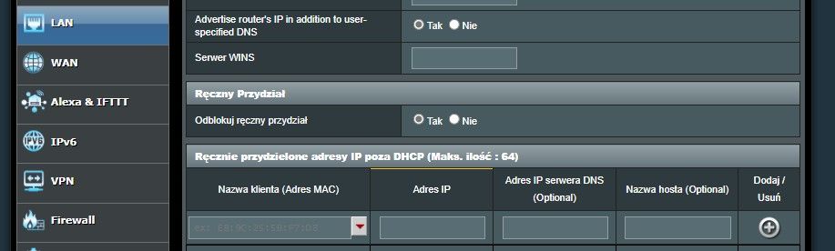

    I have been struggling with decoders for a long time. I would like to point out that I have two CP decoders (including one as a multiroom) and two routers, one downstairs in wireless mode - the main one, and upstairs the other one being a wifi extension as a bridge or aimesh (cameras and mobiles upstairs). In an ideal world, the decoder upstairs should be in the same network as the decoder downstairs i.e. in the same location as the main router. And here is always the problem. One solution is in the settings of the main router LAN/server dhcp/manually assign an ip address outside of dhcp...add the aforementioned decoders (mac address and their IP addresses). In my case, it helped. By the way, reset the decoder with multiroom before the settings. Unfortunately, there is no option for the decoder to automatically connect to the router at the bottom. Even though you make the same network the same channels, the decoder will still choose the closest and strongest signal subnet. This is an option without cable. Stable but when you reset something it processes from the beginning ;) .
    I point out that the two asus are the topic here.
    Screenshot of ASUS router network settings with manual IP address assignment option .

    dziusekGA wrote:
    I have been struggling with decoders for a long time.I would like to point out that I have two CP decoders ( one of which is a multiroom) and two routers one downstairs in wireless mode- the main one and upstairs the other one being a wifi extension as a bridge or aimesh ( cameras and mobiles upstairs).In an ideal world the decoder upstairs should be in the same network as the decoder downstairs i.e. in the same location as the main router.And here is always the problem. One solution is in the settings of the main router LAN/server dhcp/manually assign an ip address outside of dhcp...add the aforementioned decoders (mac address and their IP addresses).In my case it helped.By the way reset the decoder with multiroom before the settings.Unfortunately there is no option for the decoder to automatically connect to the router at the bottom.Even though you make the same network the same channels the decoder will still choose the closest and strongest signal subnet.This is an option without cable.Stable but when you reset something it procceses from the beginning ;) .
    On the basis of what I wrote above you can try another option when you have 2 decoders and two routers(rt-ax58u).You reset to factory settings all the above mentioned devices and now you set the configuration of the first router of the main one and the whole configuration including wifi connection or Lan cable. The second decoder is set up in the same way, but you choose the wifi option and configure it manually using the parameters of the main router (you can check the parameters in the network settings of the decoder).Once you have three devices connected, connect the second router in aimesha or as a wifi clone and that's it.The decoder on top will remember the wifi settings from the step before firing the router no. 2.The most important thing is not to change the settings of the decoder with the multiroom, when you start to change the network, it will already catch which network is more convenient (signal) and this is already a good way to block the decoder.Ps brilliantly done in CP simply did not predict that someone can have two routers (not necessarily by cable but only as nodes) and this is probably the explanation of this issue.

    You don't understand something, the operator's decoders are supposed to be in the same network, i.e. in the same address group and not a different one given by the other router.
    For it to work properly often in the second router DHCP should be disabled. .
    The ISP-dependent IP address is completely irrelevant and is not needed for anything in this case.

    Fact, you are right. I changed the option in the other router to disable DHCP, but then the decoder stopped sending the signal and the devices connected to it just stopped working.

    On these Asus models you have aimesh, use the app to configure the second router, this will create one network in the same address class.

    I did that and everything would be fine if it wasn't for the fact that the decoder connects to the closest router in this case the "node" one that makes up the network. Unfortunately, but in this case the decoder (multiroom) can't see this master decoder :)
