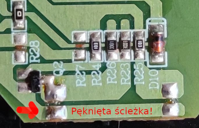

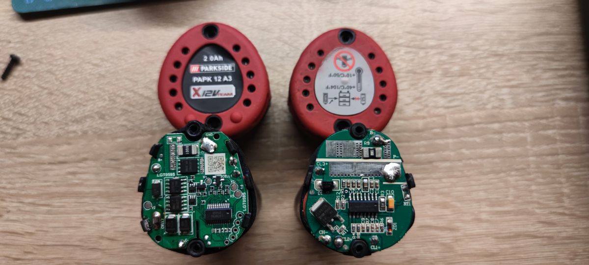

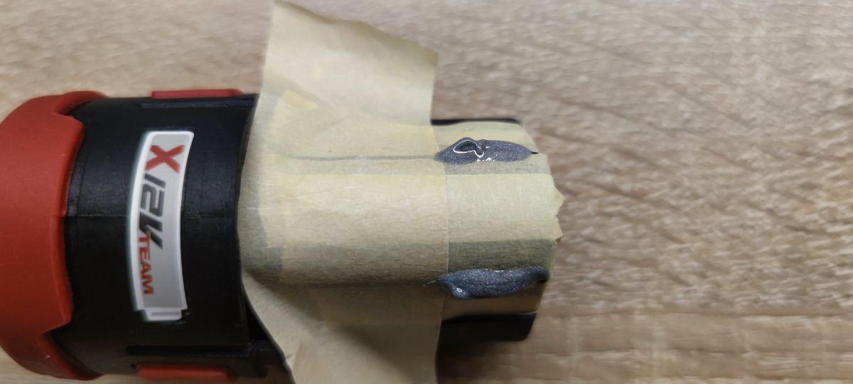

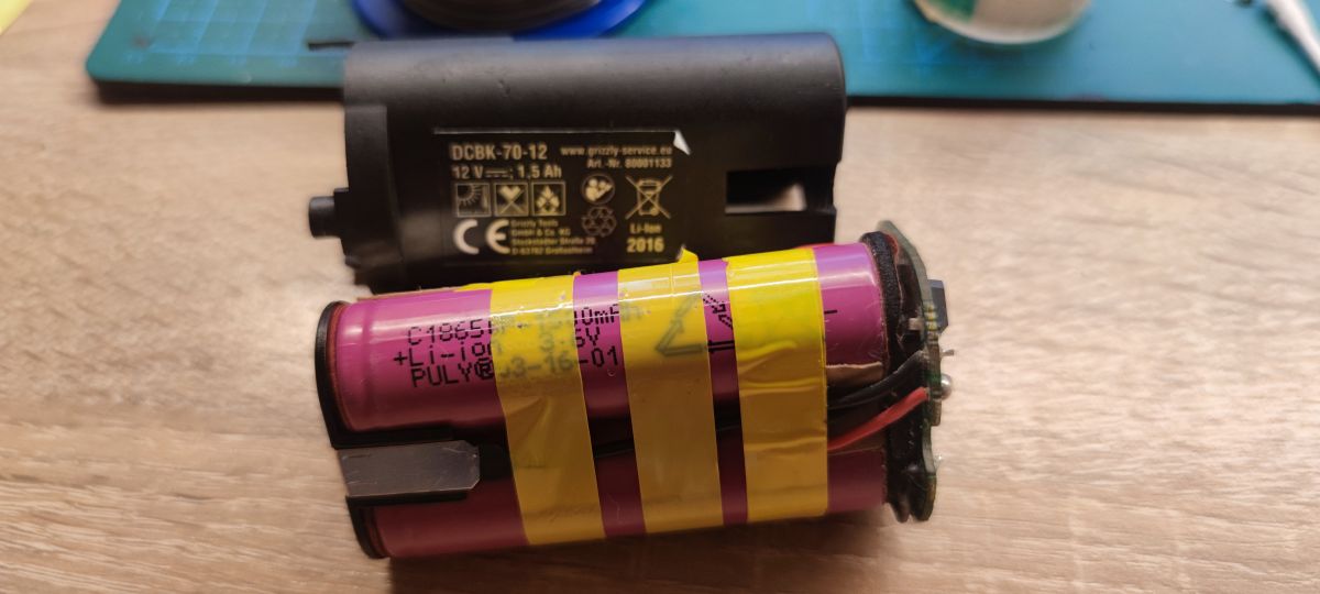

    #43 21420659
    Hetii
    Posts: 519
    Rate: 420
    Welcome.

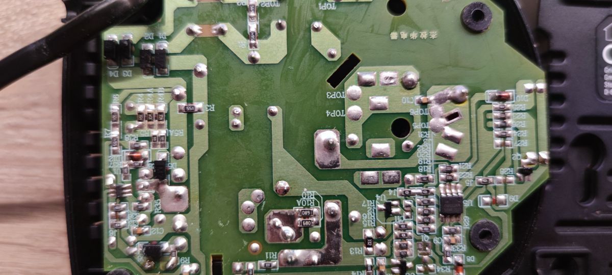

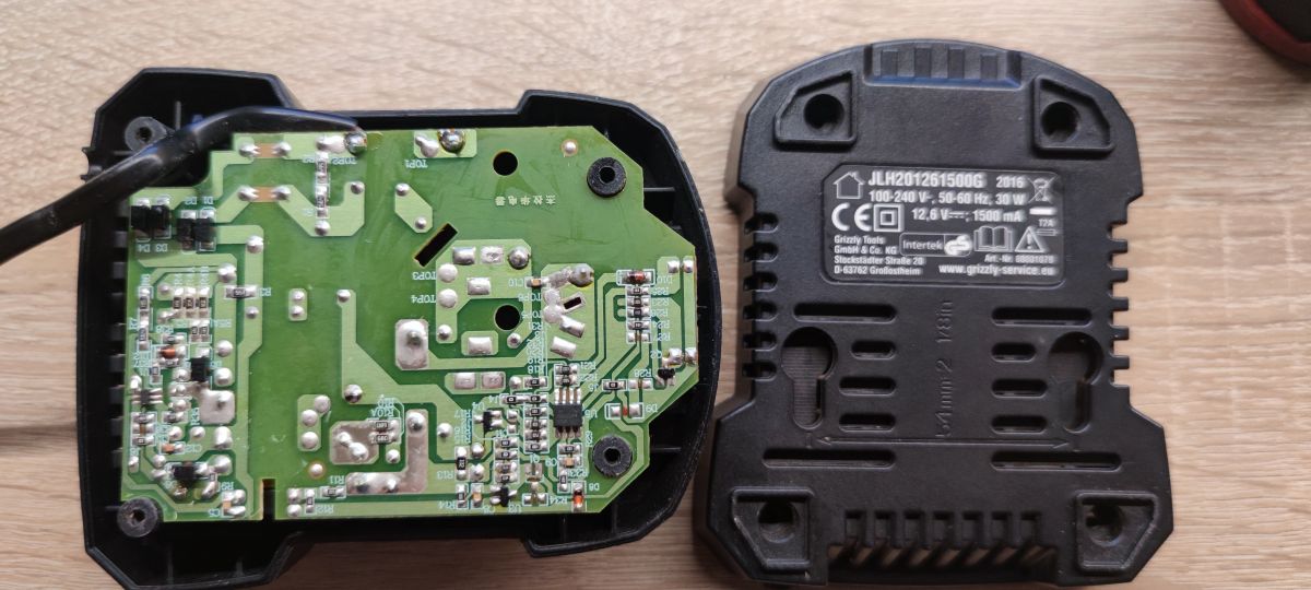

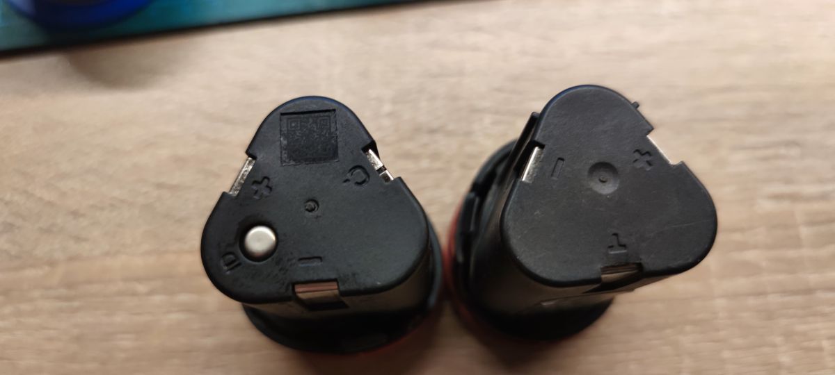

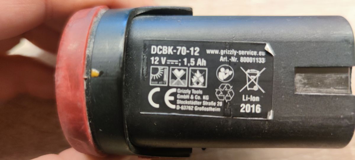

    In my case the screwdriver is marked PBSA 12 A1, the original battery is marked DCBK-70-12 12v 1.5Ah and the charger from this set is JLH201261500G.
    Charger:
    View of the interior of an open charger with visible electronic components. .
    Close-up of a charger circuit board with visible electronic components and traces. .
    Interior and casing of the JLH201261500G charger. .

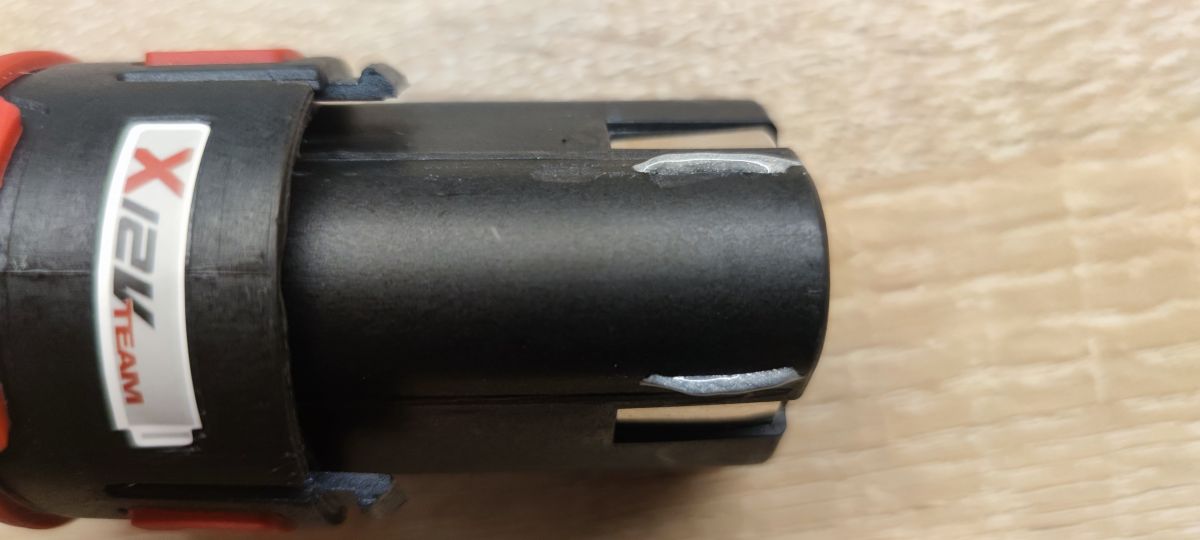

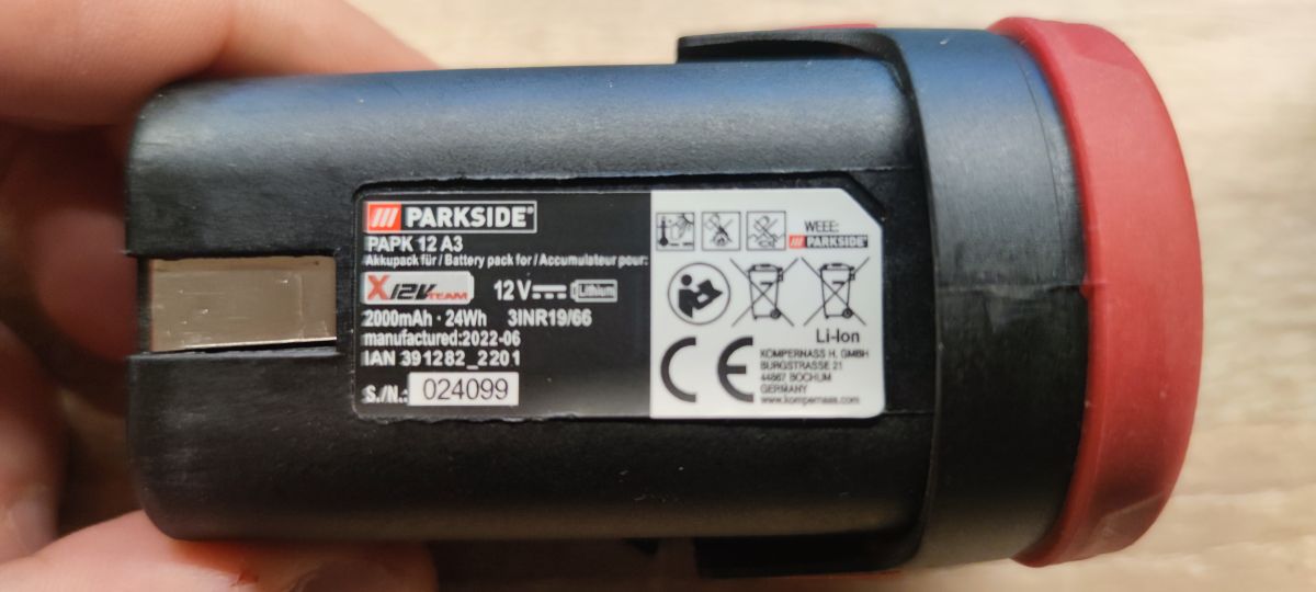

    Unfortunately I bought a battery in Lidl years later, but from the X12V team series with the designation PAPK 12 A3.
    This is how they both look:
    Two Parkside PAPK 12 A3 batteries with visible electronic boards. .
    Two batteries, one labeled DCBK-70-12, the other partially disassembled with yellow tape. .
    Two batteries viewed from above, with visible contacts and markings on their covers. .
    Close-up of DCBK-70-12 battery with 12V and 1.5Ah capacity, showing manufacturer's label. .
    Close-up of a Parkside PAPK 12 A3 battery with an informational label. .
    I have the feathers in the new acku already cut down and will eventually be glued with two-component glue new, in the place where the old one has them.
    However, the problem I have with the charger is that it gives 13.6v on its contacts, yet both LEDs give no indication. This problem started while the old battery was still in place, now that I look at it this voltage persists even after inserting the batteries, so I think the charger is charging, but I still need to check this carefully.
    As for the old battery, there is no voltage between the -/+ leads on the T contact and internally it goes via the diode to the n-mosfet.
    On the new A3 battery, on the other hand, there is almost the same voltage between "-" and "C-" as between "+" and "-", although "+" and "C-" are not internally connected, so there is additional electronics there.
    As for the ID field, in this video the guy shows that there is a 24k resistor connected to the T field, so presumably this is a way for the new charger to handle the old batteries (7m26s):
    That's it from my side for the moment, and I'm getting on with finding out why this charger of mine is not signalling charging.

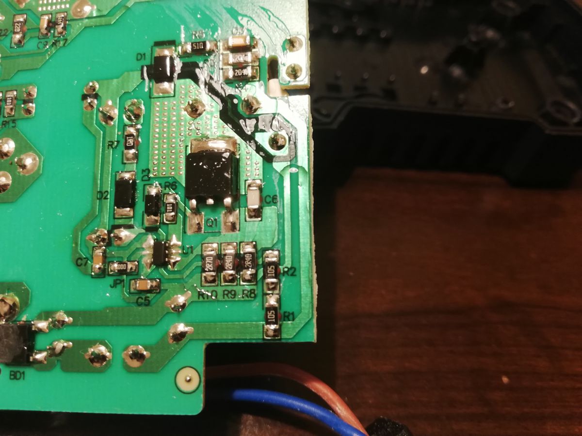

    Edit:
    Damage to the charger found, it turned out to be a broken path right next to the first green diode, which is shared by both diodes, so I think the set will last for many more years :) .
    Image of a circuit board with a highlighted broken trace. .

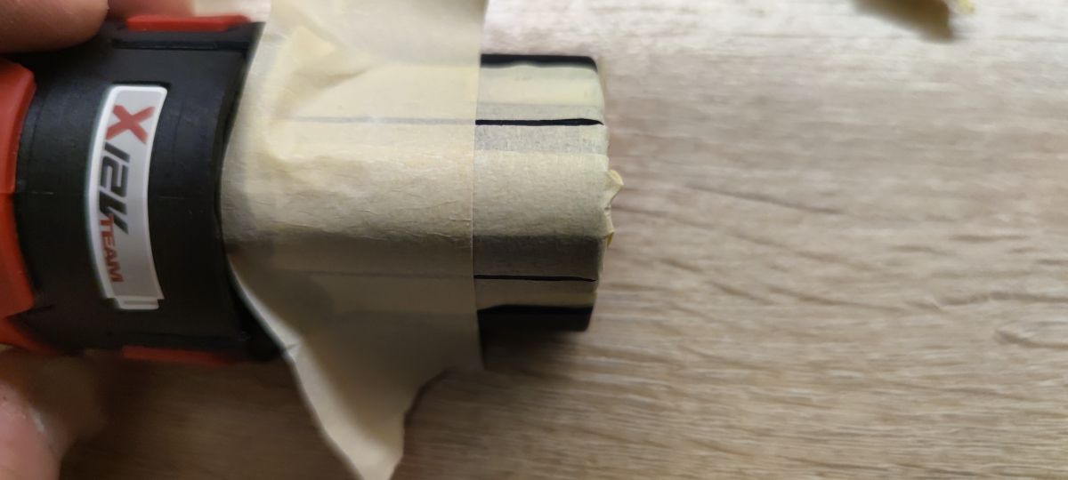

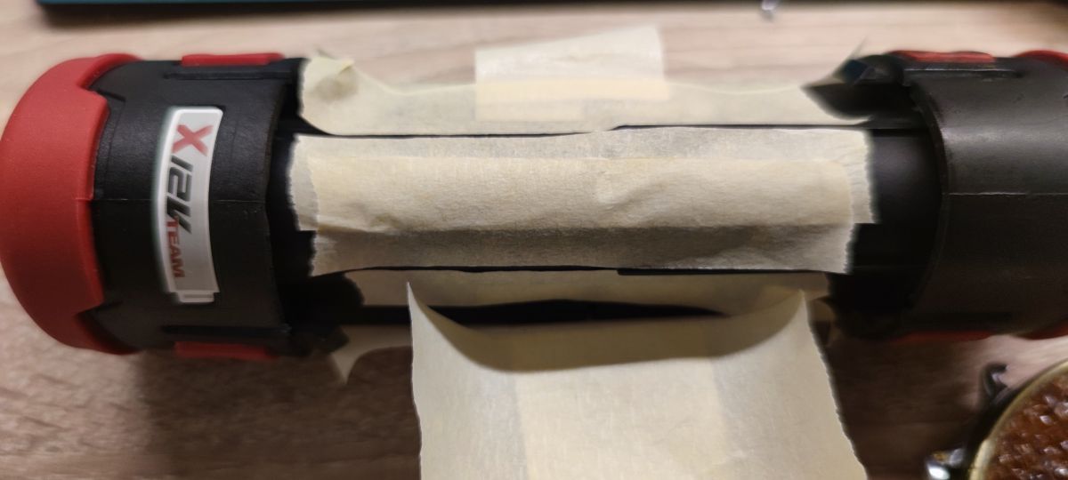

    Finally, paste in the new interlocks:
    New X12V team battery with masking tape applied. .
    View of an X12V team battery wrapped in masking tape. .
    X12V team battery with two-component adhesive applied to the contacts. .
    Close-up of a PAPK 12 A3 battery from the X12V team series with visible cut tabs. .

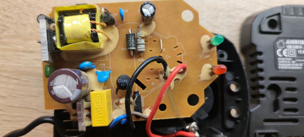

  • XL4015 step-down used as Li-ion charger
    #44 21427219
    kotbury
    Gantry automation specialist
    Posts: 9591
    Help: 2100
    Rate: 3630
    At my place, the charger for the oldest PABS12V mini screwdriver broke down (still pre xTeam, without any extra pins). I didn't have the strength to search for the cause (there are several operational amplifiers and a bunch of resistance ladders), it turned out that the switching power supply is working, so for literally a dozen or so zlotys I bought a step-down converter with current and voltage control and having a cut-off at the end of charging (it can serve successfully as a LiIon charger) https://elektroweb.pl/pl/przetwornice-step-do...88a-tzqAa3hBVybbPcwbICF2_71nkR2hoC420QAvD_BwE
    I cut off the original charging circuit, connected the aforementioned, pulled up the control LEDs and out of the way.
    Plus the confusion with the T, C- or ID fields falls away. T- seems to have been the battery temperature thermistor, ID- gives the charger the battery type (see video above). C- is probably a separate minus input just for charging but without the kit on the table I can't tell 100%.
