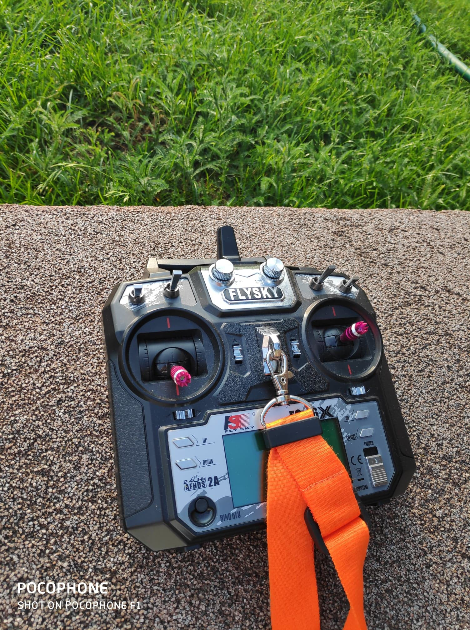

    - FlySky FS-i6X 10CH remote control (comes with receiver) 210zł

    You could save PLN50 on your camera by buying the FS-i6 model (without the X) + FS-iA6B receiver. This is a 6-channel set, but by uploading alternative software (which is trivial) you can easily extend the number of channels to 10-14.
    Apparatus: https://www.banggood.com/FlySky-FS-i6-2_4G-6C...-iA6B-Receiver-p-983537.html?cur_warehouse=CN
    Software: https://github.com/qba667/FlySkyI6

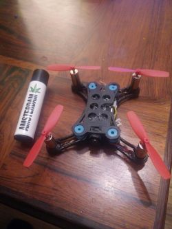

    After the first mole you will see for yourself that printing a frame is a bad idea.... Now frames are very cheap for 100p you can buy a Tbs source one/two for example. I used to print a TOBY X frame for zmr250 arms and on 2207 motors it lasted 2-3 packs and that without meeting the ground. For a micro it still somehow works but certainly not for a 5". Here is an example of a micro on 8025 motors
    A racing drone from a 3D printer :)
    As far as I can see you have the fc rigid which is not the best solution, maybe this frame is soft enough not to feel it.
    I would also work on mounting the antennas from the RX as you may be surprised by the failsafe.
    Here for comparison a similar specification in a normal frame.
