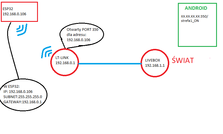

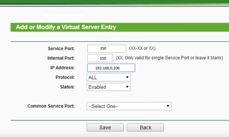

    As a second step, I would like to try to connect via an open port. The first thing I did was configure port forwarding on my TP-Link router:
    Controlling ESP32 from outside the network - how to configure access? .
    I then found out my IP address to the world via whatsmyip. Wanting to send a command via the browser, in the windows firewall settings I added a rule to allow port 350.
    I typed the command XXX.XX.XXX.X:350/zone1_ON, where normally 192.168.0.106/zone1_ON activates my ESP32 output and nothing. I set that IP address on the app on the phone (I have an editableIP address there) and nothing either.

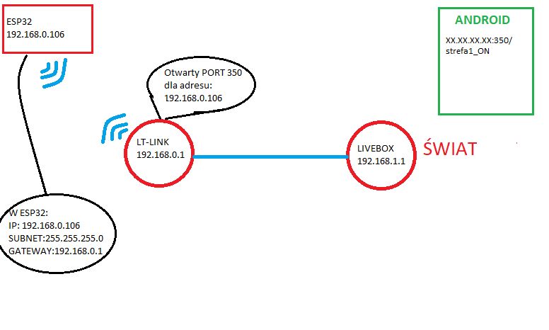

    It turned out to be something I had completely forgotten about. After typing the IP address from whatsmyip into the browser, it turned out that a page with the configuration of the second router popped up. The LIVEBOX router is connected to the world, my TPLINK router is connected to it via LAN:
    Now for this to work I suspect I would also have to open a port on the LIVEBOX, is that right? Or would it be enough to change the gateway on the ESP32 to 192.168.1.1?
    I also have a question about security, when I configure a PORT for a specific IP, do I make sure I'm only allowing something from the outside to that specific device IP address, or am I opening access to everything?
    How is my TP-LINK router seen by the LIVEBOX router? Is it also assigned an IP from the 192.168.1.XXX group?
    I'm very interested in testing this, but I'm a bit afraid of over-combining.
    I'm also still wondering if the ESP32 in the arduino program should not have a particular port configured.
