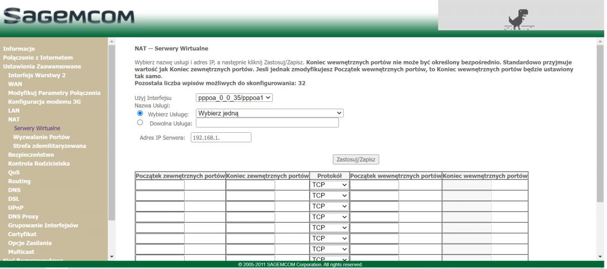

    omnixcrs
    Posts: 397
    Help: 8
    Rate: 60
    Ok, back to the substance of the problem, can you please write me how to simply redirect this port ? As I wrote above currently the server is on IP 192.168.1.21:9443.
    Added after 1 [hour] 13 [minutes]: .
    These are the settings I have in my router:
    Configuration of a local Blynk server for external access on Windows .
    Added after 2 [hours] 37 [minutes]:
    OK, I can see that the issue is difficult and complex. I must therefore seek paid help to organise this. However, before I start bothering someone I would like your confirmation that such a thing is at all possible, namely:

    #15 19881812
  • Port forwarding via WAN for external access
    #16 19881820
    kaczakat
    Posts: 1748
    Help: 317
    Rate: 231
    Every router has this slightly differently, so look for your settings in your router's forum. In my case it's not the NAT tab, it's generally for something else. In my case it's in the WAN section and it's called port forwarding. E.g. I have an FTP server on a device with IP .244 then on the router I enter port forwarding, set the IP of the local host e.g. 192.168.0.244 and its port 21, protocol TCP/UDP or OBA, port from WAN e.g. 5467 and now to log in to this FTP from another location I enter IPexternal:5467 in the program.

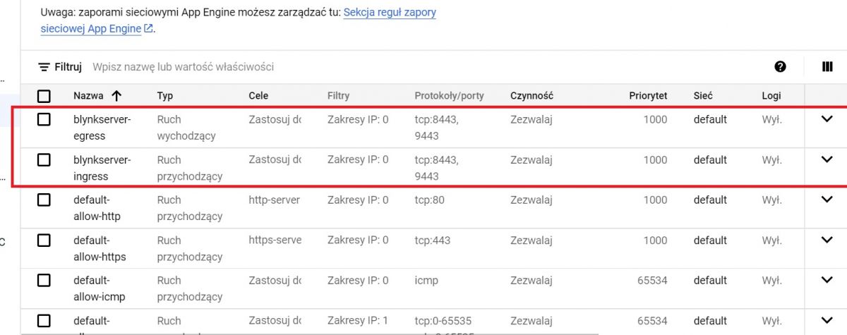

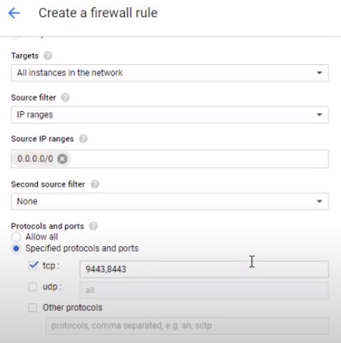

    omnixcrs
    Posts: 397
    Help: 8
    Rate: 60
    Gentlemen I have gone a little different way. I set up a Blynk server in a cloud from Google Cloud, obtained an external IP address and the server is running. I access it via the browser, log in to it without any problems via the Blynk app. Unfortunately, for a reason unknown to me, I cannot connect to a device, such as nodemcu or wemos.
    I log into the application via the server IP 34,125,xx,xxx and port 9443. I create a project, add the device, peak the token, upload the firmware on the NodeMcu and nothing ! I have used various, below listed, ways of zaspisu fuckji Blynk.begin and still offline. What could I be doing wrong?
    Blynk.begin(auth, ssid, pass, IPAddress(34,125,xx,xxx), 9443);
    Blynk.begin(auth, ssid, pass, IPAddress(34,125,xx,xxx), 8080);
    Blynk.begin(auth, ssid, pass, IPAddress(34,125,xx,xxx));

    omnixcrs
    Posts: 397
    Help: 8
    Rate: 60
    I have it rather done, take a peek:
    Admittedly I have ports 9443 and 8443 there....
    Updated Blynk ports: 8080 for hardware, 9443 for apps

    kaczakat
    Posts: 1748
    Help: 317
    Rate: 231
    I think I know what tutorial you were watching, yesterday I made myself this Google server based on this https://www.youtube.com/watch?v=YEZumoGXunk, but this video is out of date. The standard ports used to be 9443 for applications and 8443 for ESP (hardware), now it's 8080 as @khoam wrote. Swap that port and it will work, or force the server to run on port 8443, there is then a parameter to add at startup. I checked and it works OK, but I took the commands in the VM to download the java directly from Blink's GIT.
    Google's 3m free is a nice option, but for longer term there are slightly cheaper providers to be found here: http://lowendstock.com/ with IPs from $10/year, although prices are still rising.
