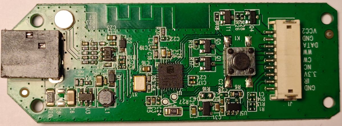

    It's control board is based on a LN882H and the LED strip has 40 WS2811 drivers each driving 6 RGB LEDs.

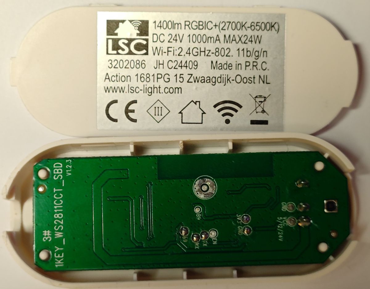

    The plastic housing can be opened very easily by just prying the back off with a flathead screwdriver or a shim.
    LED controller board with labeled pins and visible electronic components, including a button and connector.
    Back side of LED controller PCB with labeled pins and connection pads.
    LSC Smart LED controller board with opened plastic case showing internal circuit and model label.
    It's similar to the other RGB CW strip with the identical model nr. but based on the LN882H instead of the BK7312N found in the other strips.

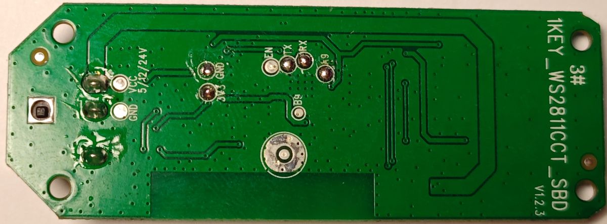

    I've tried to get that thing to run a year ago, but since the SPI pin is different ( GPIOA6/Pin 14 ) the WS2811/SM16703P driver didn't work.
    Since support has recently been added i decided to get to work.
    To enable power to the strip Pin 7 has to be pulled high, otherwise no LEDs will light up.
    The white LEDs are PWM controlled on pin 11 ( C ) and 12 ( W ).
    I haven't gotten around to figuring out IR yet, the button (which is connected to pin 25) and there is a microphone on the board, i guess for activation to music?

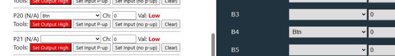

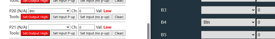

    nevoness wrote:
    I have tried to configure the P25 as BTN_SmartLED, but that ended up only continuously "pressing" the button
    If you're configuring from the perspective of the GPIO dr, B4 is P20, not P25

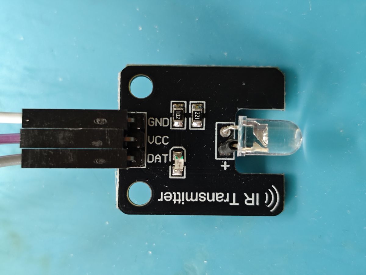

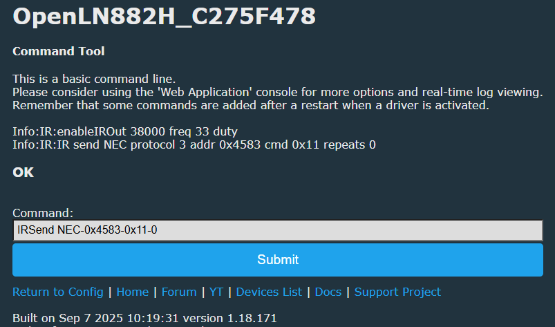

    IR for LN882H: https://github.com/openshwprojects/OpenBK7231T_App/pull/1783
    Recv works, send checked in logic analyzer, but not on real transmitter - looks fine, so should work.
    Info:IR:IR SAMSUNG 7 7 1
    Info:IR:IR SAMSUNG,32,0xE0E0E01F
    Debug:IR:IR fire event took 0ms
    Info:MAIN:Time 8, idle 0/s, free 77880, MQTT 0(0), bWifi 1, secondsWithNoPing -1, socks 0/0
    TEMP: adc raw:  839, temp_IC:   52 Total:132128; Free:67904;
    Info:MAIN:Time 9, idle 0/s, free 65288, MQTT 0(1), bWifi 1, secondsWithNoPing -1, socks 0/0
    Info:IR:Received Unknown IR
    Info:MAIN:Time 158, idle 0/s, free 7048, MQTT 0(10), bWifi 1, secondsWithNoPing 92, socks 0/0
    Info:IR:Received AC code:ELECTRA_AC
    TEMP: adc raw:  840, temp_IC:   52 Total:132128; Free:7048;
    Info:MAIN:Time 159, idle 0/s, free 7048, MQTT 0(10), bWifi 1, secondsWithNoPing 93, socks 0/0
