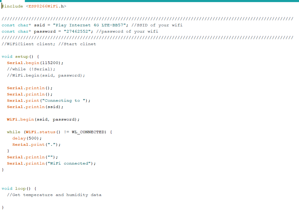

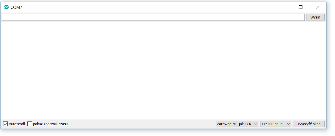

    Hello, I have recently owned a new Wemos D1 mini and I have the following problem: after connecting and uploading the program that is supposed to connect to the network, an empty serial monitor pops up. Previously there were two instances where the module connected to the network. I have tried uploading firmware but to no avail. Is the problem a badly written program code or rather the firmware? How do the AT commands relate to this? I would ask for step by step instructions.
    I would just like to add that a sample program like Blink works without any problem.

    Do you do a reset with the monitor window open and nothing appears? You can change the speed in the monitor to 74400 and try again with reset.

    I AM A RETARD ! actually just pressed reset on esp, the serial monitor shows "Wifi connected". Thanks for your help. And another question: if I connect the reset to the 5V or 3V3 pin through a resistor of e.g. 10k will the circuit perform the reset by itself?
