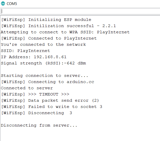

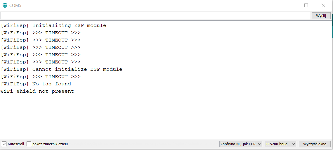

    Hi, I am trying to establish communication between the Wemos d1 mini and the Arduino Pro Mini via the WiFiesp.h library, to do this I downloaded an example use of the library and when trying to upload in the Arduino IDE an error is displayed. What is the problem? Can I use the analogue pins in SoftwareSerial? Should I connect the wemos directly to USB or maybe to the Arduino power supply?
    Program code:
    Code: C / C++
    • WiFiEsp.h Library Error with Wemos D1 Mini and Arduino Pro Mini Connection wifiesp.PNG (22.15 KB) You must be logged in to download this attachment.

    If you want to use the ESP8266 as a WIFI modem, you need to upload firmware that supports AT commands. There is one by default on the ESP01 model, not necessarily on others.

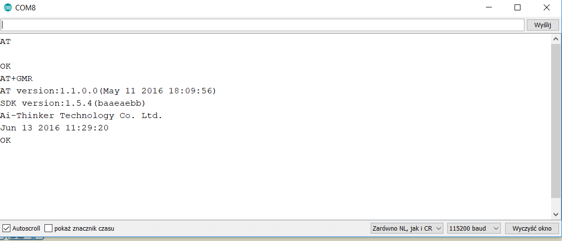

    khoam wrote:
    With AT firmware version 1.6.2 loaded, I connected from the serial terminal at 115200.
    I get something like this on the serial monitor (attachment). Is this OK and can I move on to communicating with the Arduino?

    That is, AT commands work, if you can connect via AT commands to a WIFI network with the Internet then you can upgrade online.

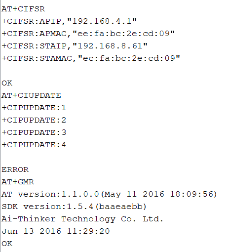

    That is, AT commands work, if you can connect via AT commands to a WIFI network with the Internet then you can do the upgrade online.
    How do you do this upgrade? I can't find anything on the internet.

    It threw an error
    • WiFiEsp.h Library Error with Wemos D1 Mini and Arduino Pro Mini Connection ciupdate.PNG (17.14 KB) You must be logged in to download this attachment.

    Read that thread, it doesn't always work, the server may be overloaded, maybe your modem is not connecting. Update online you can try a couple of times, of course once you're connected to the network all you need is the update part. Khoam seems to have thrown in there links to update manually too.

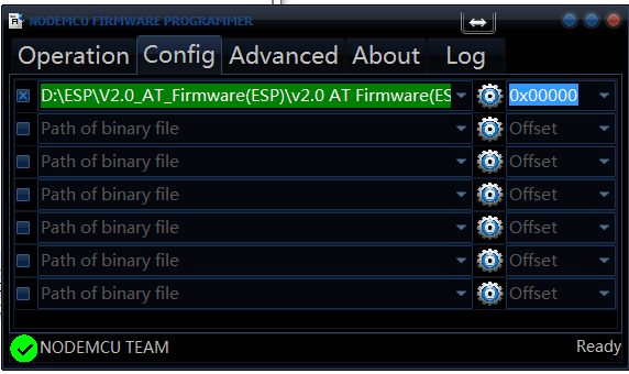

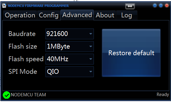

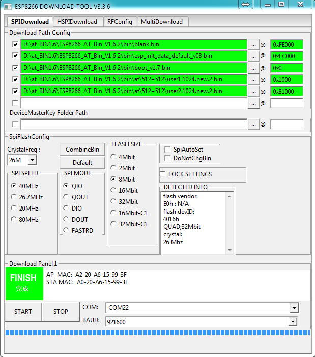

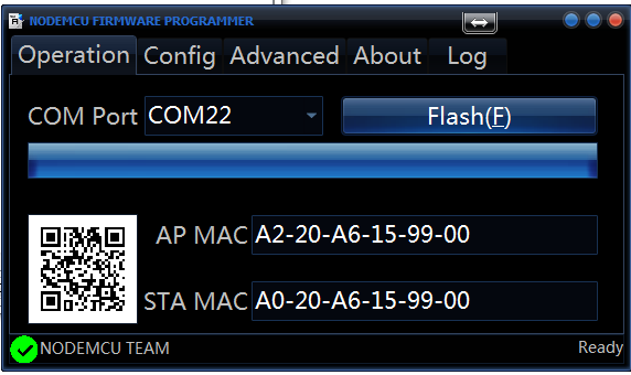

    If you managed to upload the custom version then you can upload the one from Espressif as well. Apparently the custom update doesn't actually work. I've uploaded it and even though it downloads something there, it's the same error.
    Nevertheless, in attachment #15 of that topic you have a flash uploader, very easy, all in one file and you upload at zero everything.
    I uploaded with these settings:
    WiFiEsp.h Library Error with Wemos D1 Mini and Arduino Pro Mini Connection .
    and then just press flash:
    Then you repeat the commands to update and you are done:
    AT+GMR
    AT version:1.6.2.0(Apr 13 2018 11:10:59)
    SDK version:2.2.1(6ab97e9)
    compile time:Jun  7 2018 19:34:26
    Bin version(Wroom 02):1.6.2
    OK
    Or the same after downloading version 1.6.2 from Espressif

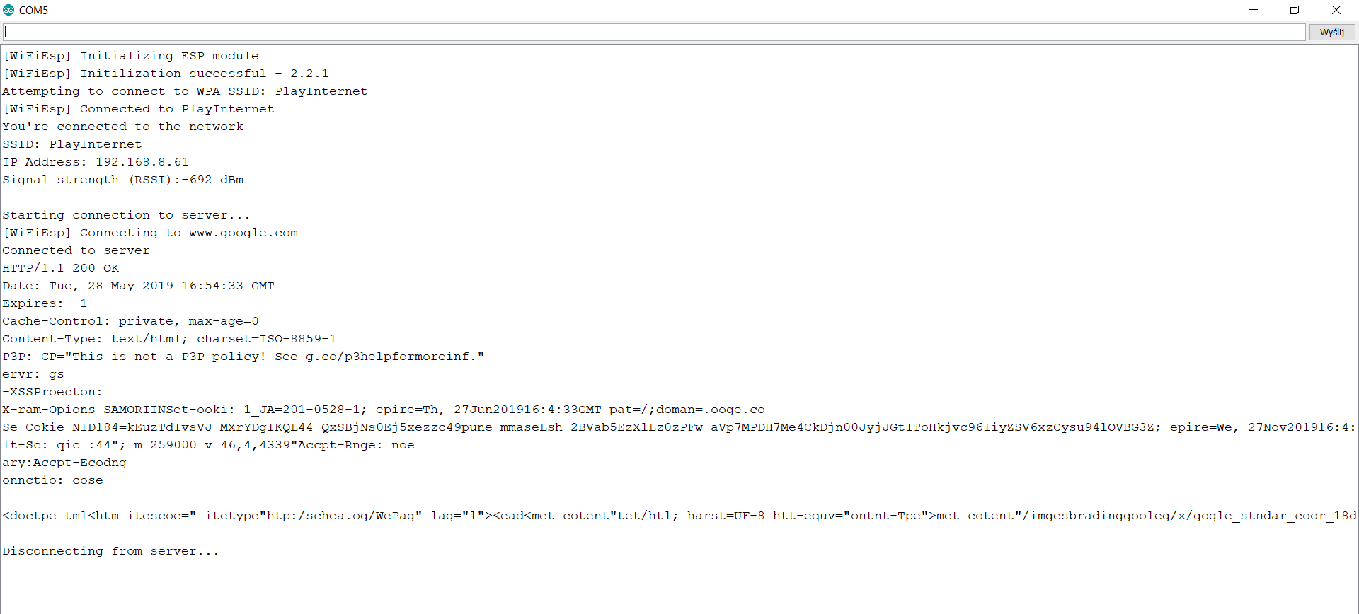

    I did as you instructed and now I have something like this on the serial monitor (attachment). I don't think this is correct no?
    • WiFiEsp.h Library Error with Wemos D1 Mini and Arduino Pro Mini Connection WIFI_ERROR.PNG (24.47 KB) You must be logged in to download this attachment.
  • #20 17985331
  • #21 17985424
    sebekk95
    Posts: 38
    khoam wrote:
    It looks pretty OK. It has connected to the local WiFi network (PlayInternet), and further down the line it can't connect to the arduino.cc server, but that's a problem a bit further down the line too - I don't know if it's possible to connect to that server on port 80 at the moment. This example is from 4 years ago. Try maybe with a connection to another server e.g. from this example:
    WiFiEsp.h Library Error with Wemos D1 Mini and Arduino Pro Mini Connection Such a thing is already good?
