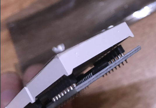

    Upon closer inspection, there is a MAX7219 in an SOIC package under the LED array:
    MAX7219 and PIC18F45K50 - support for the LED driver on the PIC microcontroller

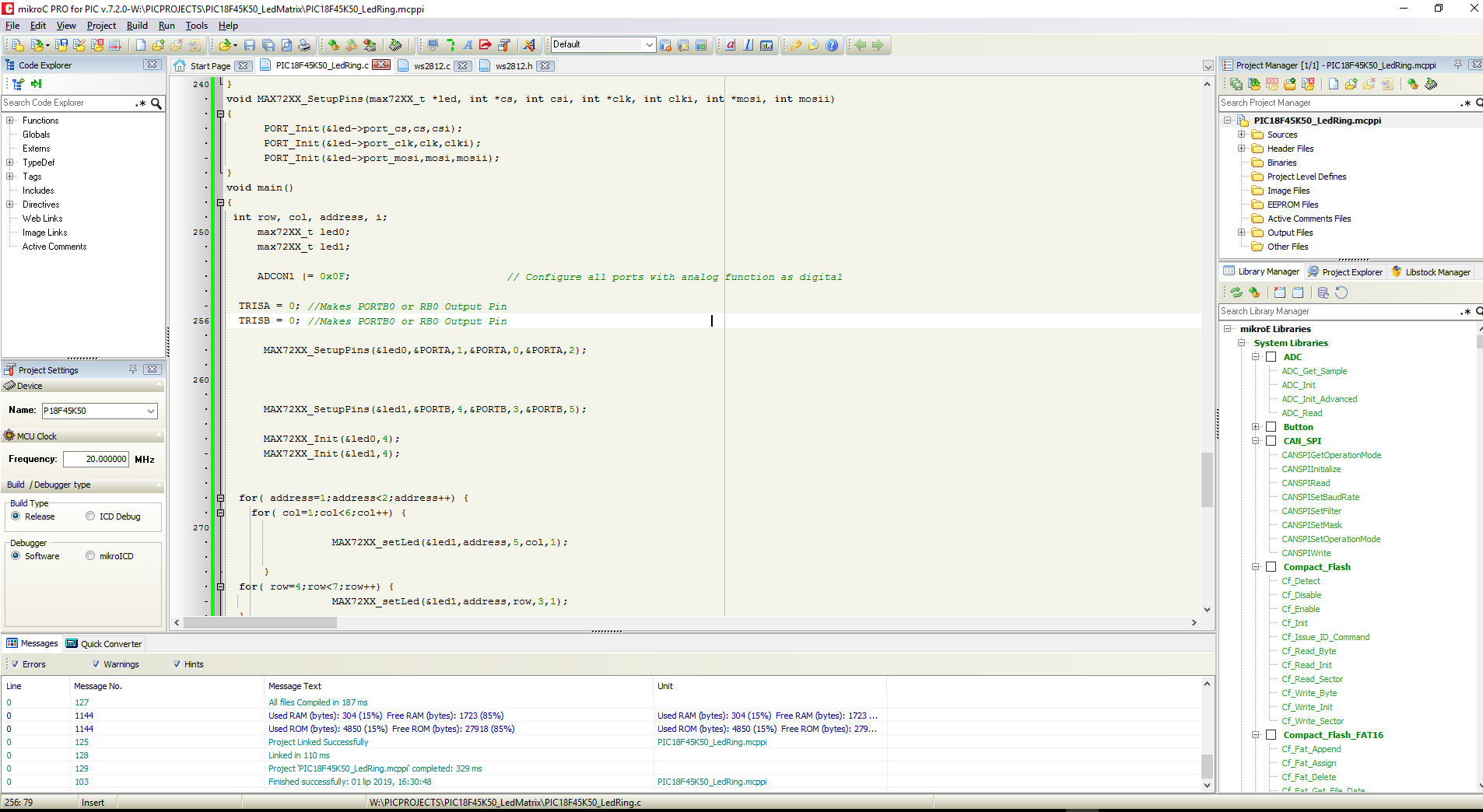

    I wrote the entire library in the MikroC PRO for PIC environment, but please don't be influenced by this - the code is quite universal and can be compiled in any C compiler. It does not use anything specific to a given environment or PIC.
    This is what it looks like when typing:

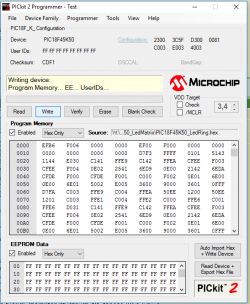

    For uploading the already compiled batch to the PIC, I used the PICKIT2 software for Windows:
