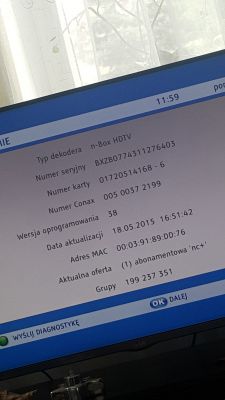

    For a long time, the decoder loses the signal every 12h, the message about the lack of signal is displayed and only tvp polonia works
    Nothing is visible inside that is damaged
    All the diodes checked are not broken through the capacitors. Soft original

    Decoder NC+ No Signal - Signal Loss Every 12h, Only TVP Polonia Works; Diodes & Capacitors Intact

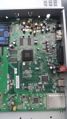

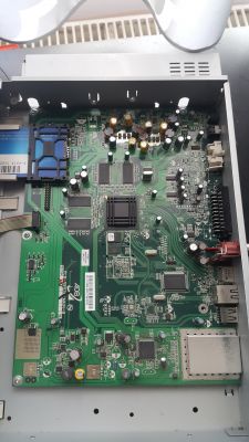

    All capacitors, as I said, are not swollen, and no diode is pierced, checked with a multimeter. It seems that nothing is burnt, today I also put a second power supply with the same parameters, and I will see what happens

    Bart.x wrote:
    All condensers, as I said, are not swollen
    Because they don't have to be !!! You have electronics in your profile and you don't know that they could just lose their capacity, dry ... ???
    You should measure the capacity or change them blindly - the cost is a few zlotys and not be tested "by eye".
    Anyway, if you would go to the trouble and review the linked topics, you would know that this is the most common cause of faults in these decoders.

    yes I looked through all the threads you posted, thank you.
    It is true that a damaged capacitor not only swells, but also may have lost its capacity due to old age, tomorrow I will replace individual elements and we will see.
