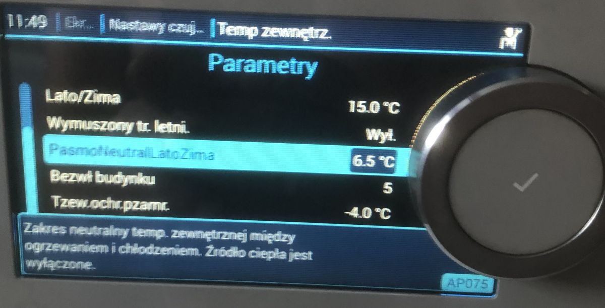

  • #31 20767893
    lukispajder
    Close-up of a device screen with HVAC temperature parameters.
    What does this parameter mean? Because I can`t find it anywhere.
  • #32 20767908
    DJTrueBeliever
    Posts: 222
    Help: 15
    Rate: 20
    Hysteresis in a combined heating-cooling system. The heating turns off when the daily average > AP073, but if there is still cooling in the system, it will not turn on until the daily average < AP073 + AP075.
    In a system with only heating, this parameter is irrelevant and differs only in the description of the icon in standby mode ("summer" vs. "neutral band").
  • #33 20767949
    lukispajder
    Thanks for replying so quickly. It was this neutral band that I was wondering about, so I set it to 0 and then summer or winter. But I checked what happens when I increase this parameter, and the stove did not respond to it.
    Thank you for the explanation 😁
