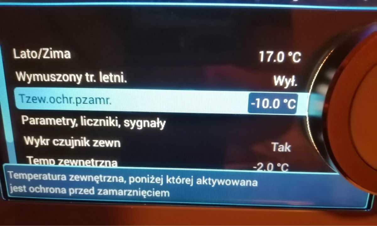

    1) An external temperature sensor is installed.
    The last settings icon on the stove determines heating below 15°C in winter
    My question is how to set the room temperature range to which the stove should heat? Is it regulated by radiator thermostats in each room?

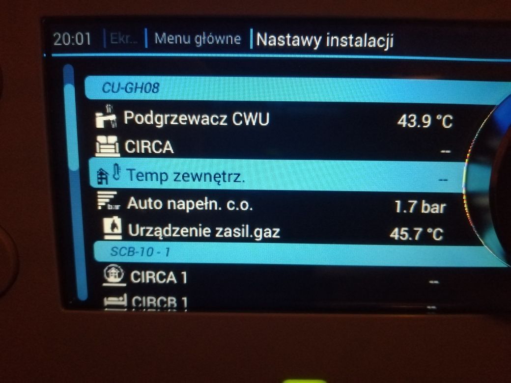

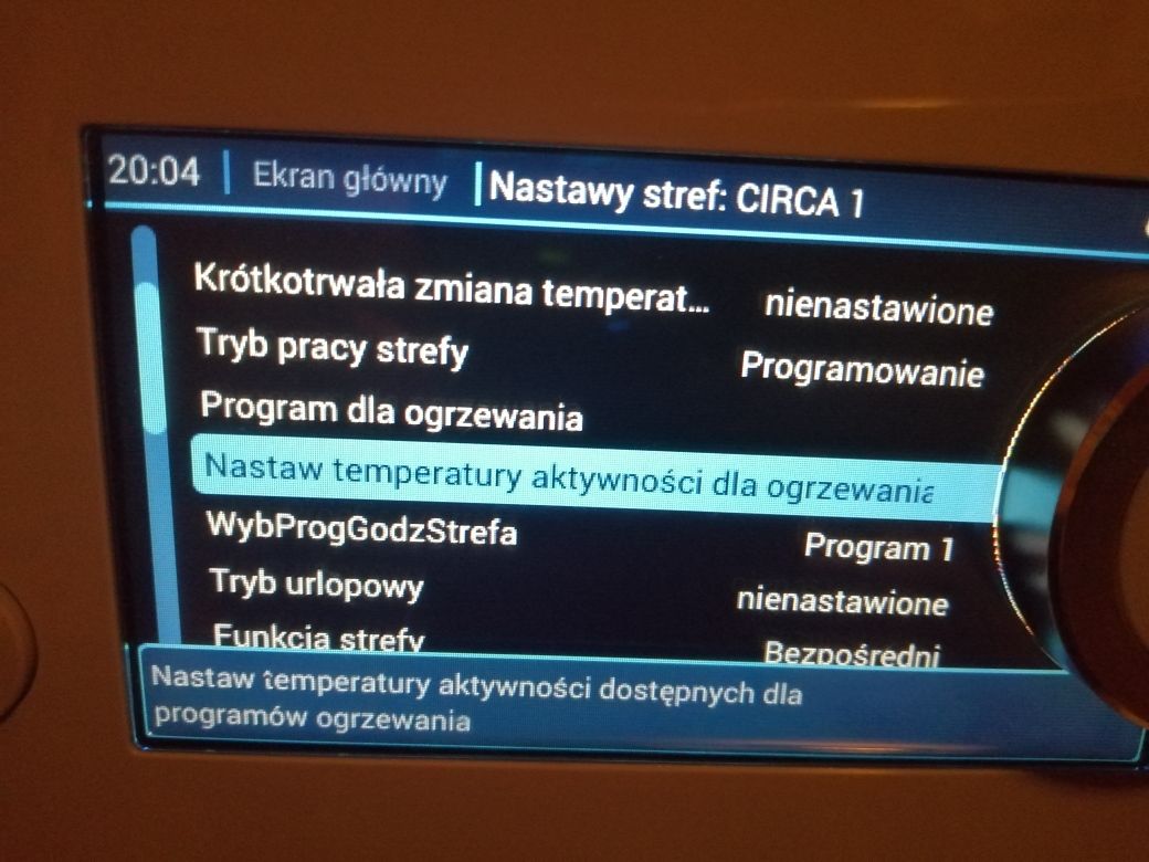

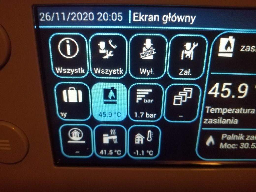

    Looking from above from the photo
    CIRCA on the tile, despite setting temperatures from 7 p.m. to 9 p.m. during the day, writes that the "frost protection" mode is set. Is this supposed to be the case at + temperatures outside the window?
    However, if the setting is the same but CIRCA1, the correct set program is displayed on the tile.
    I`m already crazy because I don`t want or have a division into zones 1 and 2
    Need to verify circuit setup and boiler registration

    How many heating circuits do you have, do you have a hydraulic coupling or 1 direct circuit, this boiler has a lot of configuration options, and it works with both open and on-off thermostats, some circuits just need to be turned off, if you have 1 direct circuit it can be turned on both in circ and circ a1 .
    Circ and you connect the thermostat to the front plate behind the display as well as the domestic hot water sensor if the tank goes directly from the boiler to. You connect Cirk A1 to the side plate, it can also be either direct or with your own pump through the clutch, you connect the thermostat to the jumper in the side plate, and Cirk A, as it is not used, can be made inactive. This boiler has such extensive automation that service technicians have problems with its configuration :P and it is difficult to explain without being near the boiler, and the installer apparently did not fully configure and explain it, you may need help from a good service center :) check whether the boiler has been registered at all.

    How many heating circuits do you have, whether you have a hydraulic coupling or 1 direct circuit, this boiler has a lot of configuration options....
    I have 1 heating circuit for the entire house. The stove also heats domestic hot water - this is OK.
    I have a thermostat on each radiator.
    The central heating or hot water supply is connected to the smaller board under the display, I know one thing for sure.
    From my tests, when I turn on CIRCA, after the configuration it seems that the stove does not see what I have set, because the information on the tile is: "freeze protection" and 6°C
    and when I turn on CIRCA1, I set it the same way as with CIRCA and the information on the tile is the given program.
    But I still don`t know if I`m doing it right, because, as you also noticed, the installer didn`t explain everything to me (set it up) :)

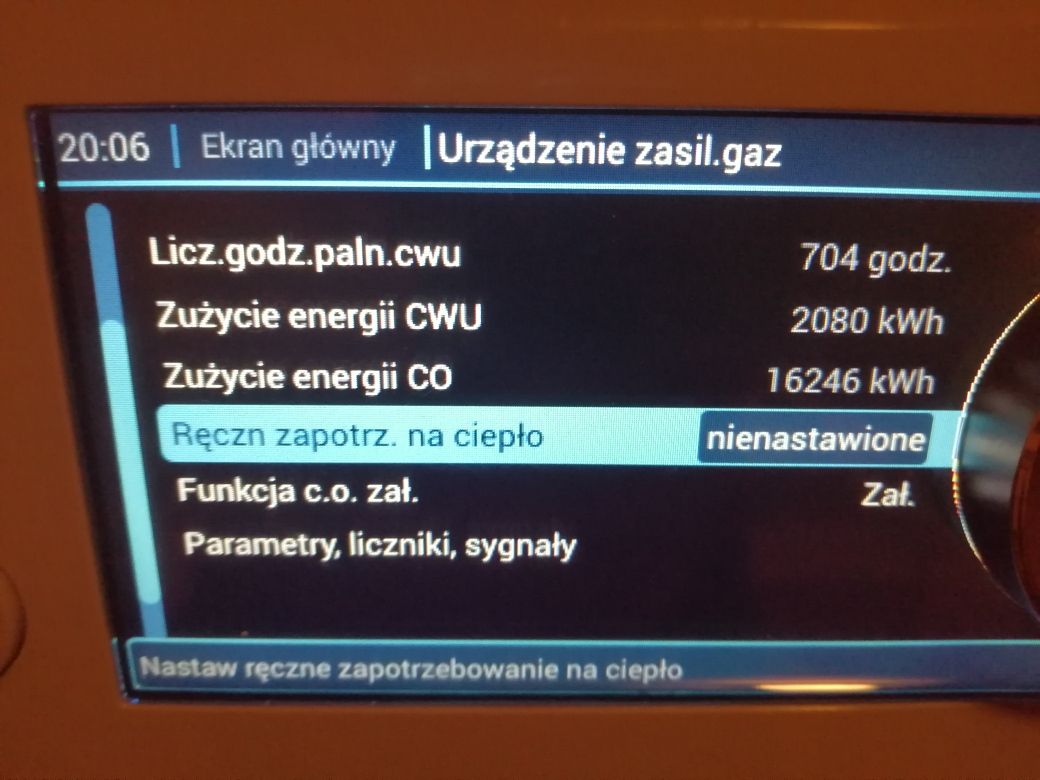

    I do not have any temperature controllers connected: neither weather nor room. Somehow, I managed to heat the spout according to the program. Now I would like to maintain a constant supply temperature throughout the winter (because I don`t have thermostats yet). I don`t understand how it works. The burner settings have the following parameters:
    AP002 Manual heat demand. I set it to value 1 = with setpoint
    AP026 Flow temperature for manual heat demand. Set 20 °C.
    Also in the zone settings.
    CP010 The leaving water setpoint for the zone, used when the zone is set to a fixed leaving water setpoint. Set 25 °C.
    CP320 Zone operating mode. Set 1 = Manual
    In which zone should I configure the temperature if there is no thermostat connected to any of them?
    The supply temperature in the signals is 13 °C and the stove is not burning yet.
    QUESTION:
    Which of these temperatures is taken into account by the furnace:
    from the burner AP026 or from the zone CP010 ?

    I`m not sure whether you actually mean manual setting of the heat demand, as you write in the first case, or maybe a set constant temperature value. In this case, the water heating should be about 40 degrees. (This is the water heating temperature, not the desired room temperature). This would probably be good in your case. Because you don`t have a weather sensor or room thermostat.
    As for zones, it depends on how the installer connected it to a small or large board. Theoretically, it`s not important (I think) as long as it`s in the settings section.
    Yes, it must be manual mode (in your case), not programming.
    and whether it works can be seen by the icon on the stove.
    IMPORTANT:
    1) if you set it as I wrote at the very beginning, the boiler heats water according to: set constant temperature. Please set e.g. to 40 degrees. in this case, what you set in the zone will not work.
    2) Please try like this. Turn off the constant desired temperature, and set the ZONE as you write and it should work according to the zone settings (but I don`t know how the stove will set the temperature because it does not have a sensor.

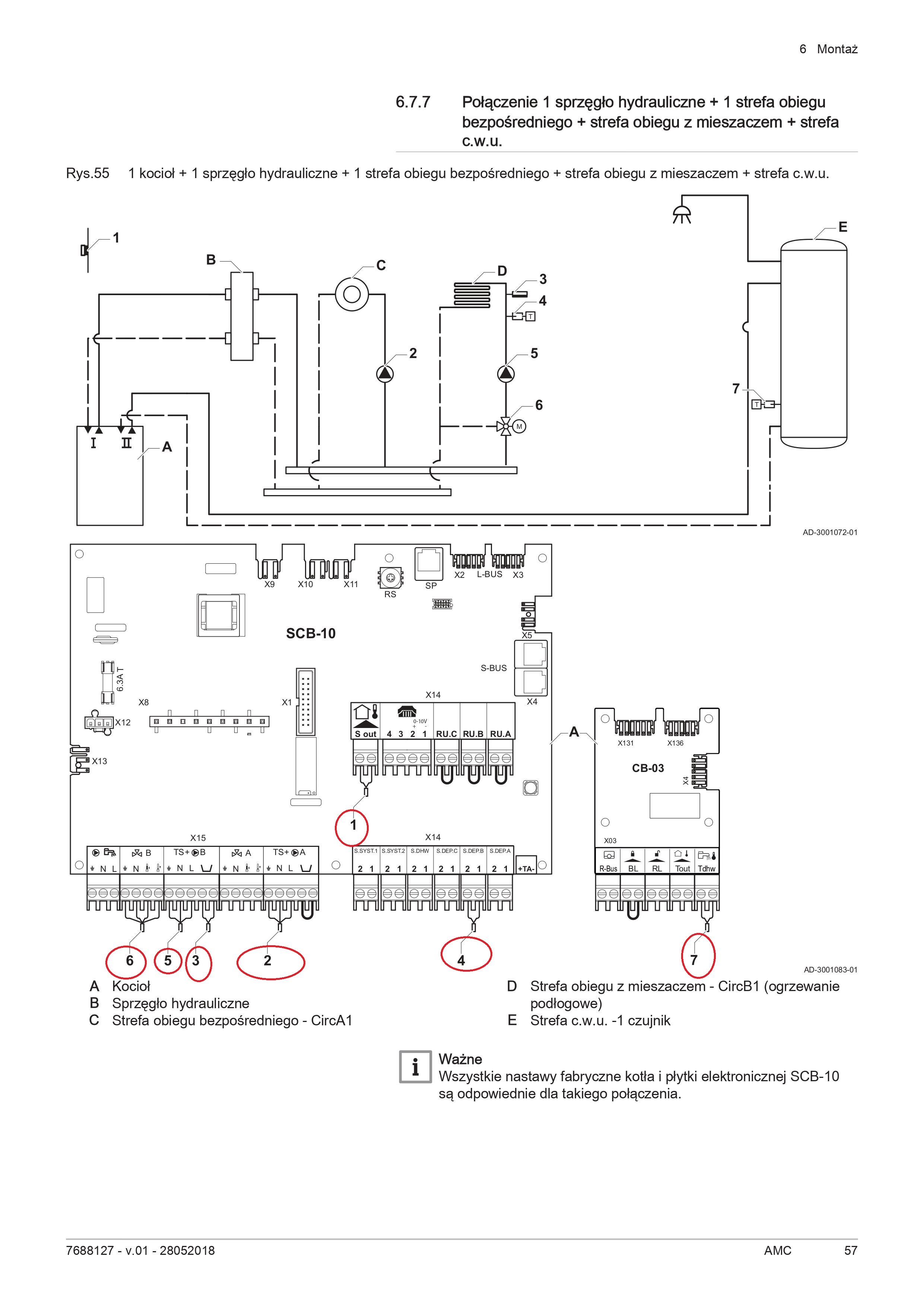

    This furnace can control one zone managed by the CU-GH08 board (zone thermostat connected to the CB-03 board): CIRCA
    and 3 zones connected to the SCB-10 board: CIRCA1 , CIRCB1 , CIRCC1 .
    Moreover, you can also set the temperature "outside all zones" - on the burner itself, as I wrote AP026 .
    How does this stove know which zone it is sending hot water to now and which temperature it should take into account...

    Setting the parameters of the Dietrich amc 25 condensing gas furnace
    I have it connected like this CU-GH08 DHW a to SCB-10-1 CIRCA1 CO zone with an external weather controller. In your case it`s probably the equivalent A.P., C.P .
    In the tile where the CIRCA1 zone is set, for me it is important:
    1) Mode: programming (set for a given day and time desired room temperature i Manual constant temperature requested every day and at any time.
    2) Temperature settings (applies to programming mode)
    That`s all I have set and it`s heating. What`s next... I mentioned earlier there are situations when it`s +15 degrees outside, the boiler heats the water barely, let`s say 30 degrees and my wife says it`s cold. This is how I do it:
    In this window
    I choose
    Manual heat demand
    I set it to 40 degrees.
    "Manual heat demand"? I thought this meant manually set water temperature...
    YES water temperature. It may be misleading to say that the value you gave was only 20 degrees.
    NOTE: When setting this, this will be the overarching setting. This means that the boiler will continuously heat water to 20 degrees.
    Please try to turn it off (not set) and set the temperature in the zone.
    and 3 zones connected to the SCB-10 board: CIRCA1, CIRCB1, CIRCC1.
    That`s right, he knows because the installer connected only one specific one.
    I`m not an expert, but it seems to me that you can connect it to other zones, e.g. underfloor heating or, say, a garage.
    It seems to me that in your case it will be the main one without the number.
    Moreover, you can also set the temperature "outside all zones" - on the burner itself, as I wrote AP026.
    either the zone and the set temperature (weather controller, thermostat, as I wrote above, or manual heat demand.

    I have another question for the more advanced ones :)
    de dietrich AMC 25
    The last tile - where the Summer/Winter/Frost protection seasonal mode is. Temp. external temperature below which frost protection is activated.
    What should the approximate value of this temperature be? and where you can set the parameters of this frost protection. ?
    The point is that when I have the programming mode set, let`s say 21 degrees at given hours, and with the Tzew setting. frost protection -3, then above this temperature (-3 outside), the winter mode is displayed and the boiler heats according to the set temperature. Let`s say it heats the water in the circulation at 45 degrees, and when the outside temperature drops below -3, the Tz mode is activated. protection against frost and the boiler circulates water at 62 degrees.
    According to what settings does the boiler determine the circulation temperature? I cannot find the Frost Protection mode settings.
    (please do not confuse it with setting the modes: programming, manual, frost protection and vacation).

    Thanks, Mr. Panderecki. I`m sorry it took a while, because I don`t have the Internet at the construction site yet to respond to the forum looking at the parameters of the furnace. The previous answers and my experiments led me to control the circulation temperature without weather and room thermostats installed. I don`t know if everything is clear from the above posts, because it may be a bit confusing, but if anyone has any questions about it, just ask and I will try to explain. You can set both a constant flow temperature on the burner CircA as well as on the plate SCB-10 : : CircA1 , CircB1 , CircC1 .
    The difference is that when set to SCB-10, we do not have control over the three-way valve built into the furnace, because then there is a separate output to control the external three-way valve on the SCB-10 board for each circuit. CircA1 , CircB1 , CircC1 .
    As for the freezing temperature, it seems to me that it only applies to the case when we do not have the heating on in winter.
    What is this temperature supposed to be? It depends on the insulation of the building. The question is at what outside temperature will the water in the house start to freeze.
    However, it seems to me that the furnace selects the circulation temperature according to the heating curve settings (with a weather (external) thermostat installed or according to the set constant supply temperature (with no external thermostat). Only in the anti-freeze protection mode, above this temperature limit, the furnace does not work at all he just watches.
