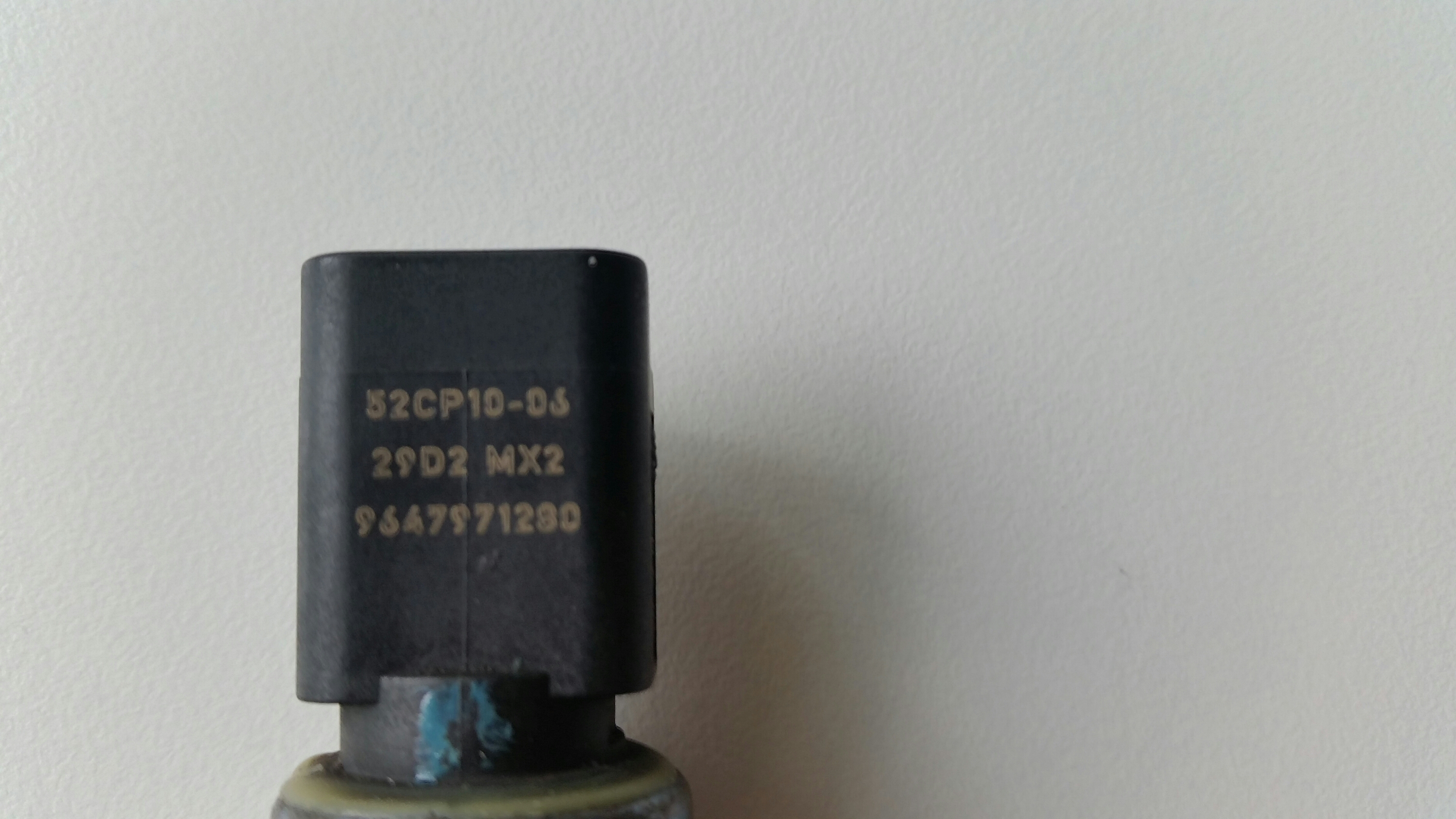

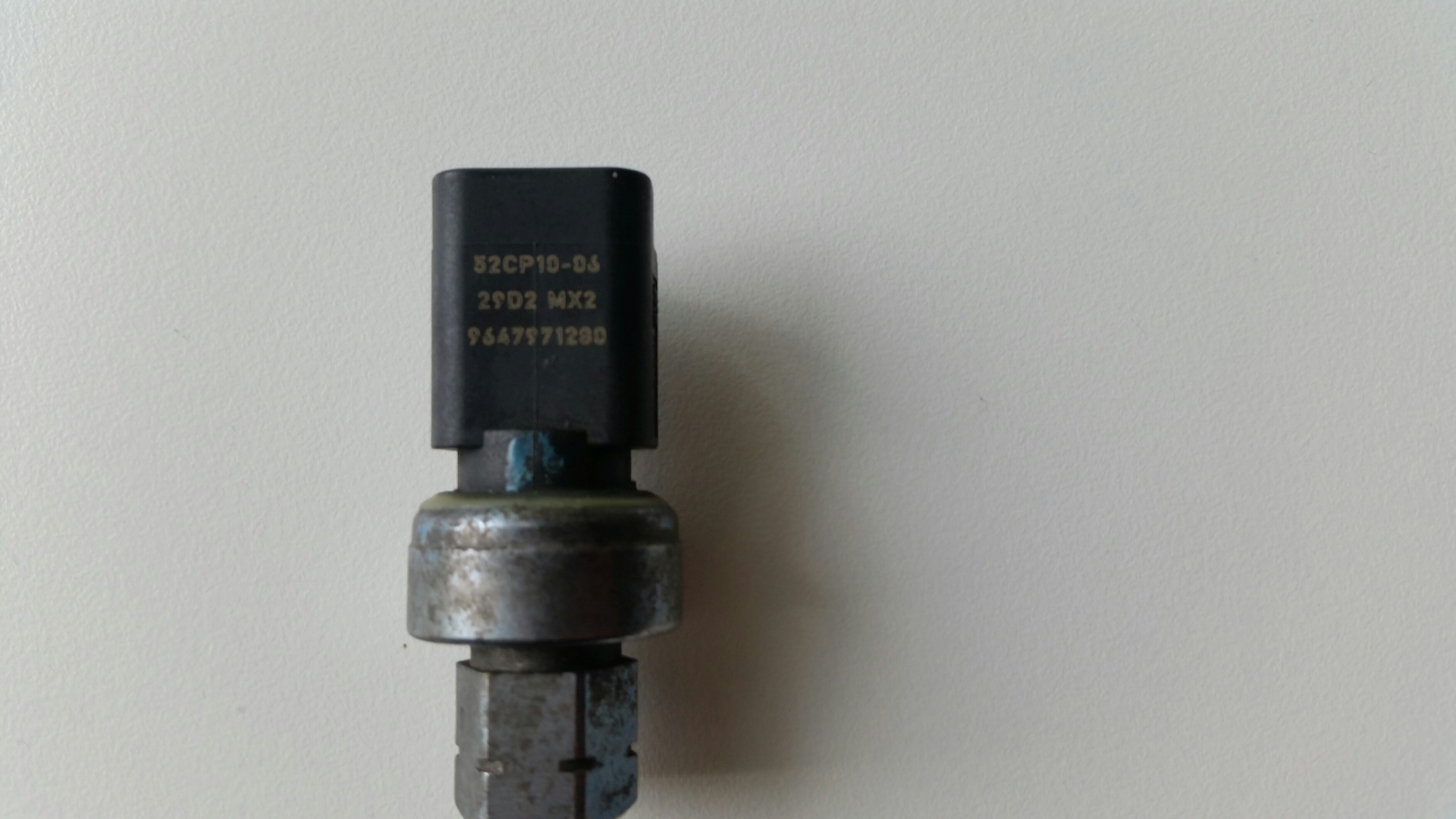

    Such a sensor will be ok? It has slightly different markings but the guy said it should fit ... hmm ... ?

    Oops ... that's not good
    Added after 9 [minutes]:
    So what not to risk, not to install it ???

    Nobody will tell you to take risks, you have to make up your own mind.

    Cool, what can the side effects be?

    I am afraid of the latter
