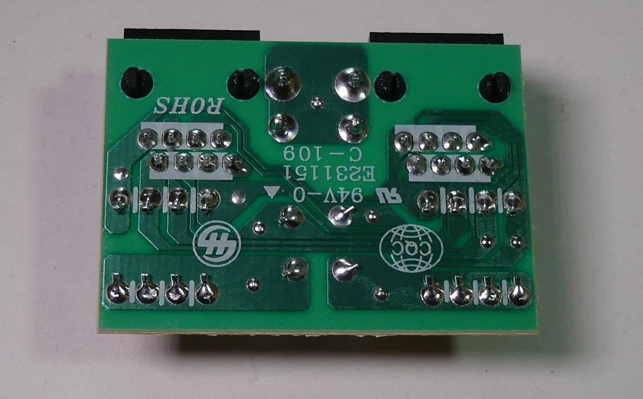

    On the back of the UPS there are two types of sockets, which will be especially useful in home applications, where, apart from IEC C-13 plugs, we often meet Schuko plugs. On the rear wall there is an input circuit fuse, a USB connector for communication with the software and a surge protector with an 8P8C (RJ45) connector. In the arrester, pins 1-6 are connected, pins 4-5 are swapped. The construction is based on diodes and varistors. It can be assumed that it is a protector dedicated to FastEthernet and telecommunication devices, e.g. ADSL modems.
    Comparison of online and offline UPS features - Green Cell Comparison of online and offline UPS features - Green Cell

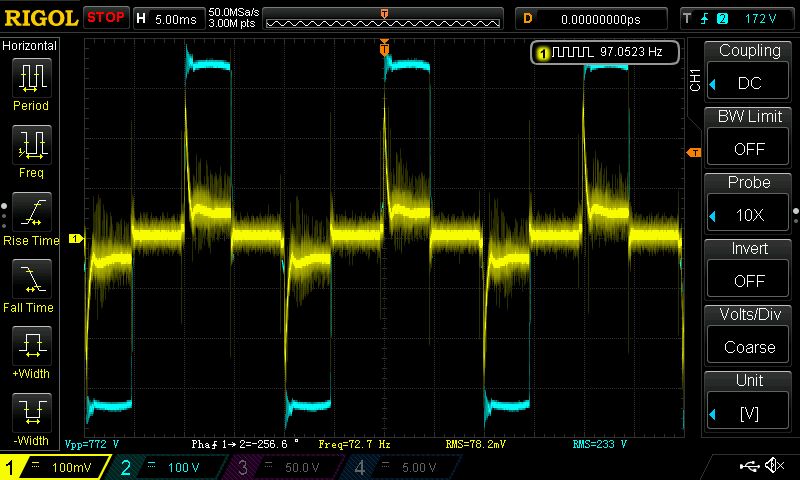

    Offline UPS practice tests
    A characteristic feature of offline UPSs is a short break in the power supply to the loads after a power outage. This is related to (usually) relay disconnection of the load from the network, activation of the emergency voltage source and switching the load to a new power source. Similarly, the return to mains voltage requires switching operations using relays. The switching time usually does not exceed 10ms.
    This is how the offline UPS is switched from mains to battery operation and back to mains:
    The short-term interruption in the power supply of the loads during switching to battery operation, typical for an offline UPS, should not affect the operation of the connected devices with lower power (due to the energy stored in the "excess capacities" of the power supply systems of these devices). For more powerful devices and critical loads, it is better to use an online UPS. In short: a low-power network switch, CCTV recorder, and even a small NAS or computer should not "notice" a power outage. However, for devices that are critical for the functioning of the company and consume more power, e.g. a disk array, a PoE switch that powers a dozen or even several dozen devices, it is better to use an online UPS. This is a very general rule with exceptions, but you have to start somewhere when choosing an uninterruptible power supply. Offline UPSs usually have a simpler design, lower power and also a lower price than online UPSs. Simple offline UPSs usually do not have the ability to connect external batteries to extend operation after a power outage.
    The offline UPS does not convert energy during mains operation (except in AVR mode), resulting in high efficiency. The power input is connected by a relay to the output, while the losses are mainly powering the UPS electronics and charging the battery. To compare the device with the UPS online, you can estimate its efficiency at different powers consumed by the loads. The increase in "efficiency" at higher powers will mainly result from the decreasing share of power for UPS's own needs in the total power drawn from the grid. A very "rough" estimate, but it will give us a comparison with online devices.

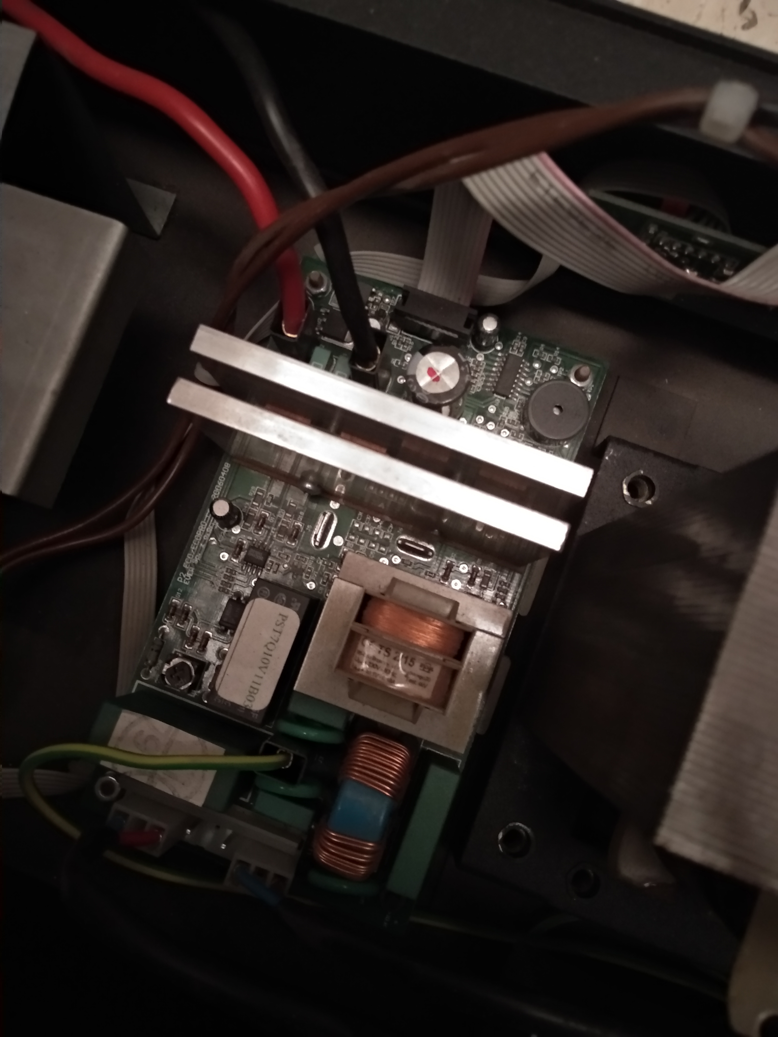

    Offline UPS with sine.
    A car battery from the smaller ones - 35Ah.
    Currently, probably ~ 20Ah.
    7Ah was installed at the factory.
    It's not that this battery is used because of some real need.
    The factory 7Ah battery (used like the entire UPS) just died and I did not want to buy a new one. And since it was being replaced in the car, I connected the old one.
    If the battery is slightly discharged (let's say it is a dozen or so minutes), at first the charging system gets tired of it (charging current 0.8-1A). But after an hour or two it goes into maintenance (lower voltage) and the problem is gone (the holding current is quite low).
    The problem is automatic charging. When the mains returns, it gives the battery somewhere with 14 volts, which causes the auxiliary transformer to heat up (it is responsible for charging, not the main transformer) to quickly charge the battery. Only that the capacity is much higher and it is switched to a lower voltage after a much longer time.
    Generally, this is not a very big problem. It is enough to add a separate charging assistance system if the battery is very large.
    Or make a simple modification to replace the internal auxiliary transformer with a larger one. There is usually a pair / a dozen VA and replace it with 40-60VA which will provide a current of a few A.
    For me, the dips are so short and rare that the charging system is doing fine. Most often it is the fuses being blown by the welder, which gives only a few minutes of break (until I go and turn the fuse back on).
    Sometimes it will only release a fuse from a given circuit, but sometimes it happens that the main one trips (you can see the selectivity not quite well selected by the last electrician, which he did the switchgear from scratch).
    In the case of central heating furnaces, where there are more frequent dips, additional charging systems supporting such UPSs are often visible.

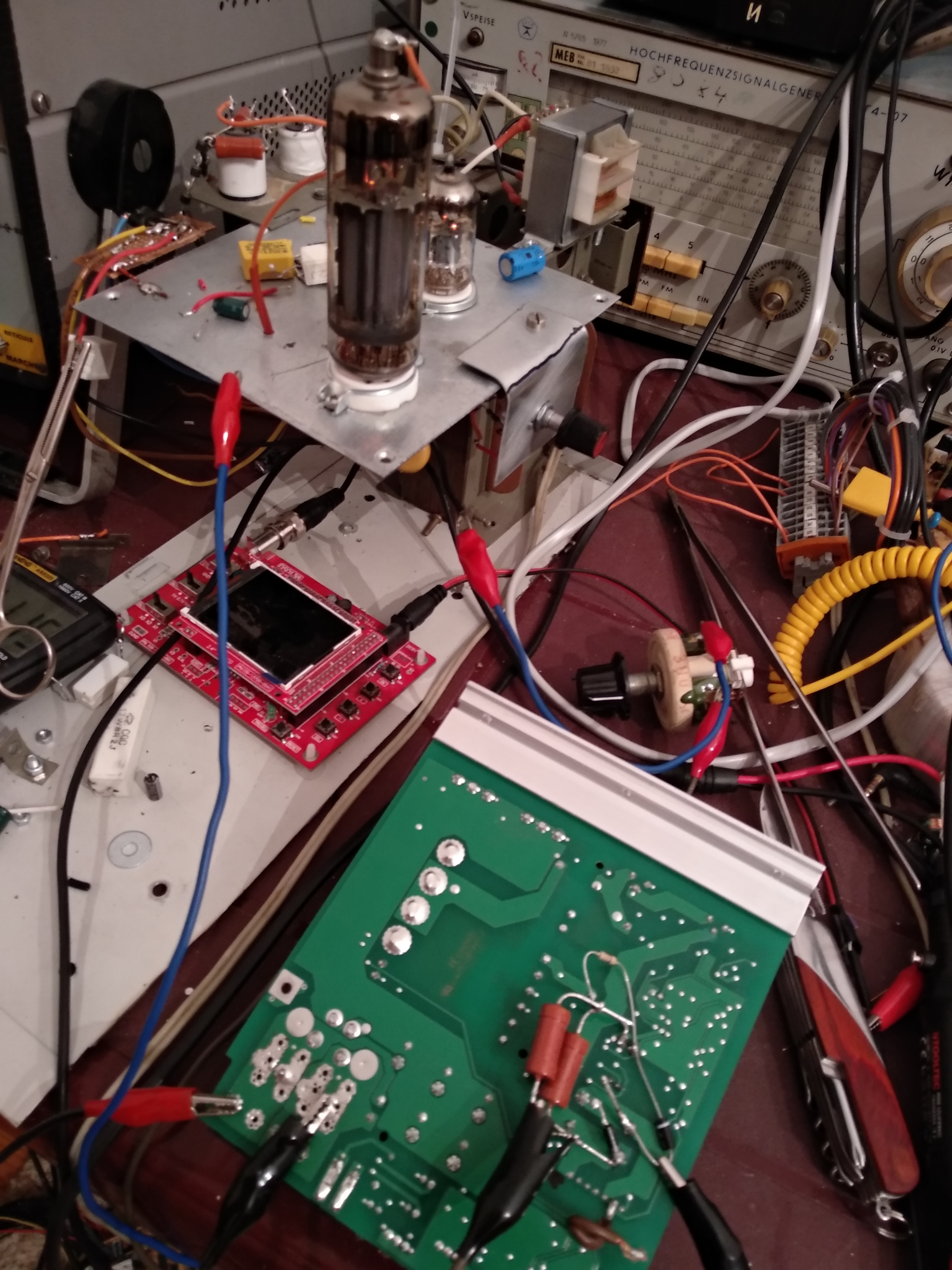

    Here you can see how it is structured (8:40).
    It is true that my UPS has a sine wave, but the UPS in the array NAS has a passive PFC. Year of production 2007 and still in good condition.
    Here, for example, I start the power supply (not just anything, a resonant converter (ZCS) push-pull) from DC voltage (regulation from about 150V to 450V).
    The factory has APFC on a separate PCB.
    The main problem was basically that the APFC also included a voltage source to start the power supply (initial control power supply).
    Beautifully replaced with two MŁT resistors passing some current from the main capacitor to the auxiliary power supply (after start-up it powers itself from a separate winding).
    By analyzing the operation of the power supply, it is possible to determine what modifications should be made to run it properly without the APFC circuit.

    Here are the photos of the 1kW UPS.
    There are four transistors between the two heat sinks, which means a full bridge.
    Comparison of online and offline UPS features - Green Cell Comparison of online and offline UPS features - Green Cell Comparison of online and offline UPS features - Green Cell

    @ pawelr98 Powerful and domestically produced output transformer. In the tested offline UPS, the transformer core elements are connected by a weld / weld. In this Indel, I assume that no such solution has been used? In this topic: https://www.elektroda.pl/rtvforum/topic3606304.html, there was a discussion about the impact on the transformer parameters of such a method of connecting sheets by welding / welding in a transformer.
    @ Kraniec_Internetów at small values of current there is a kind of APFC activation threshold.
    I have the results of experiments with the observation of the input current of the SMPS from APFC.
    Trace of yellow current shape, trace of blue voltage shape.
    As you can see, it's not bad, sometimes there are current pins, but it doesn't look dangerous:
    I managed to capture the phenomenon that you are probably writing about and here the current peaks look worse,
    this was accompanied by a slight humming of the UPS transformer, I held the device in this state for a few minutes and the operation seemed stable:
