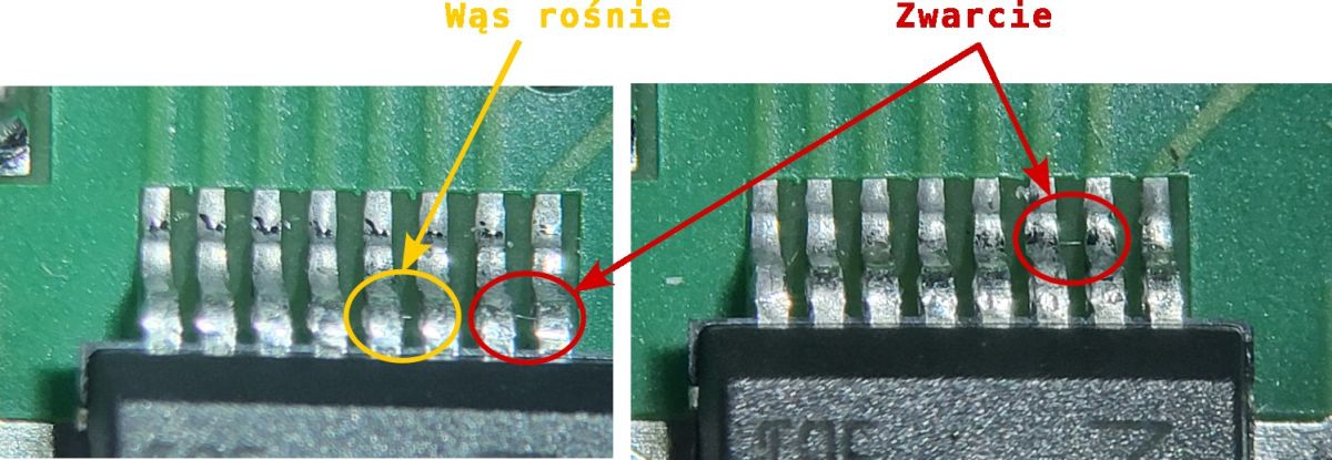

  • I would like to share an interesting observation after PCB assembly.
    I was testing a device today whose PCB assembly of components I had commissioned 8 months ago. Lead assembly. The device failed the test due to unusual malfunctions. My initial thought was a faulty PCB, probably a micro short circuit. One or more. A former PCB supplier had incidentally made this type of error, despite a commissioned electrical test. I tried to find shorted tracks starting with the input circuits. To no avail. I started looking at the board under a microscope and eventually found the cause to be tin whiskers. The whiskers had grown on the input leads of the semiconductor actuators. You can read more about the subject of tin whiskers in Monika Jaworowska's article What is the danger of tin whiskers and how to avoid them?
    The problem involved two ICs in housings with 0.5mm raster. The distance between the leads is therefore 0.2mm by catalogue. I am posting the pictures. Forgive the quality, but I only have a standard stereo optical microscope and had to take the photo through an eyepiece.
    Close-up of IC leads showing tin whiskers and a short circuit on a green PCB
    On the first element you can see a whisker that was already making a short circuit and another growing. The second element also had a whisker causing a short circuit. I estimate the width of the whisker (based on the photo) to be around 30-40µm.
    After re-soldering the leads, the problem disappeared and the device works properly. Interestingly, on the first component, where 1.5 whiskers can be seen, they grew on the top of the leads, the whisker on the second component grew close to the PCB.
    This is the first time I have encountered this type of fault in my devices. I recalled seeing a piece of clean tin. It contained a lot of strange hair-like structures on the outside.
    I should point out in advance that I am approaching the subject from the practical side. What puzzles me is the cause of this type of structure and how to deal with it. My guess:
    1. Excess solder paste applied to the PCB.
    2. The paste was not mixed well enough before being applied to the PCB (?).
    3. Residue of unleaded paste in the wrong ratio was left on the paste printer. Remnants of assembly of other boards (?).
    4. Mechanical stress (?).
    Points 2-4 I cannot verify, so they remain in the realm of conjecture. On the other hand, point 1 is insufficient for the problems described above.
    I would like to flag up the problem and encourage Colleagues to discuss.

    Diagnostics in practice (your situation: 0.5 mm, 8 months of storage)
    - The growth spot "on top" of the leg above the weld meniscus is classic for components with pure Sn on the pins: the solder has dissolved the Sn only locally, and above that the Sn remains with the dyes/tension.
    - A whisker diameter of 30-40 µm is quite large for a single whisker (typically 0.5-10 µm). You may have seen:
    - "bundle" (several whiskers fused together),
    - a crystalline spire/nodule from local overheating and recrystallisation,
    - or a solder bridge after rework. An SEM would give some identification, but the image and symptoms match the whiskers.

    - Mechanical removal + soldering of the feet will usually restore operation - as you have done.
    - If the device goes into a sensitive environment: consider spot varnishing/conformal to the fine-pitch area or replacing the chip with a version with a different finish (NiPdAu/SnPb).
    - In a production run: qualify an alternative PN with a different lead finish or have retinning (HSD) done by the supplier.

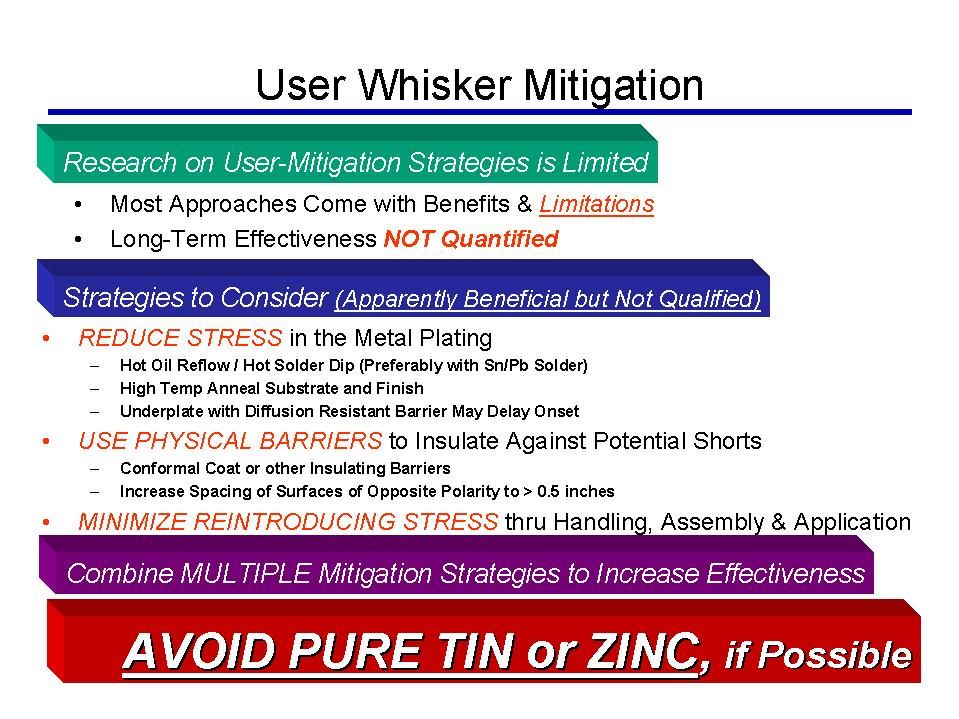

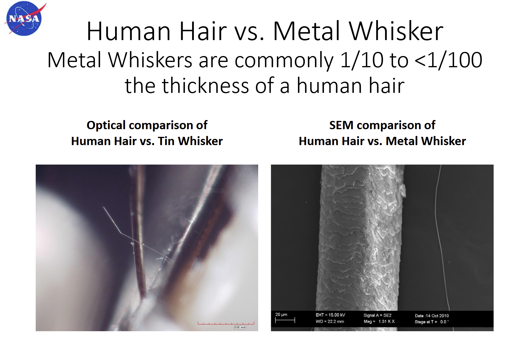

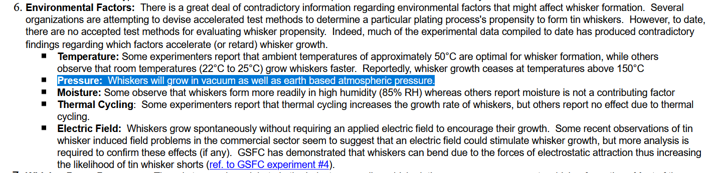

    Tin whiskers are a profound topic. NASA has a whole page dedicated to this very phenomenon: https://nepp.nasa.gov/whisker/
    As you can easily guess, in space missions, where equipment is expected to operate reliably and without overhaul for many years, this is a very serious problem.
    What surprised me is that there is still no clear explanation of exactly what the mechanism of tin whisker growth is. The FAQ on the NASA website above states:
    The mechanisms by which tin whiskers grow have been studied for many years. A single accepted explanation of the mechanisms has NOT been established. Some theories suggest that tin whiskers may grow in response to a mechanism of stress relief (especially "compressive" stress) within the tin plating. Other theories contend that growth may be attributable to recrystallisation and abnormal grain growth processes affecting the tin grain structure which may or may not be affected by residual stress in the tin plated film.
    However, one factor (besides the lead-free binder issue, of course) that they write about as having a significant impact is the stresses of the
    Presentation slide listing tin whisker mitigation strategies and key warnings.
    The site contains a lot of material (and cool pictures), maybe as you look through what is available there you will come up with some hypotheses about your case.

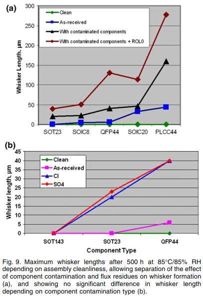

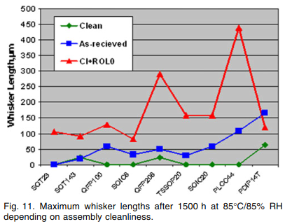

    I would suspect two options:
    1/ maybe the lead binder was not lead? Is it possible that it was an error on the part of the tile manufacturer? Since you wrote that they didn't do an electrical test, maybe the binder wasn't as specified?
    2/ Maybe the whiskers grew not from the binder, but from the lead coating of the IC (I can't see it well in the photo)? Was the coating lead-free or lead?

    Optical and SEM comparison of human hair and tin whisker thickness
    (Source: https://nepp.nasa.gov/whisker/reference/tech_...-Panashchenko-Tin-Whiskers-SnInAg-solder.pdf)
    viayner wrote:
    These types of long crystals are usually formed under conditions close to the melting point or precipitated from solutions.
    If this were the case, whiskers would not form long after the device was manufactured and this is exactly the case - whiskers grow over time.

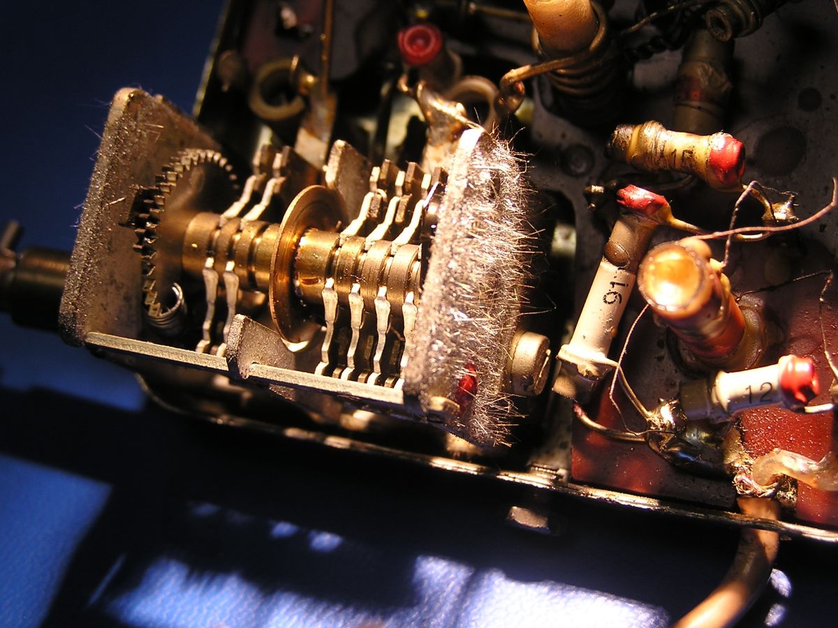

    Here (again from the NASA website ) is a photo of an air capacitor from the 1960s showing a literal forest of tin whiskers:
    Close-up of a capacitor covered with dense, thin tin whiskers
    I don't assume this is what it looked like shortly after it left the factory. Unless you meant that this is how the source of growth is created and then that growth continues for years to come.

    clubber84 wrote:
    Tin whiskers do not grow when the solder or tin is isolated from the air (varnish, resin pour, glue, etc.), so air is one of the conditions.
    Another explanation is that the varnish is simply a mechanical barrier through which the whiskers do not grow.
    Besides, moustaches also grow in a vacuum, according to information from the NASA website:
    Screenshot of a document outlining environmental factors affecting tin whisker growth

    megao wrote:
    Testing today a device that I commissioned 8 months ago to assemble components on a PCB. Lead assembly.
    I may be wrong but the solder doesn't look like lead. I have only seen such flux cracking on the surface on lead-free alloys. I suggest you check more carefully what paste was used. Case no.2, the problem is not necessarily due to the paste, it may well be due to the coating on the component pins themselves. Case no.3, even if the solders are lead-free they are the worst I have seen. And finally, you can spray the boards you have with a preventive varnish such as plastic 70 or something similar.

    Nepto wrote:
    1/perhaps the lead binder was not lead? Is it possible there was an error on the part of the plate manufacturer? Since you wrote that they didn't do an electrical test, maybe the binder wasn't as specified either?
    The binder on this board actually looked strange. It was glossy on parts of the plate, matte in other places. Hence my initial guess that there was a mixture of lead and unleaded paste present. A plate fault - a short circuit, I rule out in this case.
    Nepto wrote:
    2/Maybe these whiskers grew not from the binder, but from covering the IC leads (I can't see it well in the photo)?
    Very possible. Based on the information in the article
    Tin Whisker Mitigation Strategies: Cleaning or Coating?
    whiskers are more likely to grow from tinned leads.
    In some applications, some way to minimise the phenomenon may be to recoat the leads with tin-lead binder.
    Nepto wrote:
    Was the plating lead-free or leaded?
    The circuit boards and component assembly were commissioned using lead technology. This was done by two different companies, I had the boards in my hands and they actually looked tin/lead.

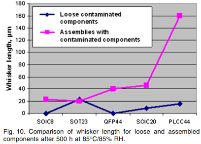

    Another factor favouring the growth of tin whiskers could be contamination present on the leads of the components, as well as flux residues after assembly. This is well described in the work
    Whisker Formation Induced by Component and Assembly Ionic Contamination
    The authors presented an interesting experiment involving the careful analysis of whisker growth at component leads. Discrete components as well as integrated circuits in enclosures with different raster, clearance and soldered to PCBs were tested.
    The components were divided into three groups according to the level of lead cleanliness:
    (a) the components were left as supplied by the distributor,
    (b) they were subjected to a thorough cleaning,
    (c) impurities were introduced with compounds: NaCl (sodium chloride), Na2SO4 (sodium sulphate), (CH3CH2)2NH2Br.
    A significant effect of elemental impurities and flux residues on the growth of tin whiskers was observed. The results of the experiment are well described, well worth a look.
    Two line charts showing tin whisker lengths based on assembly cleanliness and contamination types.
    Comparison of tin whisker length for contaminated loose and assembled components
    Graph of tin whisker lengths for various packages and assembly cleanliness levels
