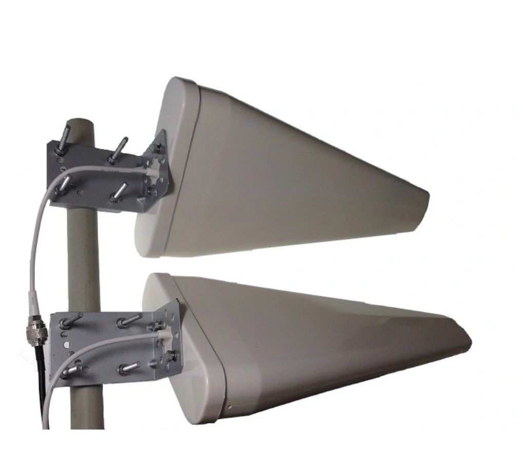

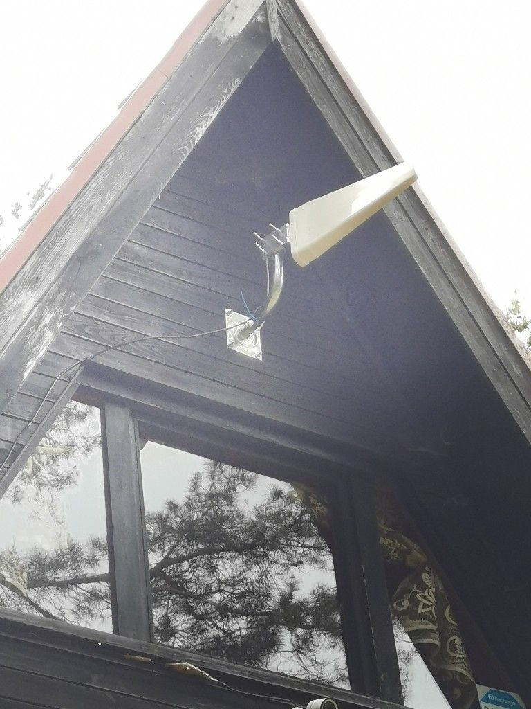

    LMR240 cables 5m. ATK504 vs ATK-LOG ALP LTE Antennas: Differences, Price, Compatibility with DWR921 & Forest Coverage ATK504 vs ATK-LOG ALP LTE Antennas: Differences, Price, Compatibility with DWR921 & Forest Coverage Until the weekend I had exactly as in the picture (two antennas), but on Sunday I gave the second one to my neighbor for testing, maybe it will go to him. According to the instructions, I changed the angle at one antenna. After removing, nothing has changed, the range is 3 lines and the speed is around 13 Mb / s.

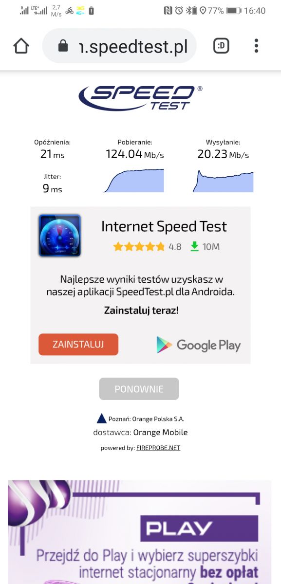

    Thanks. I have already run with the antenna around the house and to all corners of the world - without muans. I still have the area around the house ?. I bet on the forest that is around me. To the forest wall from the antenna 12m. by the lake to ATK504 vs ATK-LOG ALP LTE Antennas: Differences, Price, Compatibility with DWR921 & Forest Coverage which is about 500m in the forest, I have over 120 Mb/s on my phone. I will keep fighting.

    Thanks for advice. I'm letting go of this for now. One antenna was taken by a neighbor, I have the second one towards the mast, I changed the card to orange and it's ok. The direction of the antenna is the same as before - I didn't change anything, because t-mobile and orange are on one mast.
    I'm waiting for the season when tourists will come and the transmitter will be occupied. If it's the same, that's enough for me. Regards
