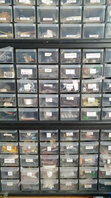

    There is another issue with the drawers that I forgot to mention - I can't imagine drawers for electronics that are not transparent. Somehow the inscriptions are not enough for me, but if others don't mind then ok :)
    I find it quicker to search for an item when I see something like this:
