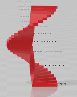

    Thanks for the hints.
    I'm a "layman" on the subject, so I approach all programs without prejudice. I'm using each one for the first time ever.
    As a test, I've thought of doing a winding staircase. If I can't manage it in a reasonable time, I'll let it go.... It's a simple thing, I should be able to do it "by feel", without hours of poring over manuals or watching tutorials on YT.
    The theory is simple:
    1. Create the first step
    2. Define the axis
    3. Copy the step by simultaneously rotating it by a given angle and moving it by a height
    4. Repeat n times
    This should take perhaps a minute if the program is equipped with the appropriate tool ;-)
    So far I haven't come across an AutoCAD "array" type command anywhere, so it doesn't get done as automatically as I'd like.
    I looked at DesignSpark Mechanical for myself and after several minutes I had a model like the one in the appendix. First I manually copied and moved one step, then two, then four and in this way I managed on foot. It took me the longest time to figure out shifting and rotating, and I still don't know why the coordinate system relating to an element can rotate me by a strange angle relative to the global coordinate system. Magic. The rest is just a matter of practice.
    On the printscreen, you can see that the 'attachment' point for rotation or translation is at the centre of the edge of the top step. Just why does it have the axes positioned so out of whack? I haven't discovered what I'm doing wrong yet, because on some attempts it's OK, and on others something is "wobbling". ;-)
    Simple screwdriver stand for wall mounting - design and 3D printing
    And the same object imported into Windows Builder.
    SketchUP came off because after an hour I had nothing meaningful. When I moved the first copied step into place, this one "glued" to the previous one, so it was impossible to rotate it, and if I rotated it first and then only moved it into place, it glued so that triangular "holes" in the model formed. It was not possible to merge the two degrees, because some message appeared that the objects were not solids....
    TinkerCAD - friendly and colourful, you can see that for children. But it gives advice "with a finger", as does DesignSpark,. For that I don't know how to choose the axis of rotation - the model always rotates around some centre of gravity of its own, not around an edge, for example.... Probably too childish though.
    Blender - this one looks like it has an "array" type tool, but for that it doesn't look user friendly. Already when opening a project it gives probably five options to choose from and I wonder whether to select "general" or "sculpting".... Recognising all those tabs, icons and menus is a full-time job.
    Fusion 360 has a free version, if the trial period expires is it after the ball?
