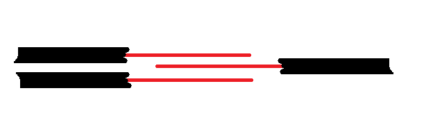

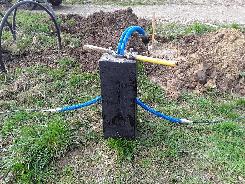

    #52 21093510
    Maciej_F
    Posts: 111
    Rate: 23
    Hello . And I will ask myself how to connect 3 wires ?
    I have to make a connection of copper wires 2,5mm2 (from earth cable YDY3x3,5mm2) .
    I should connect the wires 2+1 as in the diagram . As reliable connection as possible ( possible in the field without access to electricity ) . Connection then no longer available . Maybe not going directly into the soil . But high exposure to moisture . The insulation itself I envisage with heat shrinkable tubes with glue .
    first the individual wires R , N , PE , and then all together in a common T-shirt . I am building a 140 m long garden light with 10 light points.

    #53 21093530
    ghost666
    Translator, editor
    Posts: 11961
    Help: 157
    Rate: 10267
    I should connect the wires 2+1 as in the diagram . As reliable connection as possible ( possible in the field without access to electricity ) . Connection then no longer available . Maybe not going directly into the soil . But high exposure to moisture . The insulation itself I envisage from heat shrinkable tubes with glue .
    first the individual wires R , N , PE , and then all together in a common T-shirt . He is building a 140 m long garden light with 10 light points
    WAGO bridges.
  • #54 21093544
    stanislaw1954
    Posts: 15245
    Help: 2013
    Rate: 4673
    @ghost666 Nonsense. Either a press, which is complicated, however, for someone who has not done such connections, or soldering, however, and a distance of 140m , is not an insurmountable distance for an extension cable/, or several extension cables.
  • #55 21093559
    bubu1769
    Posts: 8063
    Help: 1177
    Rate: 2374
    You could also use heat shrink sleeves with low-temperature solder, this can even be heated with a normal lighter, and the whole connection in a gel can for safety.
  • Soldering versus crimping for wire joints
    #56 21093605
    Maciej_F
    Posts: 111
    Rate: 23
    Wago cubes drop out in the run-up : no room in the cube and no hermeticity . I'm not saying that there isn't a current in the hectare and I can play around with it. I am not saying that there is no current in a hectare and I can play with soldering. I have not worked with a crimper. But if you buy 100 bushings, I can break half of them.
    Solder not solder , crimp not crimp .
    As the classic said : Bytku nebytku oto je pytanko .

  • #58 21093958
    metalMANiu
    Level 21  
    Posts: 619
    Help: 11
    Rate: 242
    Maciej_F wrote:
    Wago bridges are out of the running : there is no space in the wire and it does not provide airtightness .
    I advise against hiding connections in the wire.
    Although on the whole, what can happen there?
    Well, sometimes it can.
    A colleague wrote about a can of gel. I think that is a good way to go. There are also tiny cans for exactly one wago connector.
