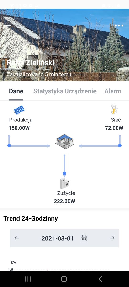

    I have a new 3.3KW installation with SOFAR KTL-X 4.4 inverter
    What system monitoring program can your colleagues recommend to work with this inverter?

    I have Solarmanpv.com, but he does not show me my consumption, and as for pvmonitor.pl
    from what I read, I would probably have to have some additional device that would transfer data from my inverter to the website
  • #6 18253965
    3301
    Posts: 2100
    Help: 224
    Rate: 869
    No load energy flows through, for example, the house, so the inverter of this load does not flow through the currently installed inverters. he does not see, to control the consumption it would have to be an additional meter, but the solarman will not see it anyway
    Lancontroler, meter and pvmonitor would do it, or a dedicated meter for the inverter and probably only fronius and steca offer such

    Lan Controller overlay Modbus and beautifully monitors Sofara. I recommend
  • #24 19312483
    krzych101
    Posts: 87
    Rate: 71
    Maybe a colleague elaborate on the topic by providing more details?
  • Real-time SOFAR inverter parameters available via LAN controller
    #25 19312990
    bioly
    Posts: 34
    Rate: 18

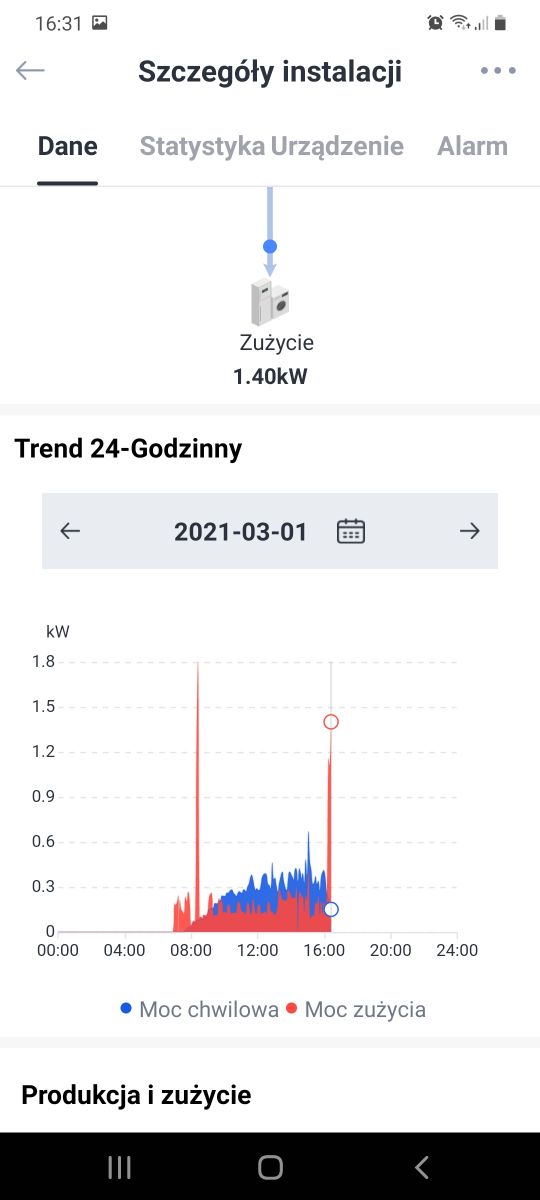

    You can monitor such inverter parameters in real time, Lan Controller refresh is set to 0.5 sec by default. Write what you need to know, I will say if it is possible :)
    State
    Fault1
    Fault2
    PV1 voltage
    PV1 current
    PV2 voltage
    PV2 current
    PV1 power
    PV2 power
    Output active power
    Output reactive power
    Grid frequency
    A-phase voltage
    A-phase current
    B-phase voltage
    B-phase current
    C-phase voltage
    C-phase current
    Total production
    Total generation time
    Today production
    Today generation time
    Inverter temperature module
    Inverter inner temperature
