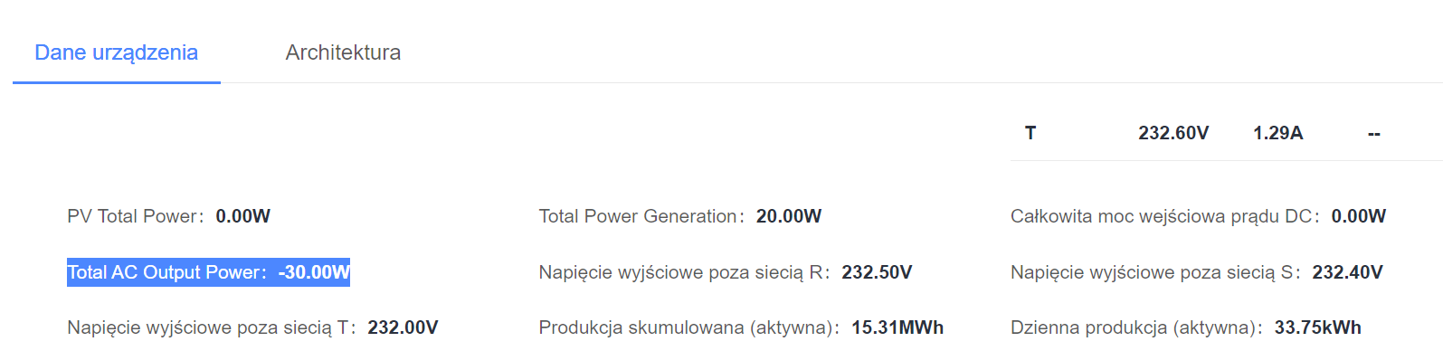

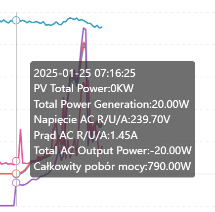

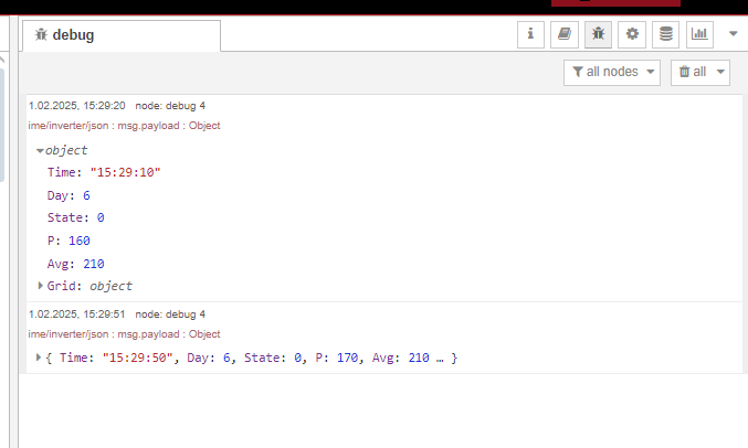

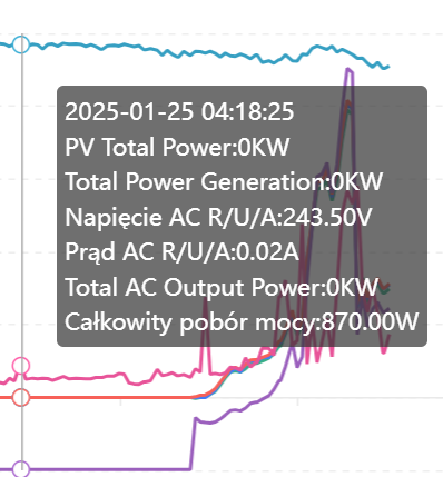

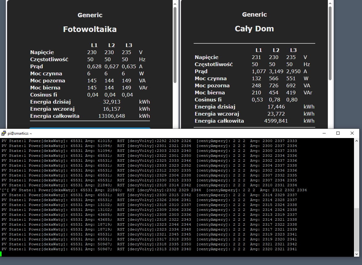

    I separated for one reason.
    @Daro1003's tests show an anomaly:
    as long as the panels are giving some energy, the power transmitted by the inverter is correct, but once it is dark and there is no energy from them, the power value :
    is from the hours when it is still light, the power sent to the grid P 310 or 31W (the power the inverter returns in decaWatts) :
    Console display showing JSON data from an inverter. .
    In the moment of darkness it is 65531
    Screenshot showing inverter data in JSON format.

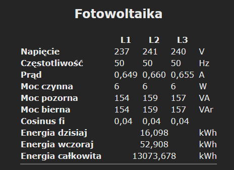

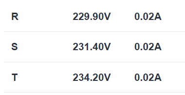

    Today it occurred to me that this is a number with a sign. As the modbus register data is 16-bit, I converted 65536 - 65531 = -5 W.
    Daro wrote back to me on pw: "This may be correct because I have 6W per phase on the PZEM 004T meter."
    As I also have phase voltages and phase currents among the information from the inverter, I calculated this as well.
    It comes out for the selected phase: 241.4 V * 0.02 A = 4.828 W. A little less, but let's say that's it.
    The question is why the power shown in the ActivePowerOutputTotal register is not the sum of all phases?
    This is only the case when there is no power from the panels, if they are working the ActivePowerOutputTotal power is correct.
    At my place I am not able to check this, I do not have a hybrid.

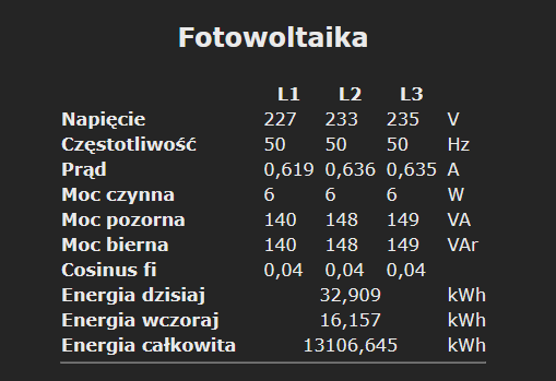

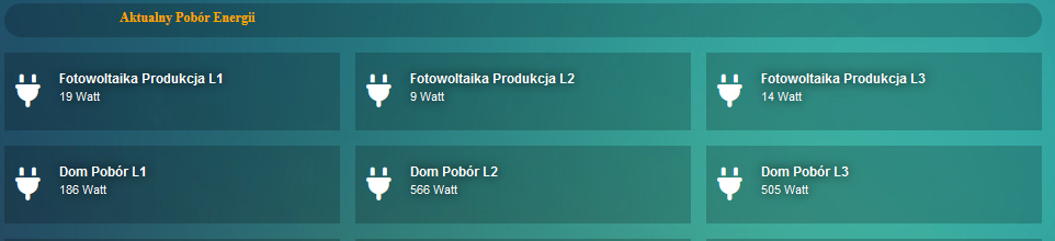

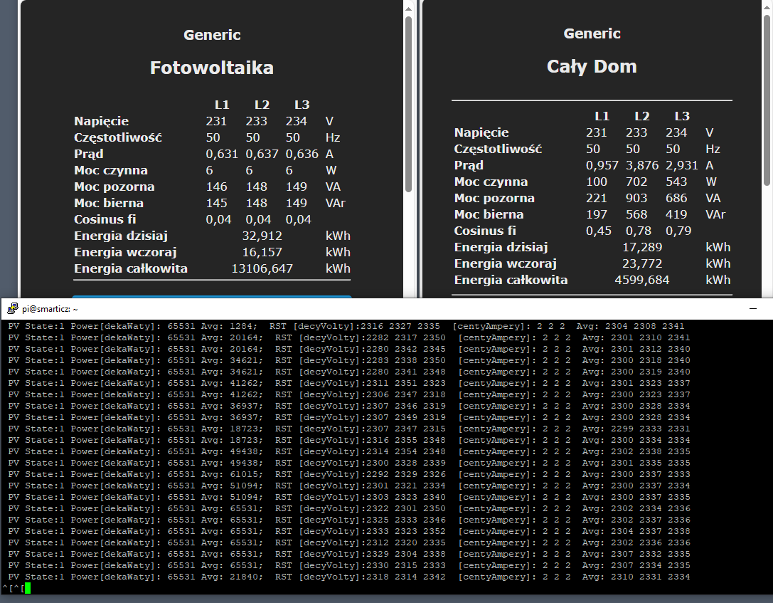

    michal.zd wrote:
    Daro wrote me back on pw: "This may be correct because on the PZEM 004T meter I have 6W per phase."
    I'll throw in a screen shot from Tasmota with the super accuracy of the PZEM 004T modules may be rife but here are the indications as it is dark.
    Screenshot from Tasmota showing precise readings of PZEM 004T modules related to photovoltaics.
  • #3 21408458
    michal.zd
    Posts: 1684
    Help: 84
    Rate: 274
    I found the documentation, it is as I guessed: type int_16, so that the sign, description:
    Total Active power.Charge is positive,Discharge is negative,
    But only valid for HYD 5 ... 20K-3PH and HYD3 ... 6K-EP.
    For online inverters it is without sign, known.

    Today I caught a reading in the morning as it goes from night to day:

    Daro1003 wrote:
    Power[decaWatts]: 65535
    Converting to a negative number will be -1 decaWatts and then grows on the plus side.
    Eh, zem about forgot the unit myself. These are decaWatts, so 5deka is 50W drawn from the mains.

    michal.zd wrote:
    50W draws from the mains.
    That much it draws from the mains in the evening when idle ?
    Strange why the PZEM only shows 6W or rather it shows reasonably ok because I tested it on light bulbs.

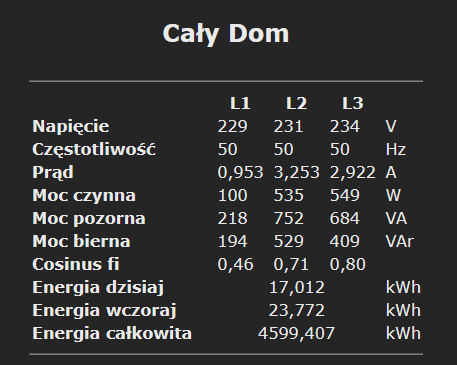

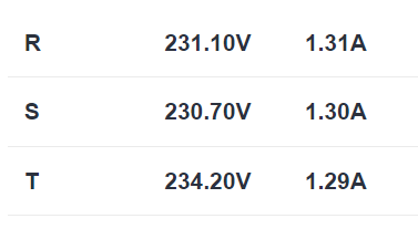

    I have a request, give from the same time broker information and screenshots of the inverter page. You need to work out what this data relates to. I will look in the documentation, maybe I can find something online.
    Added after 7 [minutes]: .
    Daro1003 wrote:
    This is how much it draws from the network in the evening when idle ?
    Strange why PZEM only shows 6W
    Well there is just something wrong with this value.

    michal.zd
    Posts: 1684
    Help: 84
    Rate: 274
    The descriptions of this register for HYD are puzzling:
    ActivePower_Output_Total ; 0.01 kW ; Total Active power. Charge is positive, Discharge is negative;
    The words Charge and Discharge... As if referring to the battery and not the power grid.
    Is there such information on the inverter or solarman website?
    Added after 1 [hour] 8 [minutes]: .
    Eureka !!! Thanks @Daro1003 for the inverter data !!!
    The example of the night brightened everything up:
    Graph with energy data showing voltage, current, and power information. .
    Phase voltages known, but phase current: 0.02A and Power agree with the broker data (slightly different time but no harm done):
     Power[dekaWaty]: 0 ... RST [decyVolty]:2399 2399 2375  [centyAmpery]: 2 2 2
    everything becomes clear.
    The power calculated from the phase voltages and currents gives the total power shown in the inverter as Total Power Consumption.
    The comparison of the data from the morning itself is similar:
    Graph displaying energy production parameters on January 25, 2025, at 07:16:25. .
    which corresponds to the data from the broker (also about the same minute, unfortunately the time accuracy on the solarman is not the same as the broker):
    PV State:0 Power[dekaWaty]: 65535 Avg: 3851;  RST [decyVolty]:2394 2402 2399  [centyAmpery]: 147 140 150  Avg: 2383 2410 2400
     PV State:0 Power[dekaWaty]: 65535 Avg: 58250;  RST [decyVolty]:2392 2400 2396  [centyAmpery]: 147 139 150  Avg: 2384 2409 2399
    All clear.

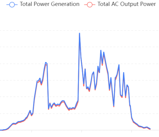

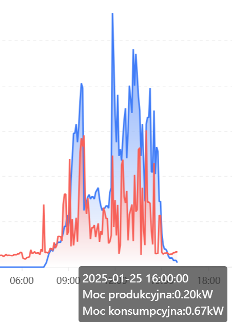

    I have had a look at the graphs from today. Preliminarily, I can say that the value returned by the broker from the ActivePower_Output_Total register corresponds to the blue line on this graph, minus the inverter's own losses. The data to their cloud is sent every few minutes, so this graph on the solarman site is approximated.
    The broker checks in every half an inverter minute, the data is more accurate :
    Chart comparing production and consumption power with marked date and time. .
    In this graph you can better see the difference between ActivePower_Output_Total and the blue 'Production Power' and the red ActivePower_Output_Total underneath it :
    Graph showing total power generation and total AC output power. .
    Consumption power is missing from the total picture.
    Another view, here you can see exactly which value it is:
    Screenshot showing PV device data, including AC output power and voltages. .

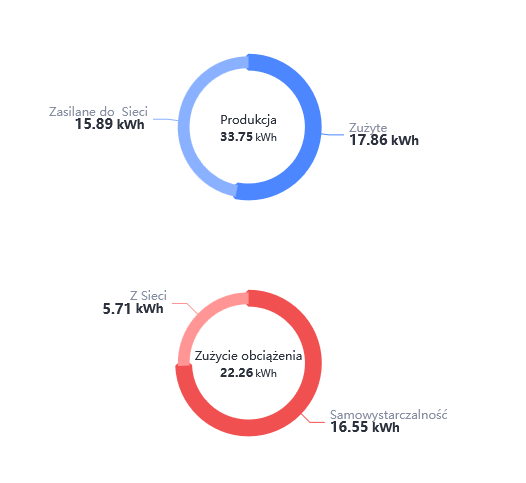

    michal.zd wrote:
    The whole picture lacks consumable power.
    Pie charts showing energy production, consumption, and self-sufficiency. .
    In this graph we have self-sufficiency and consumption I don't know just how to understand it.

    @Daro1003 if you can, check that the broker states a Power value of 65 532 which means -30W
    this is the value from the earlier screenshot
    Added after 1 [minute]:
    Now this is already "Total AC Output Power:-40.00W" or 65,531

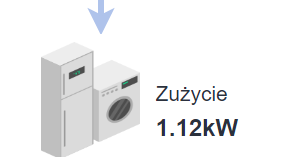

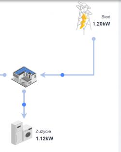

    only now does the sum of the individual phase powers U*I give a total :
    The illustration shows a refrigerator and washing machine with the caption Consumption 1.12 kW. .
    Added after 35 [seconds]:

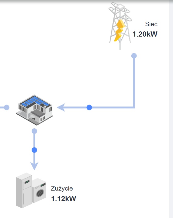

    Daro1003 wrote:
    PV State:0 Power[decaWatts]: 65531
    own - 40W
    See:
    Diagram of electricity flow between a power grid and a building with solar panels.
    is this value of 1.20 taken from the mains and 1.12 consumption, i.e. in the battery goes.
    A negative value means the battery is charging.
  • #19 21409346

    This second diagram shows exactly how much I use the appliance at home:
    Screenshot showing current energy consumption and photovoltaic production at home. .
  • Need PZEM mapping for broker values
    #20 21409368
    michal.zd
    Posts: 1684
    Help: 84
    Rate: 274
    is this from PZEM?
    anyway, it's already known what the 'Total AC Output Power' value is - it's the power of the PV panels minus the charging power of the storage, that's some concrete.
    As I wrote, it would be useful to know the 'Consumption' to make sense of the HEMS/MEMS algorithm.
    It is also not clear what the values are:
    Table with voltage and current values for three phases R, S, T. .
    and these values are given by the broker after RST
    RST [deciVolts]:2323 2316 2341 [centsAmps]: 132 131 129
    Total power by U*I is 912.5W, does not match the value given in the first image:
    Network: 1.30kW and Consumption:1.24kW
    maybe you can find a link with what PZEM shows ?
  • #21 21409383
    Daro1003
    Posts: 2713
    Help: 295
    Rate: 606
    michal.zd wrote:
    this from PZEMs?
    Yes exactly.
    Added after 43 [seconds]:
    michal.zd wrote:
    as I wrote, it would be useful to know the 'Consumption' to make sense of the HEMS/MEMS algorithm
    Hmm then where to mount PZEMs or some sort of counter ?
  • PZEM placement and Modbus data availability
    #22 21409387
    michal.zd
    Posts: 1684
    Help: 84
    Rate: 274
    Daro1003 wrote:
    where to fit PZEMs
    where do you currently have them? Behind the inverter on the house network or in front of the inverter on the meter side?
    i think somewhere this information is also available via modbus, currently i don't read it because i don't have this data. I will see later in the documentation.
    We are aiming to get everything we need out of the inverter.
    In addition, we have these voltages and currents of the three phases, as if you trace with PZEMs, whether this somehow agrees with them, it would already be concrete.
    #23 21409389
    Daro1003
    Posts: 2713
    Help: 295
    Rate: 606
    A table with photovoltaic data, including measurements of voltage, frequency, current, power, and energy for three phases L1, L2, L3. .
    Table with energy consumption data for three phases: L1, L2, L3. .
    1. from the photovoltaic has on wires from the inverter to the protection.
    2. the ones on the house I have directly on the house but already before the RCDs themselves.
    I will sketch a diagram
  • #24 21409394
    michal.zd
    Posts: 1684
    Help: 84
    Rate: 274
    oo great - give the broker data again, I'll see what's there,
    preferably again and the broker data and the PZeM data so that the time is more or less the same
    I suspect the broker will now show what they show here, which is 20 mA each - they will be 2 2 2 themselves :
    Table with voltage and current values for three phases. .

    Rate: 606
    It should be ok:
    Displays of photovoltaic and whole house data with measurement results. .
    Added after 6 [minutes]:
    Screenshot displaying energy data from photovoltaics and the entire house. .

  • PZEM readings match inverter data within 1–2%
    #28 21420031
    michal.zd
    Posts: 1684
    Help: 84
    Rate: 274
    @Daro1003 spent some time experimenting and observing. For a week we checked the indications of the PZEM he has installed on the side of the house and the data received from the inverter. Conclusion:
    it is ok. Data practically the same, differences of 1 to 2 %.
    In summary, mqtt data transmitted from the broker (from data from Darek):
    ime/inverter/state S0, P 960, Avg 1020 Grid 230 Con 730
            - kolejno S: Status, P: Moc z paneli PV, Avg: potem wyjaśnię,  Grid: moc do(wart.dodatnia) lub z (ujemna) sieci, Con: konsumpcja
    ime/inverter/json { "Time":"11:58:23", "Day":6, "State":0, "P":960, "Avg":1020, "GP":230, "CP":730, "Grid": ....
            - łatwo się domyślić

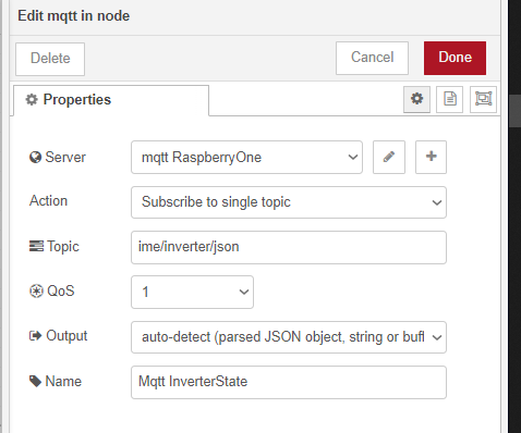

    for use in node-red, a ready-made json from topica: 'ime/inverter/json' is most suitable
    using the node "mqtt in"
    Screenshot showing the mqtt in node icon in the Node-RED application. .

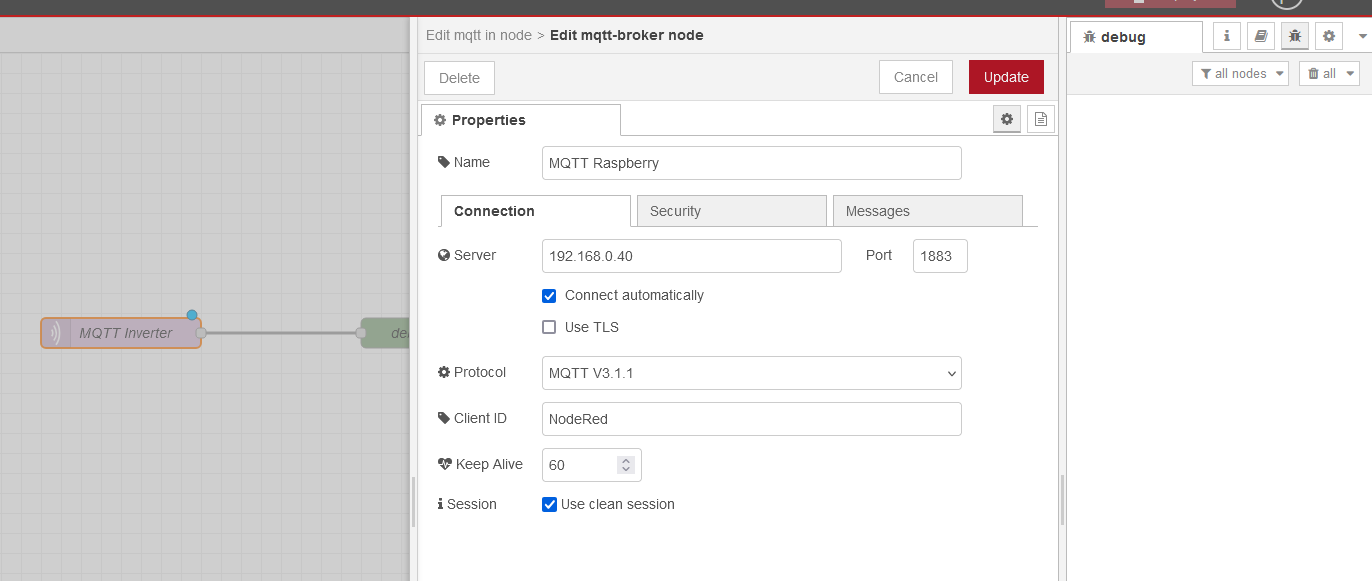

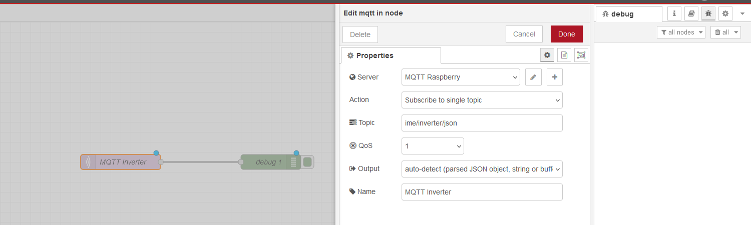

    insert in 'Flow' and by double-clicking on it, give it the data:
    Editing MQTT node in Node-RED with subscription settings. .

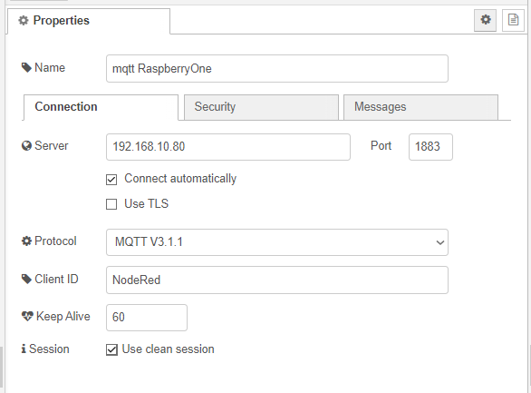

    Server - with a 'plus' you have to define the address of the mqtt server, I have it like this:
    MQTT connection configuration in Node-RED with IP address 192.168.10.80. .

    I use node "debug" to preview the incoming data, by linking it to the output of the previous one you can watch in the node-red sidebar what the msg object looks like.
    Added after 4 [minutes]: .
    For the test he proposes:

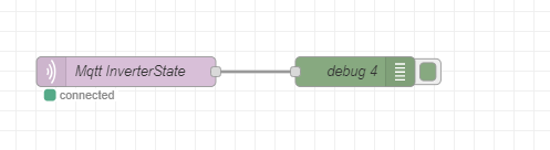

    Node-RED flow diagram using MQTT connection .
    after 'Deploy' Deploy button in the Node-RED user interface. .
    messages will appear in the sidebar on the right:
    Screenshot of the debug panel in Node-RED showing JSON data. .
    If you do not see the messages, you may need to click on the worm: Screenshot showing a bug icon labeled Debug messages in Node-RED.

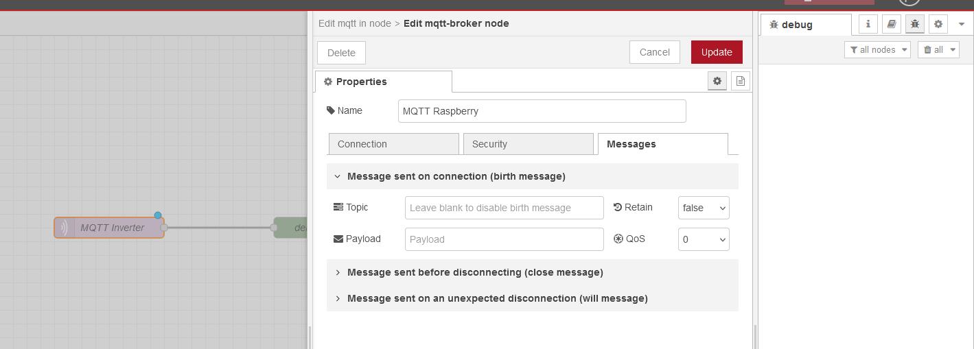

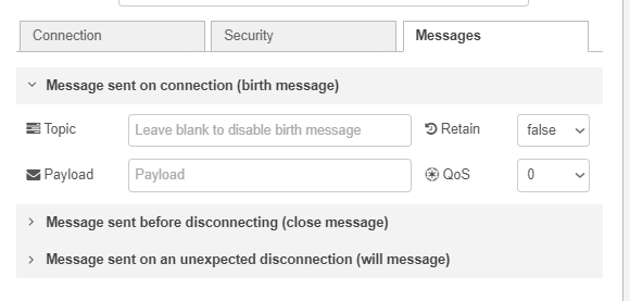

    Appears to be set:
    Node-RED user interface with MQTT node settings. .
    MQTT-broker node configuration screen in Node-RED .
    Screenshot of MQTT node editor with Messages tab selected. .
    Nothing is flying maybe because the inverter is not sending anything or I have something wrong.
    Do we set anything in the Security tab ?
  • #30 21420445
    michal.zd
    Posts: 1684
    Help: 84
    Rate: 274
    Check if mosquitto_sub is receiving something.
    And such a silly question: did you press the red Deploy button?
