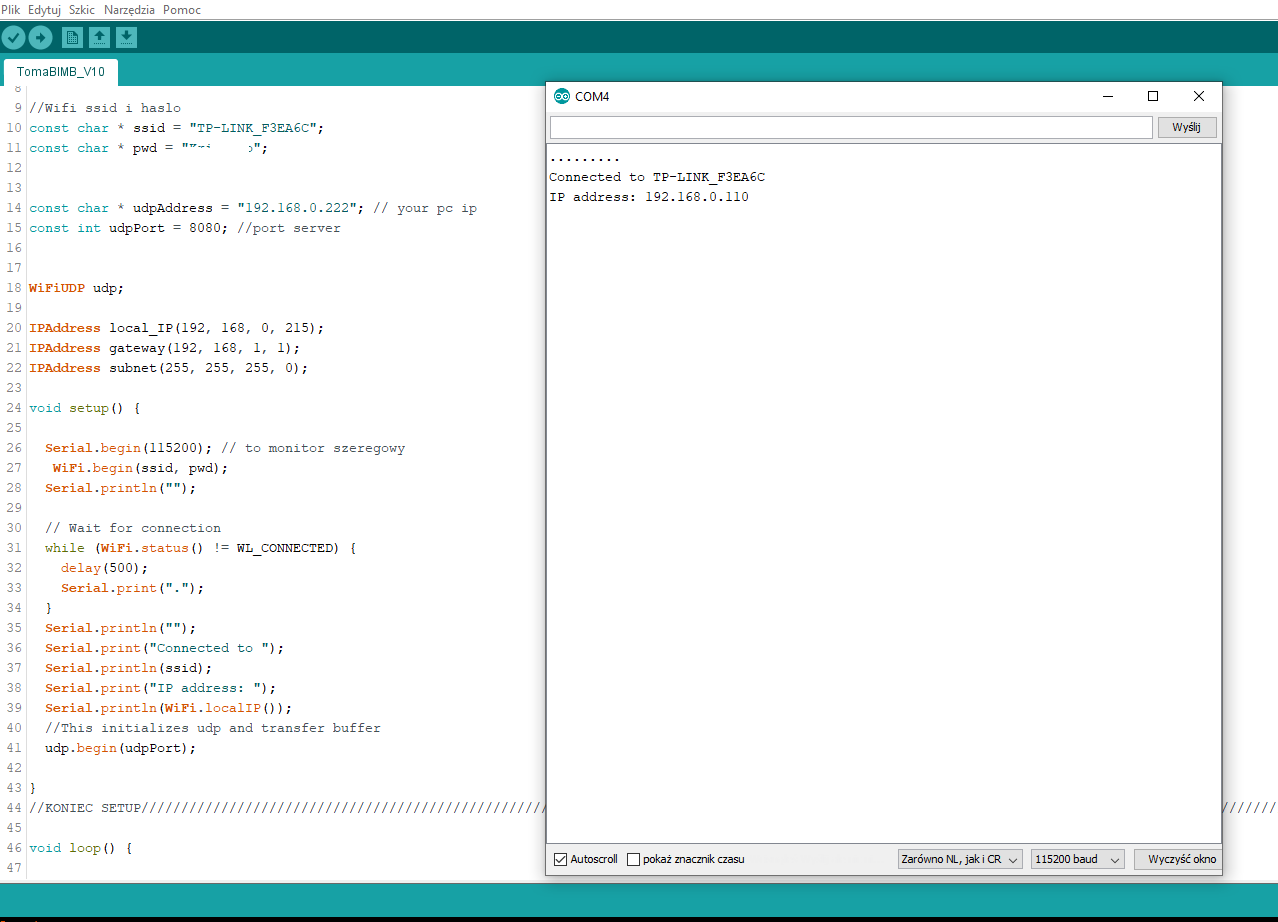

    Uploading the following code:
    Code: C / C++
    then attaching the serial monitor, the IP is assigned randomly (practically different every day). Is it possible to assign a specific IP address by modifying the libraries accordingly?

    Hello, write again what you mean, because the attempted solution you presented has little to do with the question you asked. You can either set a fixed IP address for the client on a DHCP server (e.g. oi MAC number) or instead of DHCP configure it statically. I'm not familiar with the arduino, maybe Wifi.config()?

    What I mean is that my ESP32 should have a fixed IP address, as I connect to it via different applications. For data exchange to be possible the ESP32 needs to know the IP address of the application and the application needs to know the ESP32 address.
    The example shown is for communication over TCP/IP and there is no problem with that, but the UDP protocol allows for much faster data exchange and the point is that with UDP I can't set a static IP in any way
    WiFiUdp.h: How to Assign a Static IP Address to ESP32?
    If I use the UDP library I always have a different IP than I would like. What I wrote earlier also does not work

    It wasn't until today that I was able to sit down to this quietly and indeed the solution was WiFi.config(local_IP, gateway, subnet);
    Code: C / C++
