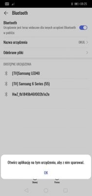

    I bought a Beko WTV7532XAW washing machine, which has the option of pairing and using it with the application homewhiz . The problem arises in the supposedly simplest step that is how to add a washing machine. The bluetooth icon is flashing on the washing machine, bluetooth is searching for the washing machine, but when I try to add a message pops up open the application to add the device. I open homewhiz, enter the serial number further by. instructions, and it still fails. What should I do?

    Well, that's the problem, because clicking on the name of the washing machine on the phone only pops up a message that I should open the application.
    I understand that in the washing machine, as in the instructions, it is enough to press the temperature + bluetooth on the turned off washing machine and wait for the countdown to end? Does anything have to be done differently before this combination? [align = left]

    99% of you don't use HomeWhiz instructions. I caught up on it too. If you can see the washing machine's Bluetooth, i.e. it is turned on.
    Step 1 Turn off washing machine
    step 2 Use the key combination to turn on bluetooth on the turned off washing machine.
    The application will find the washing machine.
