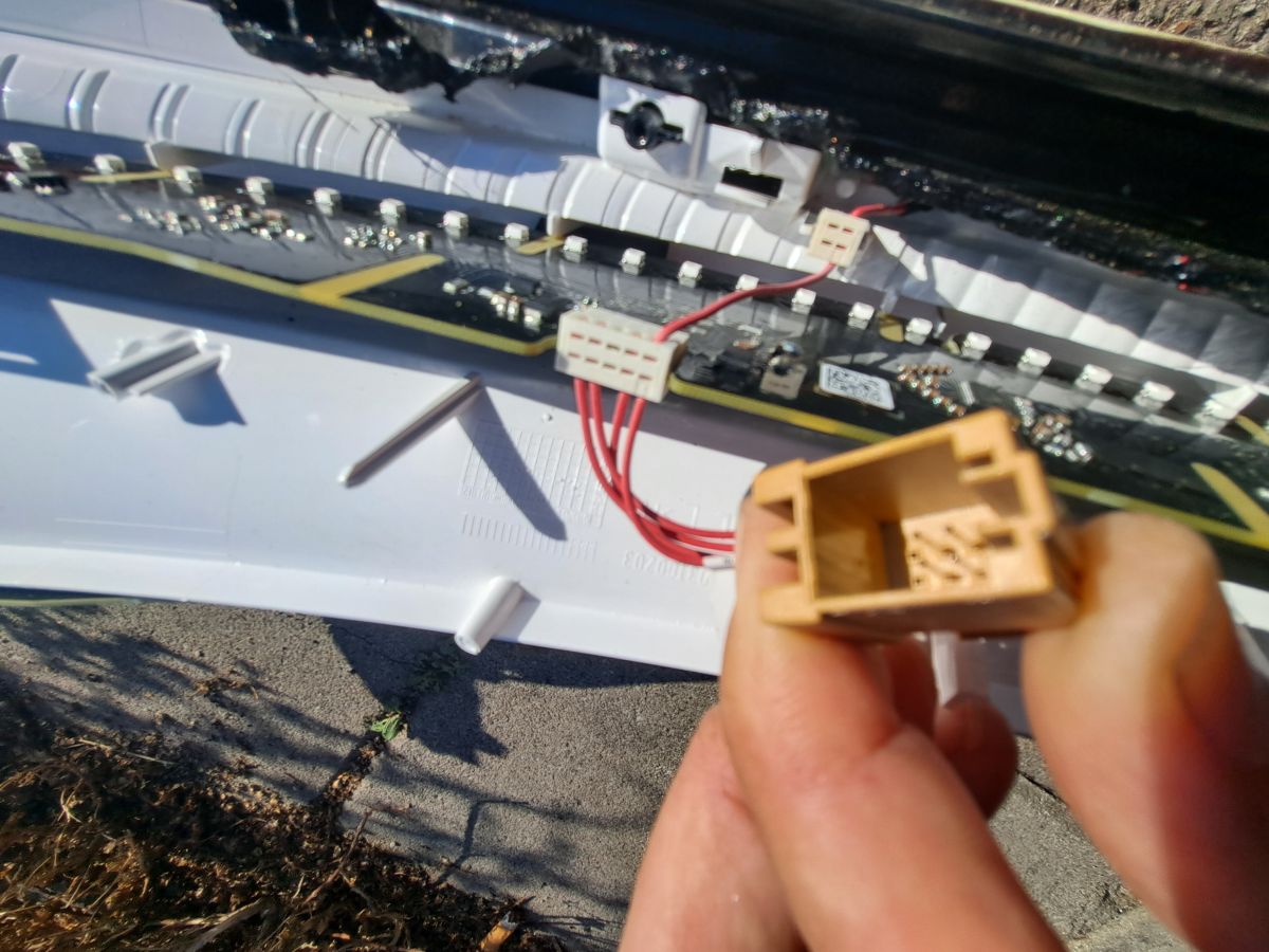

    Close-up of LED tail light interior with wires and connector held by hand .
    Q5 2021. USA with chrome trim
    I have opened the lamp and change the red leds to orange is it then enough to do the parameterisation? Does anything else need to be reworked in the lamp?
  • #59 21698767
    marok11
    Posts: 70
    Rate: 18
    I only did parameterisation on the pre-flight version
    Added after 1 [minute]:
    >>21698378
    can you send pictures of where you cut the lamp, because I have not yet done the 21st year

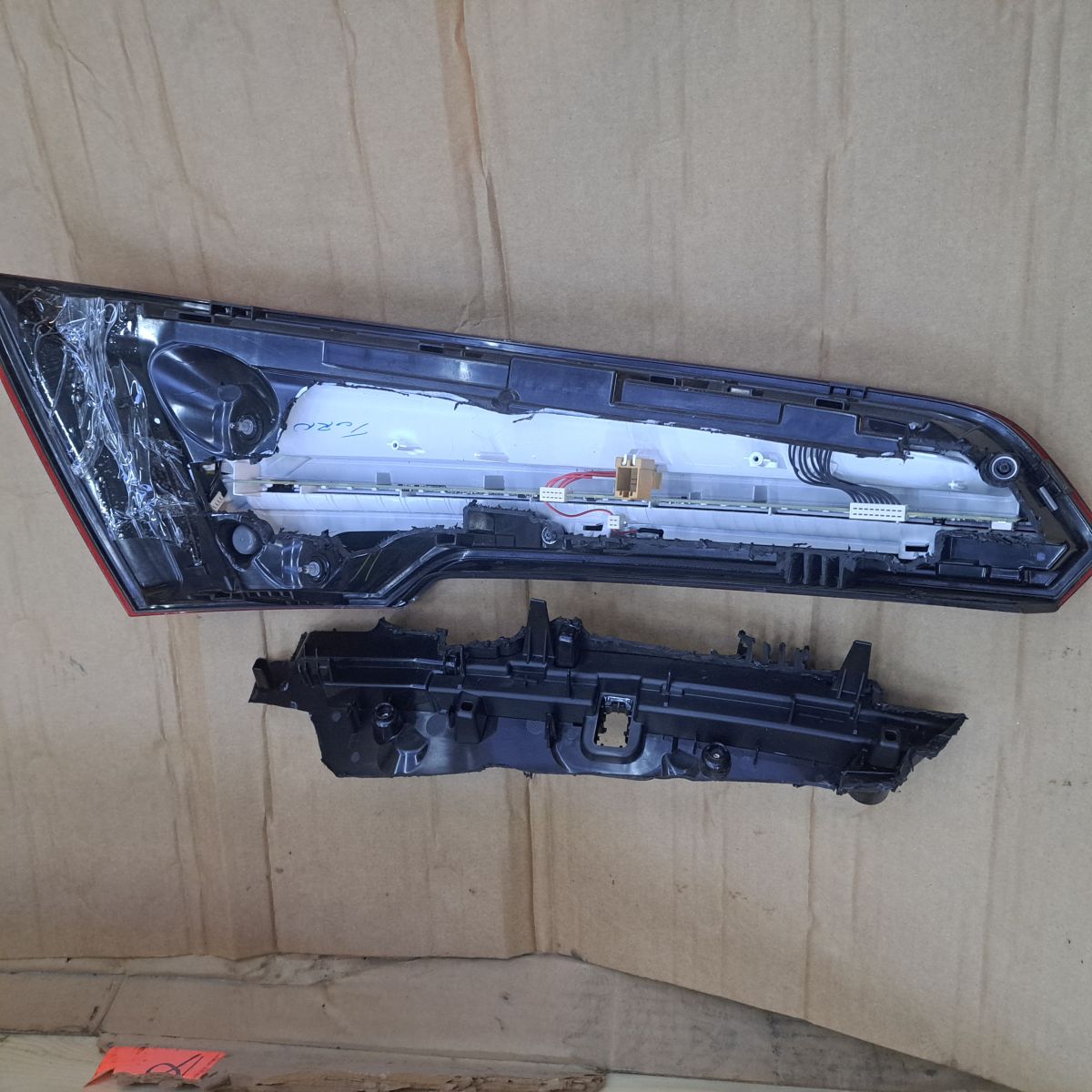

    Disassembled rear car LED light showing circuit board and wiring on cardboard surface. .
    The question remains, is it enough to separate the stop and indicator by cutting the wire in the right place? And then just feed the wires to the BCM and do the adaptation.
