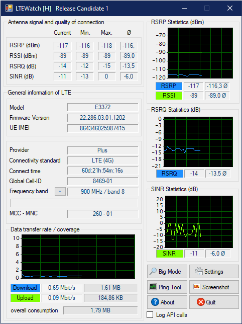

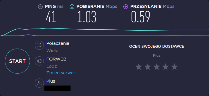

    So yes, the band that works for me is 900MHz at 1800MHz connects and disconnects after a while. I used to have a 21DBi parabolic antenna and it raised the range for me, but it did not want to connect to the Internet, it was probably the fault that I had it set to automatic bandwidth selection. It seems to me that it is worth at least to test it and if it does not bring the desired results, return it. That's my opinion.
    Added after 4 [minutes]:
    Which Mikrotik RouterBoard LHG 4G kit or RouterBoard LHG LTE6 kit is better?
  • #6 18318171
    matek451
    Posts: 31258
    Help: 4352
    Rate: 5808
    Test on lte900 made on E3372 with some antenna, what? The signal on this band, pretending to be very weak, on the assumption of 5MHz width on LTE900aero2 is slow and usually clogged. LTE1800aero2 at 20MHz also works on the BTS of Plus Obrzycko. The lack of location does not allow you to take a position on the choice of equipment, T-mobile has LTEE1800, LTE2100 and LTE800 in Obrzycko, with their aggregation, on each 10MHz band.

    Put the E3372 out of the window on a USB extension cable and test the LTE900 and LTE1800 because this antenna is rather an attenuator. What are the speeds of this Plus on LTE900, show speedtest.

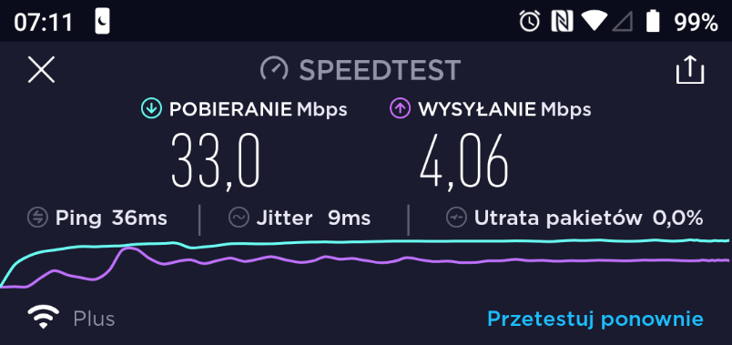

    The same internet has not been changed except that the temperature dropped below zero and it is on the 900MHz band.
  • #20 18320656

    The test from 7 a.m. has practically no meaning, in Plus, even at this time not many people use the Internet. the maximum load is between 19-23 and then the speedtest is reliable. The result obtained at the level of 33 Mb / s is almost the maximum for this LTE900 band.
  • #21 18324870

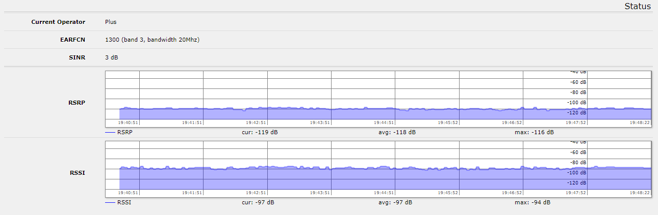

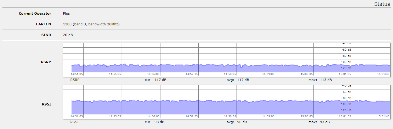

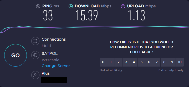

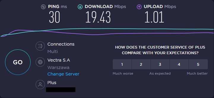

    Hello, it's me again. Yesterday, an antenna from MikroTik 21dBi came to me. And in my opinion it is much better than on the previous equipment.
    Which Mikrotik RouterBoard LHG 4G kit or RouterBoard LHG LTE6 kit is better? Which Mikrotik RouterBoard LHG 4G kit or RouterBoard LHG LTE6 kit is better?
  • #22 18324904
    matek451
    Posts: 31258
    Help: 4352
    Rate: 5808
    What's better? After all, the signal on LTE1800 is a drama, RSRP-117dBm with an antenna with a gain of 21dBi in theory. Do around 20 tests and show the results.

    maciejolelo
    Posts: 14
    The antenna works on the bands:
    LTE FDD:
    3 (1800 MHz)
    7 (2600 MHz)
    20 (800 MHz)
    31 (450 MHz)
    LTE TDD:
    41n (2500MHz)
    42 (3500MHz)
    43 (3700MHz)
  • LHG dish gain still helps at 1800 MHz
    #25 18325932
  • #27 18325982
  • #28 18325998
    matek451
    Posts: 31258
    Help: 4352
    Rate: 5808
    With such signal parameters at 1800MHz, it still has a good DL for Plus, you can see the station with little load,
