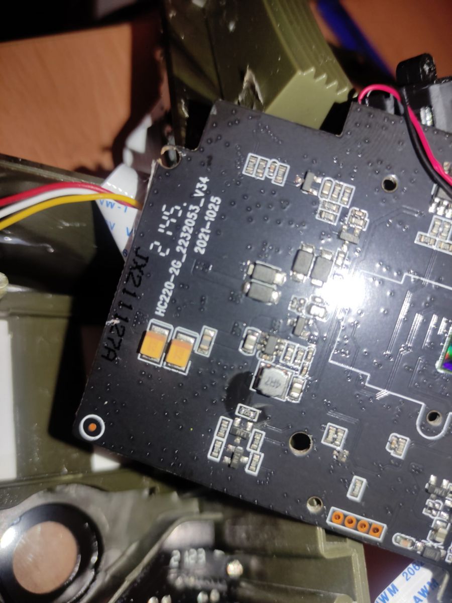

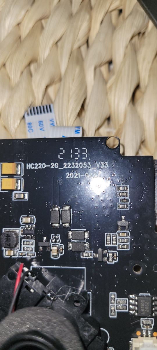

  • #34 20142400
    Achmedio
    Hello, I need the software for HC300M ver: 20210909-2053-v33
  • #35 20142422
    gradek83
    Posts: 9105
    Help: 929
    Rate: 2097
    Achmedio wrote:
    i need software for HC300M ver: 20210909-2053-v33
    Write to technical support
    Spoiler:
    support(_at_)cnsuntek.com
  • #36 20196068

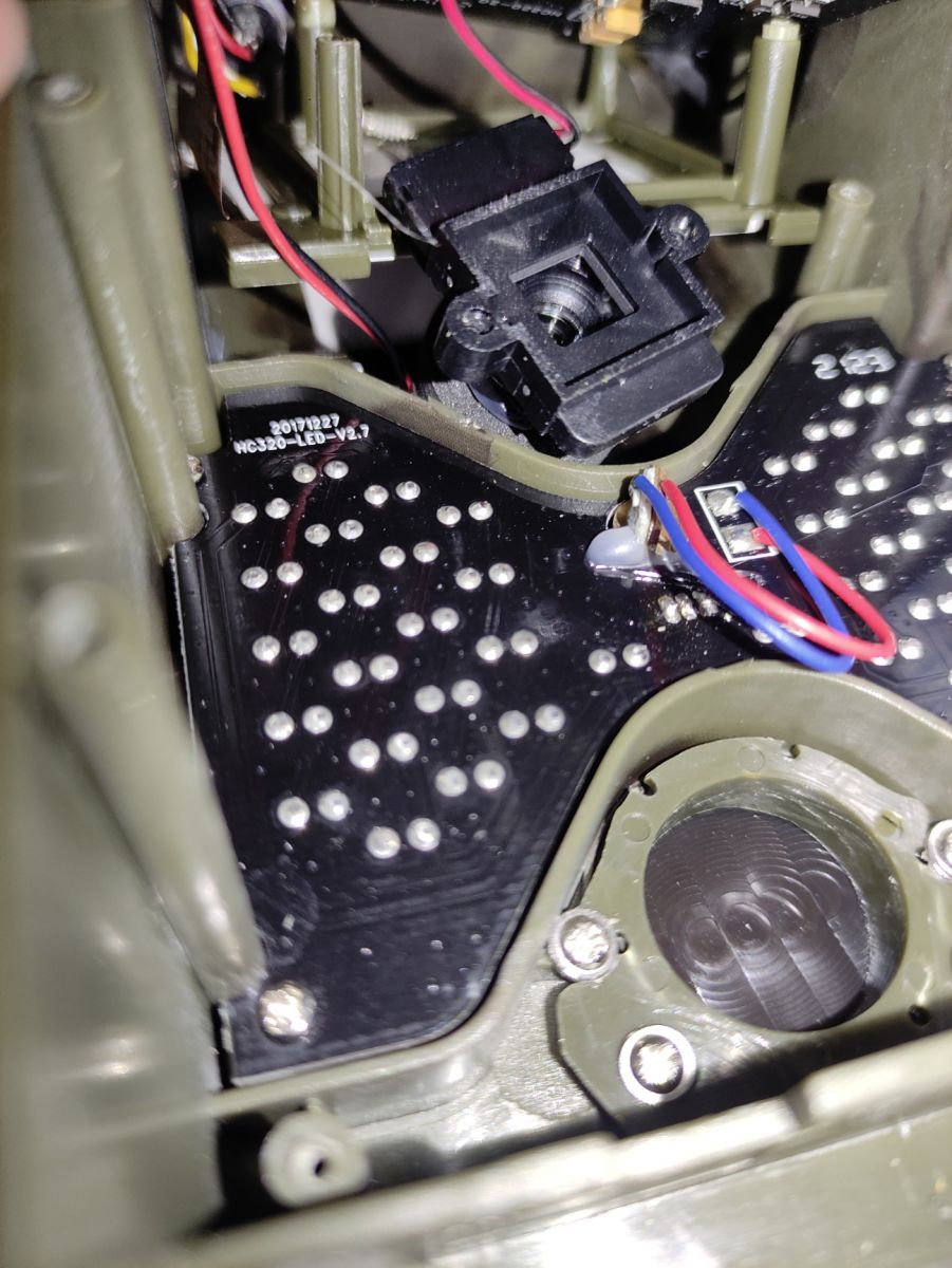

    misieq1206
    hello, I have a problem with my photo trap, I can't find the software for it.. it's a chinol at all because there is little information about this product in google..
    MODEL: HC-350M.
  • #43 20317601
    gradek83
    Posts: 9105
    Help: 929
    Rate: 2097
    Also send photos from the inside of the motherboard from both sides.
  • #45 20317855
    gradek83
    Posts: 9105
    Help: 929
    Rate: 2097
    Write to technical support and ask for new firmware in English.
    Send them your motherboard number.
    Spoiler:

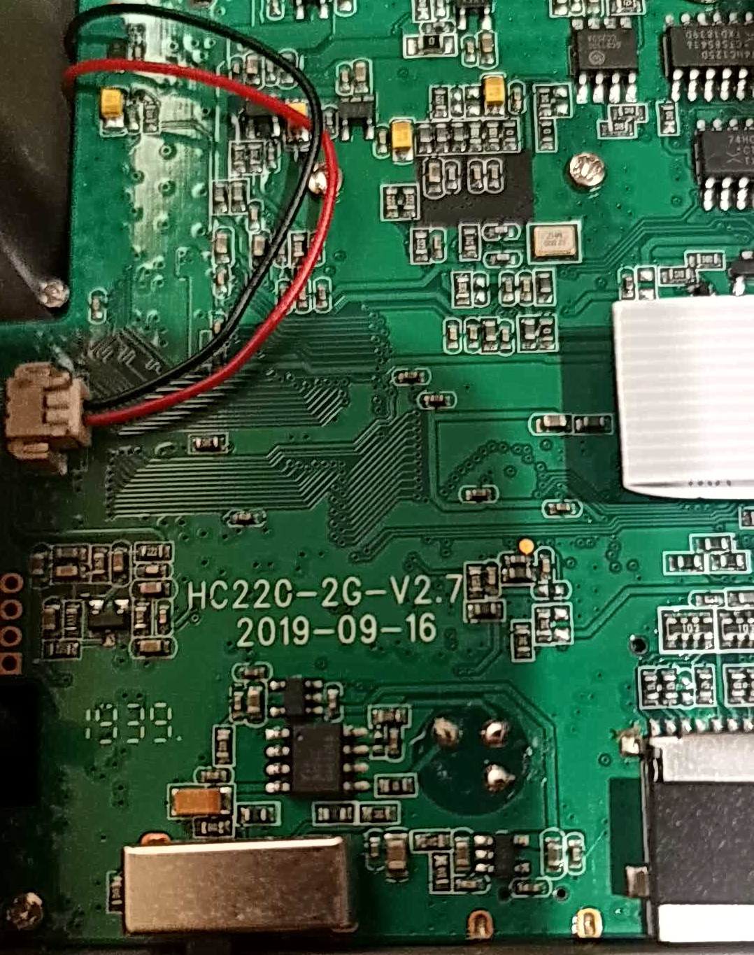

  • #50 21072444
    bobankop
    >>20317855
    Dear Sir/Madam, The camera model initially did not accept sending photos via the SMTP protocol, and after the new firmware it only shows a white image on the screen. Attached is a photo of the motherboard with the number. Please send me new firmware. Thank you!
    • HC-300M Firmware 2018/2019: Looking for Updated Version for HC-300M Trail Camera HC300M.jpg (505 KB) You must be logged in to download this attachment.
  • #51 21072894
    gradek83
    Posts: 9105
    Help: 929
    Rate: 2097
    bobankop wrote:
    >>21072444
    Call tech support and ask for firmware give them PCB no. "HC220-2G-V2.7 2019-09-16"
    Spoiler:
    support@cnsuntek.com

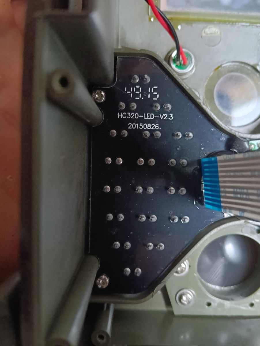

    ceobax
    >>20088093 imi puteti trimite si mie un firmware pentru un hc-300m pun poza acum
    Multumesc . Adresa de e-mail e ceobax(_at_)yahoo.it
    View of the interior of an electronic device with the model designation HC320-LED-V2.3 and a board with diodes.
