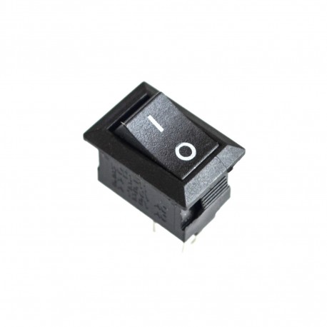

  • #11 18766478
    olekskin1121
    Posts: 10
    I added a microswitch on the back left side of the cable. Unfortunately I didn't take a photo but it looked like this:
    • Logitech Z533 Speakers: Remote Control Potentiometer Malfunction Post-Warranty wylacznik-on-off-117s-125v6a-czarny.jpg (14.54 KB) You must be logged in to download this attachment.

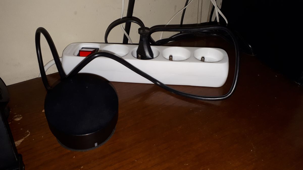

    #13 19034567
    SpanMan
    Minimal Shock wrote:
    thomasc wrote:
    Of course, the set is still under power, which I don't like, but tomorrow I'll add a switch on the power supply and it will be ok.
    Hey, thanks for your help, I did exactly as you did and it also works, tell me where you added this switch? is it going to be done with a potentiometer? If so, please advise, thank you in advance :)
    After making the "rude jumper", as in the posts above, I connected the speakers to the "rude" electrical divider with a switch. Simple and effective. It's just a matter of habit.
    Logitech Z533 Speakers: Remote Control Potentiometer Malfunction Post-Warranty Logitech Z533 Speakers: Remote Control Potentiometer Malfunction Post-Warranty
  • Bypassing the broken potentiometer switch with a jumper

Where should I add an external switch after bypassing the pod’s switch?
Users report success adding a small inline microswitch on the cable, mounted on the back left side of the pod. This provides a convenient and safe way to control power after the internal switch is bridged. [Elektroda, olekskin1121, post #18766483]

Use a power strip with its own on/off switch. One user bridged the internal switch and then controlled power at the strip: “Simple and effective.” This avoids opening the subwoofer or adding inline switches. [Elektroda, SpanMan, post #19034567]
