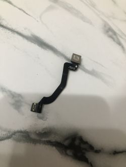

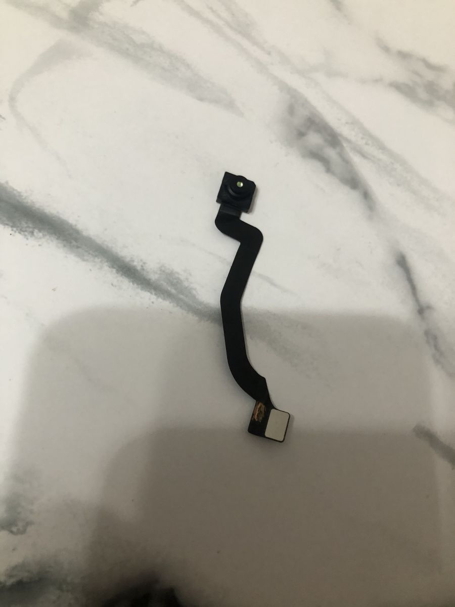

    Today I replaced the LCD in my iPhone
    Strangely enough, face ID doesn`t work on the old LCD either, I doubt I could have done anything with face ID because I didn`t even touch it.
    I only unplugged the LCD and the speaker module that is mounted on the LCD.
    I am asking for help and some advice.
    Thank you .

  • #8 18354499
    blahfff
    Level 42  
    Posts: 4972
    Help: 1036
    Rate: 1301
    Dawkobor wrote:
    So why doesn`t it work even on the old LCD?
    It doesn`t work because you probably somehow damaged the tape or one of the elements responsible for FaceID. Unfortunately, these tapes are quite delicate. "Programming" the display only affects TruTone functions.
  • #9 18354537
    Dawkobor
    Posts: 7

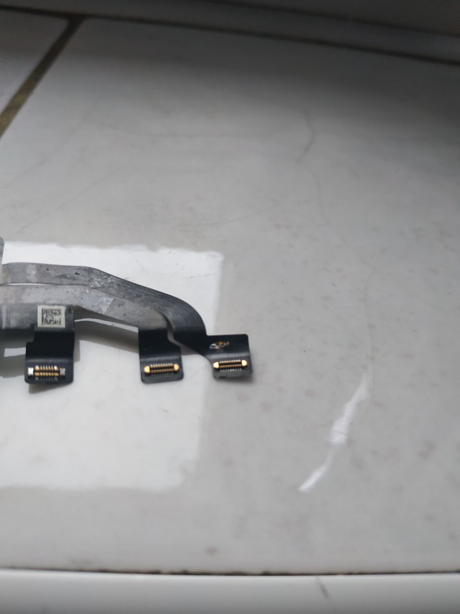

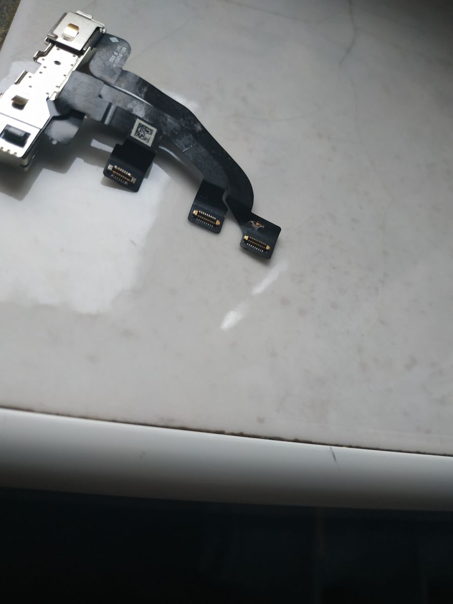

    Yes, the tape was slightly damaged, the service technician will try to solder it, but he doesn`t know what the paths look like and he is not sure about this operation. If it fails, it is possible to replace the entire Face ID with cameras so that Face ID works from another phone.?
  • #10 18354564
    blahfff
    Level 42  
    Posts: 4972
    Help: 1036
    Rate: 1301
    Dawkobor wrote:
    If this fails, it is possible to replace the entire Face ID with cameras so that Face ID works on another phone.?
    Unfortunately not. Only an authorized Apple service center can do this, including replacing the entire front. The situation is identical to that with TouchID.
  • #11 18357118
    Dawkobor
    Posts: 7
    Is it possible to change the face ID itself?

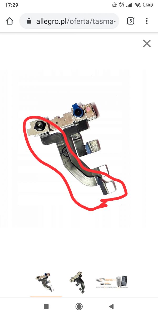

    The service technician suggested that I try to buy a new whole module and replace only the face ID tape, I marked it in the photo. He says that we can try this option because the cost of the entire face ID module used is PLN 70. Do you think it makes sense for fun? The cost of replacing the entire thing at an authorized service center is very high, he wanted to solder the flex tape for me, but he doesn`t have the appropriate equipment and he doesn`t know if it can be done at all, there would probably be 2-3 paths for soldering. iPhone X - No Face ID after replacing the display, what to do? iPhone X - No Face ID after replacing the display, what to do? iPhone X - No Face ID after replacing the display, what to do? iPhone X - No Face ID after replacing the display, what to do?
  • #13 18357292
    Dawkobor
    Posts: 7
    What elements should be transferred from face ID to the new tape? Could you explain this more?
    Added after 6 [minutes]:
    Do you know someone who could solder it for me?
  • #14 18357369
    blahfff
    Level 42  
    Posts: 4972
    Help: 1036
    Rate: 1301
    Everything is described and shown in the first link, including the video. Unfortunately, I cannot advise anyone who could deal with this.
  • #15 18358990
    RafalB
    Level 28  
    Posts: 1110
    Help: 91
    Rate: 222
    Unfortunately, 3 elements are responsible for the correct operation of FaceID and none of them can be damaged. The elements on the front cam assembly are very mechanically sensitive and there is basically no way to repair them. If the tape is damaged, it can be repaired or replaced (IR camera or dot projector) must remain original.

  • #16 18359979
    JacekJbk
    Posts: 23
    "I only unplugged the LCD and the speaker module that is mounted on the LCD."
    This "speaker module" is one of the elements of Face ID. It is very easy to damage it, and that`s probably what happened.

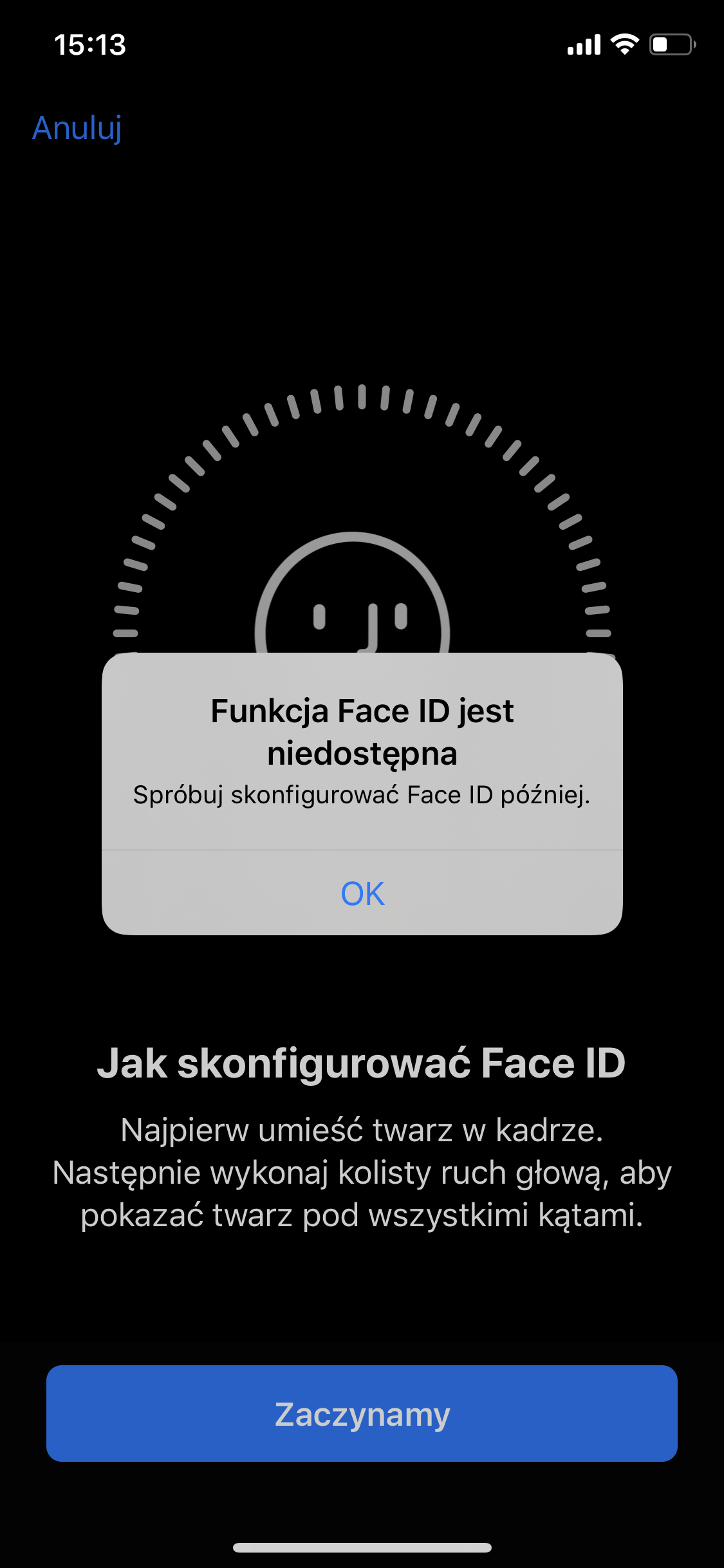

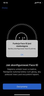

    iPhone X - No Face ID after replacing the display, what to do? iPhone X - No Face ID after replacing the display, what to do? Hello.
    This tape has been replaced and now it says Face ID is unavailable.
    Now I don`t know what could be wrong...
