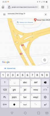

    Equal intersection - who and why takes precedence?
    Hello, if anyone can tell me.
    The intersection is at the exit from S1 to Jaworzno at the current Orlen station, road 79 is a priority road. Now, who has right-of-way when making a left turn? One vehicle wants to turn left from Route 79 and the other wants left onto Route 79 - their paths intersect so someone must be ahead of someone? I say the right-hand rule, and a friend who lives there says that we who turn left have the right of way over those who turn left from Route 79. Both turns are marked with Yield signs, both vertical and horizontal.

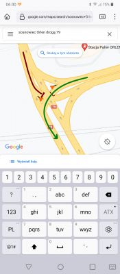

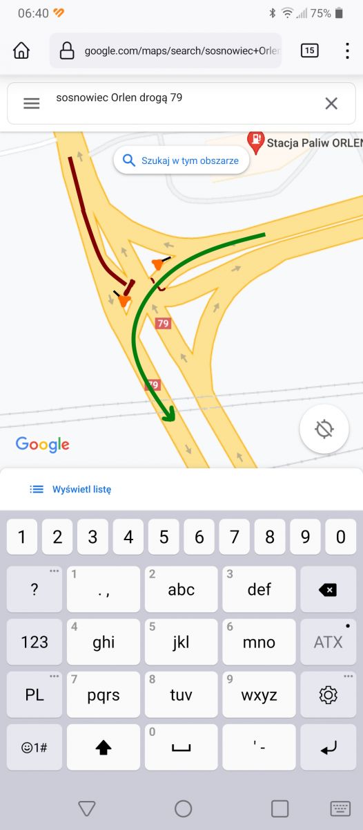

    luko1208 wrote:
    Both turns are marked with give-way signs, both vertical and horizontal.
    No, they're not "both".
    This is a multi-lane intersection and where the signs are placed is crucial.
    And so, for people turning left from the national road 79 to the connector to S1, the sign is placed in front of the lane for the opposite direction and also in front of the road for people turning left from the connector to DK79.
    For those turning left from the connector on DK79, the sign is in front of the main road for those coming from the left.
    Thus, a person turning left from DK79 is obliged to give way to both vehicles from the opposite direction on DK79 and vehicles turning left from the connector from S1.
    A person turning left from the S1 connector to DK79, after passing his A7 sign, has priority over those waiting for a left turn from DK79, because their A7 sign is in front of the road they are using.
    Simple and obvious.
    The right-hand rule applies only in the absence of other markings and signals, and your friend is right and understands the rules and road markings better.
