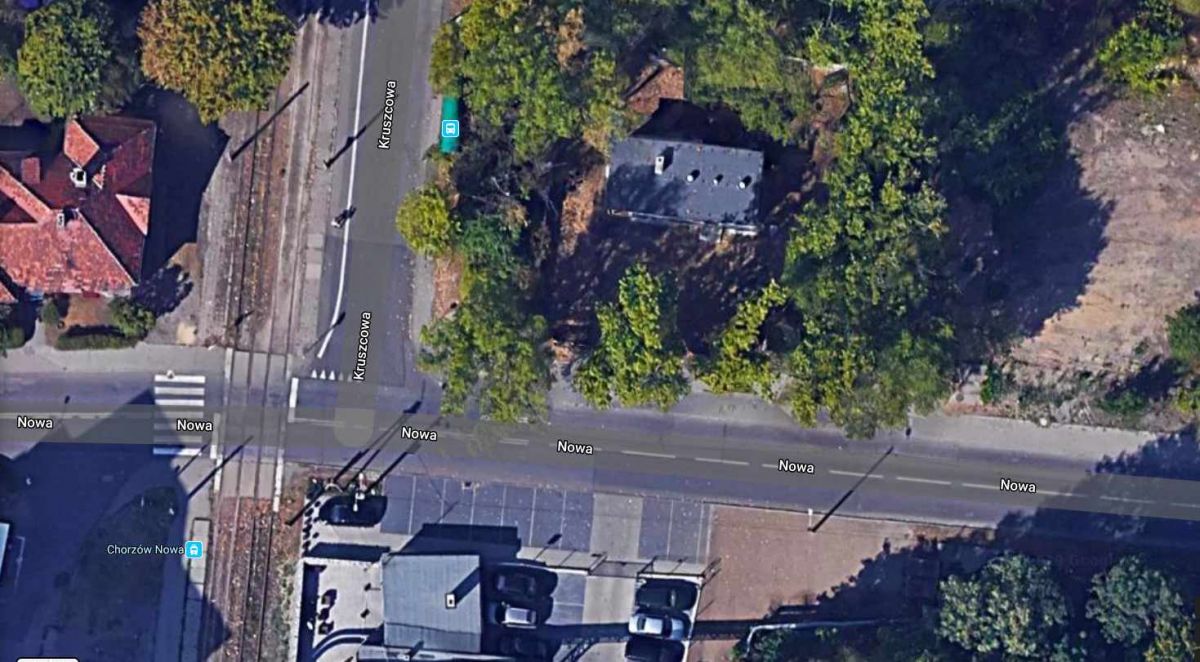

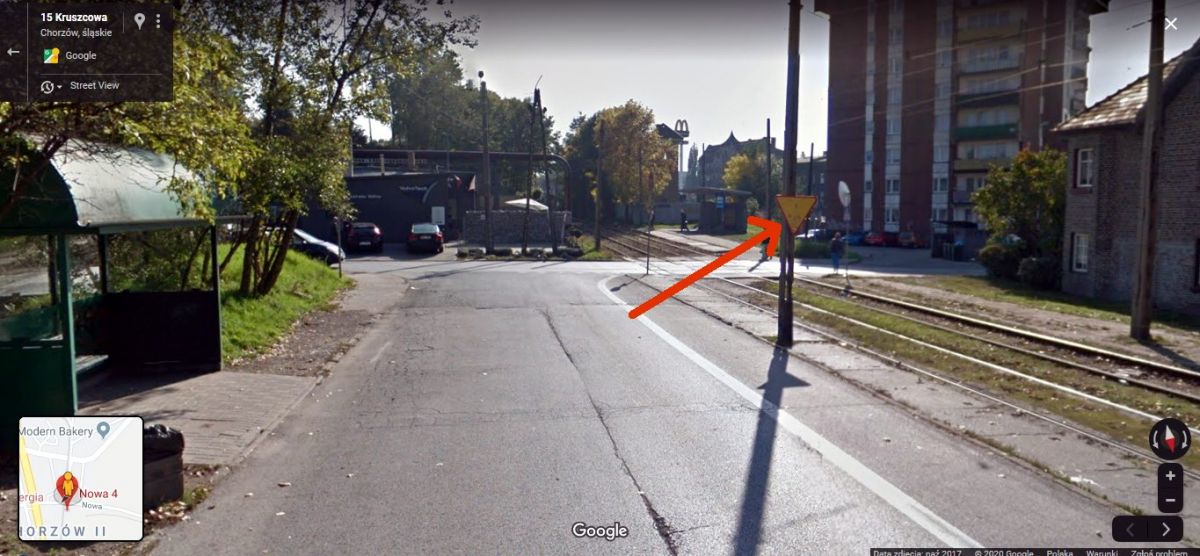

    Equal intersection - who and why takes precedence? A very similar intersection here, but also a tram ride. The signs are just a note tram and STOP.
    Suppose the tram is not running and the car layout is as in # 1. The intersection is relatively small. Next C takes precedence?
    Okay, you write that there is a STOP sign, probably it is not only valid selectively for trams? If this is probably true for all traffic?
    Enter the exact address and I will check what it looks like in street wiew.

    wojtek1234321 wrote:
    The STOP sign is to stop before the tram crossing.
    location

    MARCIN.SLASK wrote:
    The stop sign is to stop before the tram crossing.
    Well, indeed, but at this intersection on the transverse street there is also such a sign (arrow).
    So the situation is probably different than in post 1.
    It used to be like that. Now even this pole is not there. There is only STOP at the end.
    And with this vehicle C priority, I am afraid that at this intersection at my place it would be a tow truck every day. Here often A goes that even in front of the tracks it will not slow down, let alone pass others and stop at STOP. It improved anyway, because a few years ago there was 1-2 meetings with a tram every month, and now it was much less.
