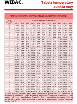

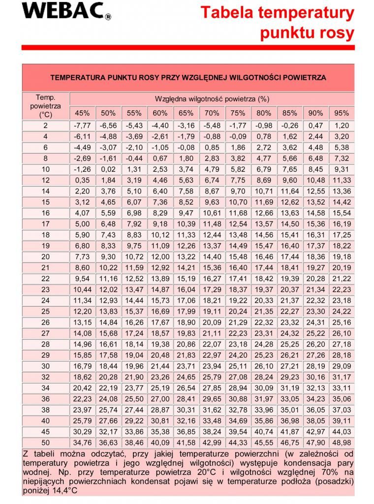

    Now back to the wall and the dew point.
    The wall is a partition between two media.
    One is the warm and very humid interior and the other is the very cold and very low humidity exterior. Between these centres there is a transfer of heat energy from the warmer to the cooler medium. But in addition, there is also the penetration of a large amount of moisture into the interior of the porous wall. The closer to the outside of the wall, the lower the temperature of this wall and the more the relative humidity of the air in the wall increases.
    Why do we need to give a thicker layer of insulation in the case of a warm wall?
    The reason is to ensure that the entire wall is at such a temperature that the dew point does not occur inside the wall. If a wall is insulated with polystyrene foam, the moisture will not escape through the wall. This moisture must return to the inside. But in order for the wall to return this moisture to the inside then the whole wall must have a temperature above the dew point.
    Below you have a table of dew points:
    Phoenix induction boiler for central heating and hot water + photovoltaic
    On the left you have the air temperature and at the top you have the relative humidity values at a certain temperature.
    Take for example a temperature of 20°C and a relative humidity of 60%. These are the values that most closely correspond to real life in a normal home.
    For this value the dew point will be reached when this air is reduced to a value of 12°C. If a wall has a high insulation value, heat penetrates this wall less easily. Then, underneath this 5cm polystyrene, the wall will reach e.g. 5°C. So the dew point will occur somewhere inside the wall and this water vapour will start to condense there. The wall will become wet. If the temperature outside drops even more, it turns out that the wall under the polystyrene foam may have e.g. not +5°C but -5°C, and then this water will freeze inside the wall.
    What can be done to get rid of the dew point inside the wall?
    1. Reduce the humidity by evaporating some of the moisture. Therefore, when using thin insulation, we should use insulation through which this moisture can be evaporated to the outside, e.g. mineral wool or open-cell (sprayed) PUR.
    In winter, when frost comes, the air outside becomes very dry. This is why such a wall dries out quickly, because the water evaporates due to the very low air humidity.
    2. Use vapour-impermeable insulation thick enough to ensure that the entire wall has a temperature above the dew point. Then the moisture will be given off to the interior when the relative humidity inside drops and the wall is saturated heavily with water vapour.
    If the wall is very porous and thick, there is no point in adding additional insulation, because it does not provide much in the way of thermal insulation. But if you want to use polystyrene foam, it has to be thick enough, and this no longer makes economic sense.

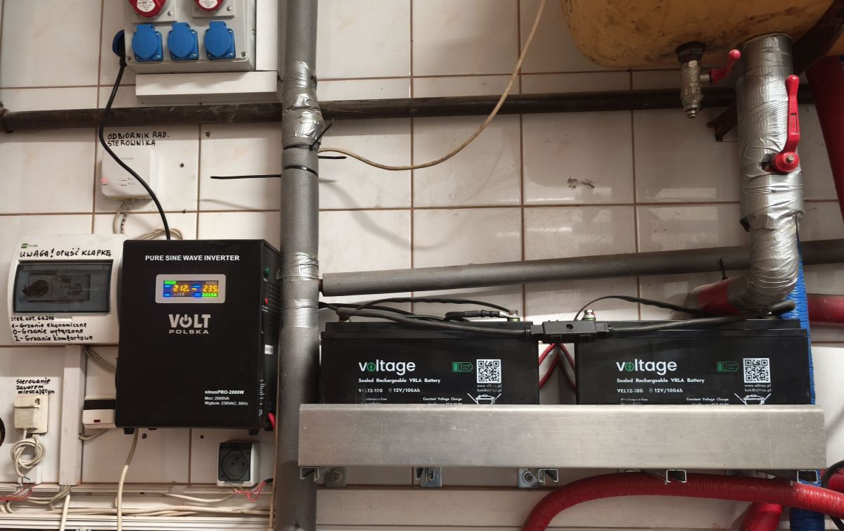

    It's not a question of the walls getting wet inside, because you don't notice the dampness there. If the polystyrene is too thin, the walls get wet, but on the outside, under the polystyrene, and that's where the fungus develops.
    If you have the possibility of connecting to the gas grid, don't even think about it.
    If you don't have such a possibility, install an air source heat pump with additional heaters in the buffer storage for bivalent support or a gas boiler powered by gas from a cylinder.
    If you have grid problems, then definitely install a heat pump + gas boiler tandem.
    You will power the gas boiler with an electrical inverter from the battery.
    In my village, we have an old mains power supply, so every strong wind, heavy rain or snowfall can deprive us of electricity for a whole day. Sometimes we have had problems for a week.
    These two sets: an inverter + two 12V 100Ah batteries power my gas boiler, automation (gate actuators), cameras, fridge, emergency lighting. They are able to keep the above-mentioned devices running 24 hours a day. If problems persist, a small generator for a few hours and the batteries are recharged.
    The inverters are powered via phase switches. If there is a phase failure, the set is automatically switched to the next operational phase.
    As far as the heat pump is concerned, I recommend Galmet. They have good compressors (Mitsubishi, Panasonic, Copeland) at a reasonable price.
    If it is a gas-fired boiler, I recommend ACV Kompakt because of its many advantages and the very fast conversion of the gas supply: natural gas from the mains, LPG from a cylinder, as well as gas with the addition of hydrogen to be introduced.
