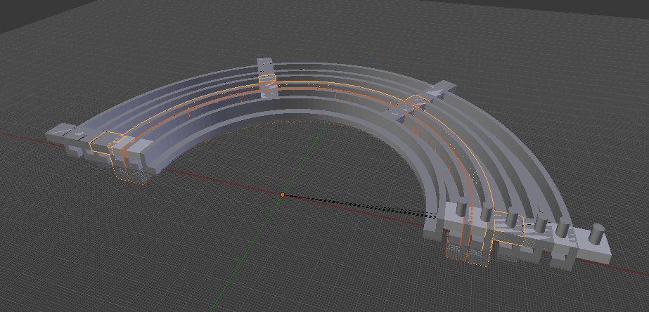

    I started the project by sizing the smallest of the lids:
    An idea for a practical 3D print for the kitchen - pot lid holder
    I designed the whole piece. There could have been fewer fixing holes, but I assumed that the whole thing should last quite a long time and, moreover, I already knew that for larger lid diameters I would print the parts divided into two halves:

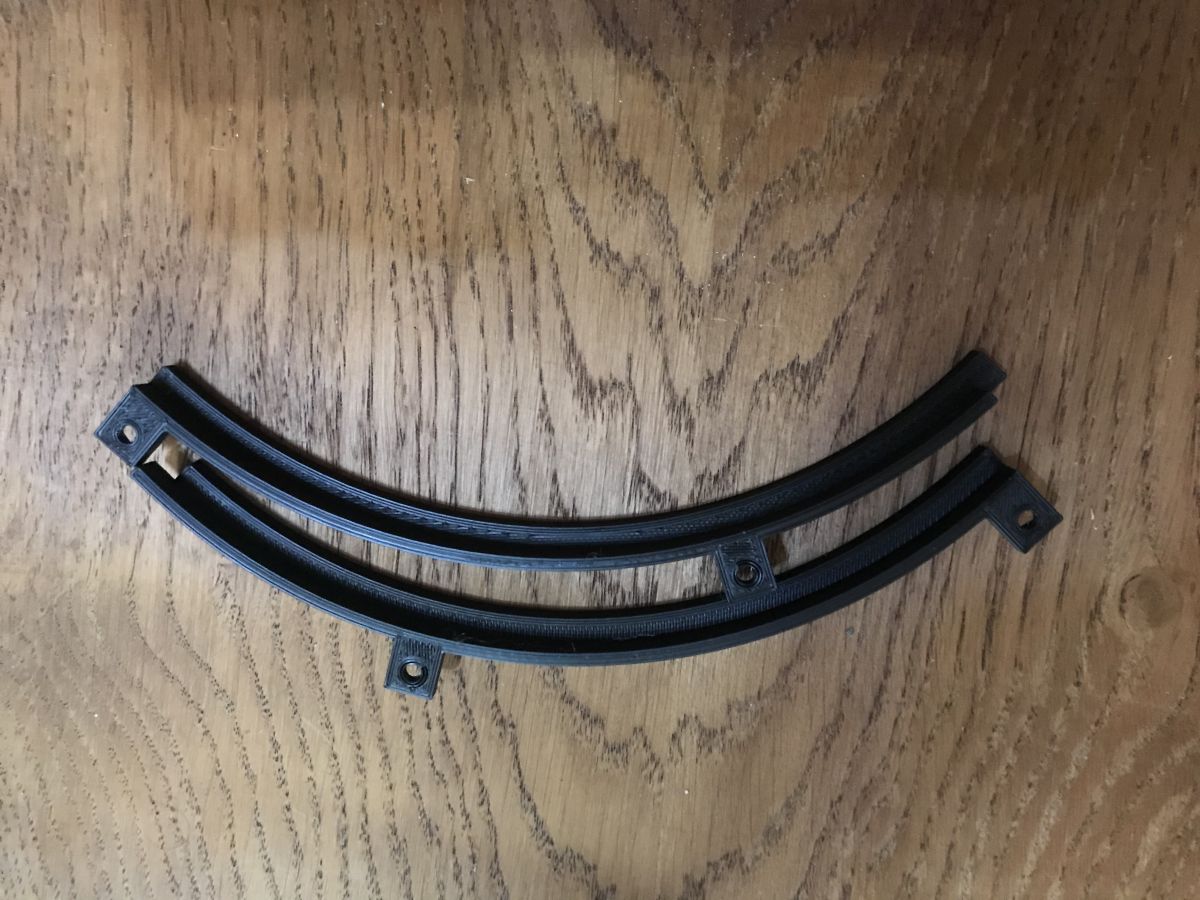

    I then started printing. I was then still using the nozzle 0.6mm and not as is usually the case 0.4mm , so it went quite quickly, about an hour and a half:
    First test of the printed piece with the lid:
    Everything came out reasonably well on the first try:
    The only change I made to the overall mounting scheme after the first print was to make it 1 mm deeper to make it more convenient to insert/remove the lid.

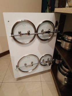

    Finished kit for the first cabinet:
    Final result (I did not choose the mounting location):
    The solution seen in the photo above has been in place for a month now and works very well.

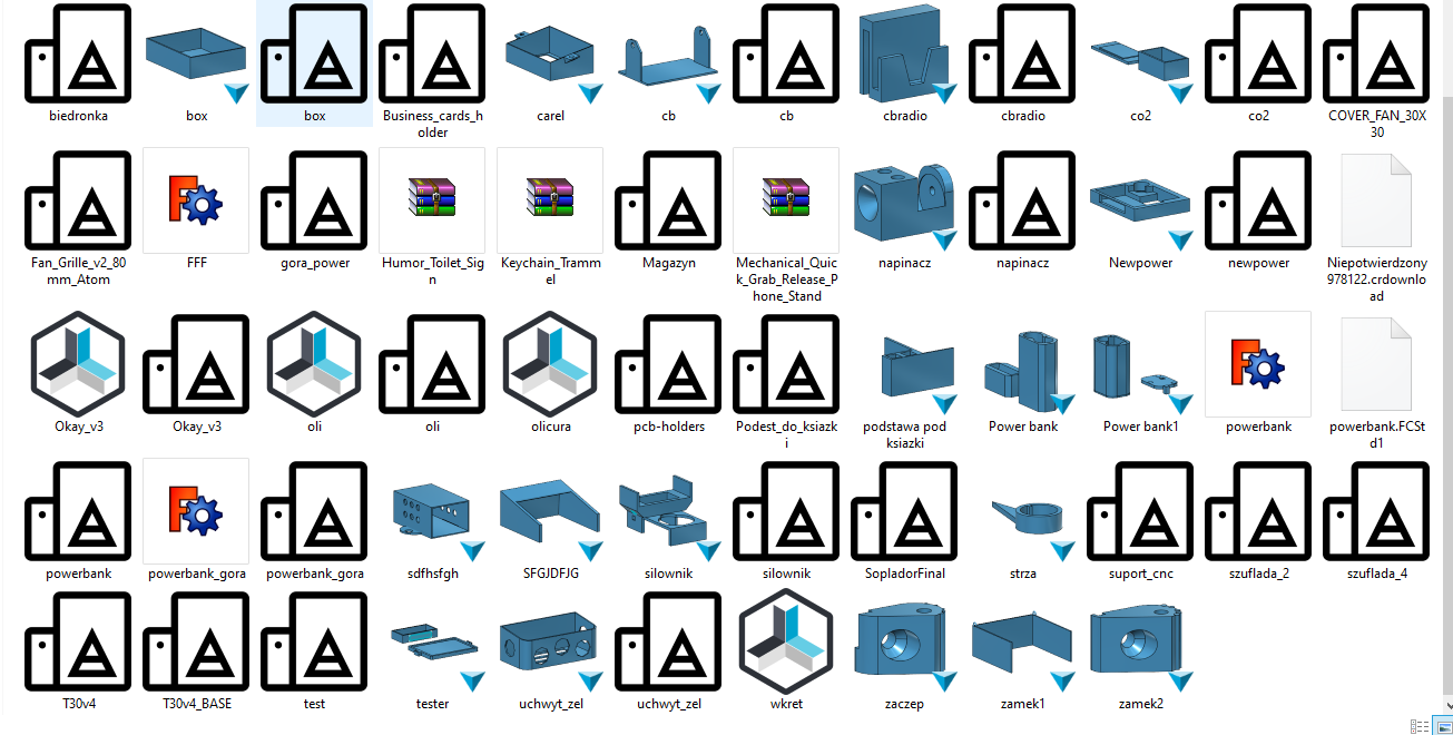

    I place here the .blend source file with all the mounts I printed.
    There are separate objects in it:
    - mounting_diam188 - 188mm diameter mount
    - mounting_diam170 - mount with a diameter of 170mm
    - mounting_diam210_a - 210mm diameter mount - half one
    - mounting_diam210_b - 210mm diameter mount - half two
    - itp. etc.
    The naming of the objects indicates their size, so that it would be easy to find what we are looking for.
    They should be exported to STL so that they can then be opened in Cura or another slicer.
    Of course, we export each object separately - only the one that interests us at the moment.

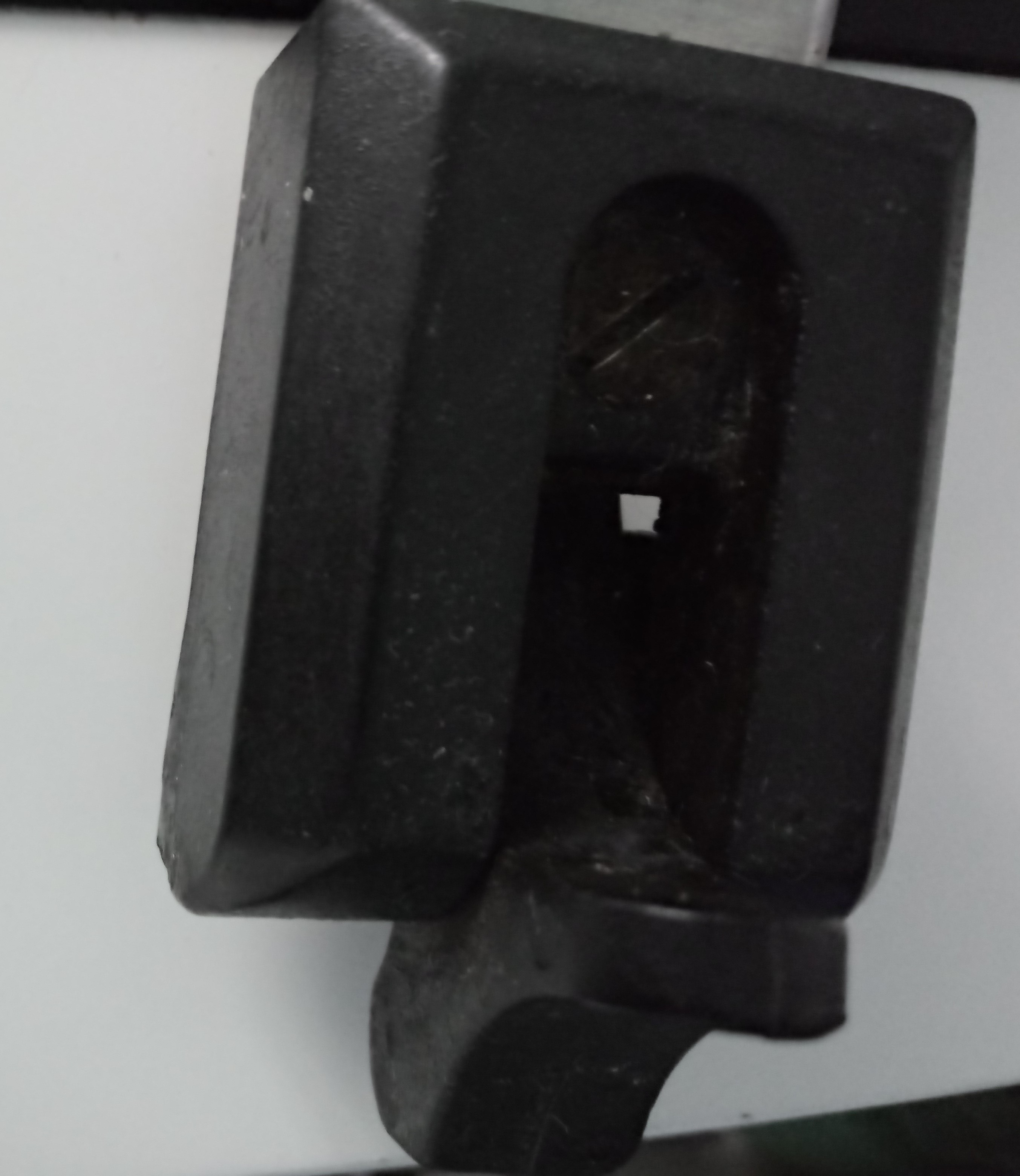

    Cool stuff you guys are making. Maybe someone has the willingness, the time, to make me a part of the handle for the pressure cooker for a fee or for a friendly rematch. The pressure cooker is an old type, KUKTA, Hungarian from the '80s and the part, now, is not available for purchase and I could use it. I'm not going to buy the whole pressure cooker because it's quite a big expense where there's a chance to make it. I will send, if anything, the damaged part, at my own expense, of course.

    This is where an ordinary 3D printer with filament will not work - such prints are not temperature resistant
