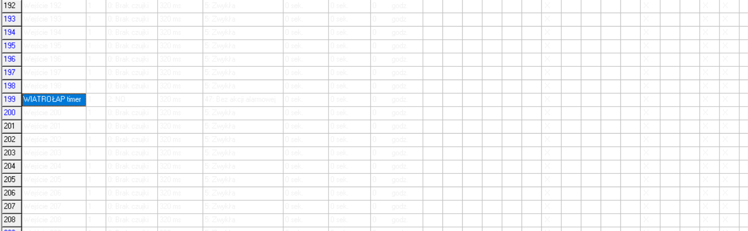

    I want to get down to the more complicated functions on my SATEL and I have a problem such that all non-physical inputs are greyed out in DLOADX. It's hard to operate this because the colour is very bright and you can hardly see anything.
    For outputs, only those with the line type marked as unused are greyed out and here there is no problem.
    Any BUG in this version of the program? DLOADX version 1.19.001.
    SATEL DLOADX v1.19.001 - How to unblock grayed-out virtual inputs? .

    It's not a bug. Set the type to according to the output and the whole line will be nicely blackened.
