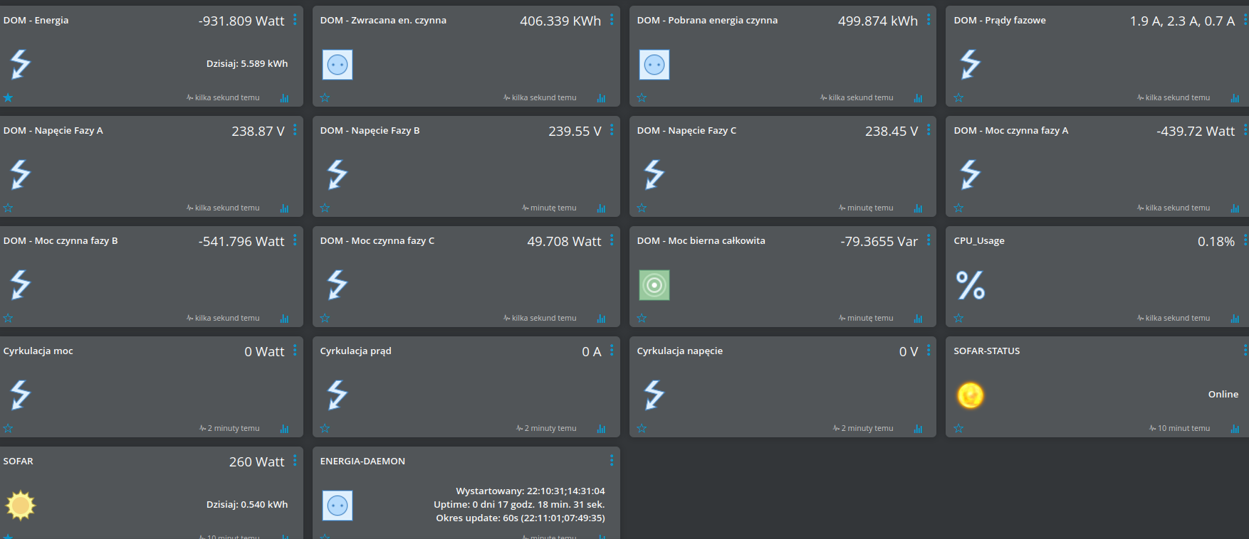

  • #33 20262265
    witekp04
    Everything xury wrote is true. Remember, however, that Node-RED is quite substantial software, it acts as an integrator of both streaming devices and synchronous APIs, so Domoticz can be easily used in it. Due to its size, I avoid using it at home.
    I have MEW-01 myself and switched to the local MQTT yesterday. I just wrote a simple daemon that uses Net::MQTT::Simple (for fetching topics), LWP::UserAgent (for API domoticz support) - I use Perl. In fact, in any modern scripting language, it can be done - a bit of self-denial :) . The daemon itself, despite the fact that the MEW threads are constantly updated and the MQTT server almost only receives the stream from it almost all the time, takes little mW of power needed to power the raspberry. I have acquired the daemon's textual status to observe it for a while. The result is this.
    Zamel MEW-01 Energy Meter: Alternative Software, ESP8266 System, Supla & Local Server
