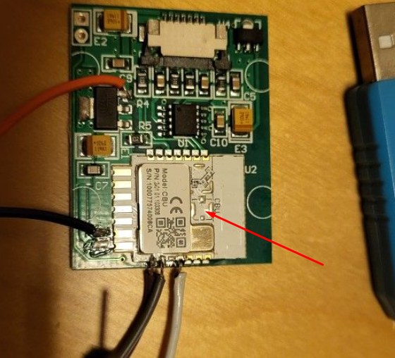

    thanks for the post and information.
    I'm trying to flash the module but it always fails with "Cannot get Bus." I tried many many times with different CEN to GND time but can't get it working. Did you cut any lines for flashing? Any tips?
    My 3.3V USB to Serial is working with my Orange Pi. The 5V on the Low Drop Regulator is directly connected to 5V USB and the CBU has it's 3.3V supply, when the USB is connected. The diode on the backside flashes slightly one time when connecting the USB.
    [BK7231N / CBU] PZIOT-E01 DIN rail pass-through energy meter
    ./uartprogram OpenBK7231N_QIO_1.15.453.bin --unprotect -d /dev/ttyUSB0 -w --startaddr 0x0
    UartDownloader....
    programm....
    Cannot get bus. : |                                                  |[    ?k/s]

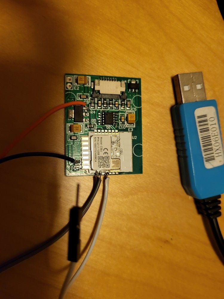

    I didn't connect the 5V, I flashed with 3.3V directly to the wifi module. I find I usually have more success when as little of the surrounding electronics are powered as possible.
    I did not use the CEN technique, I've tried many times and that never works for me. I always control the power. Also, one less thing to solder.
    So I run the command, then supply power. If it doesn't work immediately, power off, Ctrl-C, run the command again, and power on again until it works. I often need to do this 2-3 times before it works. There's a timing thing; the flashing software needs to probe during a very short moment during boot-up.

    I borrowed a FT2232H Mini Module from work. Connected everything, double cheking TX to RX and vise versa as usual. Still no success. Not even with RTS connected to CEN.
    What makes me nervous is, that the CBU pin 15 = TXD has almost 0V, the CBU pin 16 RXD has 3.3 V, but the FDTI TXD has 3.3V and the RXD has 2.3V. I thought TXD in idle should have 3.3V, and it looks like I'm connecting two TXDs. But maybe the pins just get a different function on runtime.
    Only one time from many many tries i got a bit further:
    UartDownloader....
    Read Getting Bus...
    Gotten Bus...
    Set baudrate failed
    But as I cannot flash it with this one my hope for the USB to TTL you are using is quite low.

    Digga
    Posts: 32
    I got it to work. Thanks for your support!
    1. My old serial adapter with 5V from USB to onboard LDO did not work
    2. My old serial adapter with 3.3V from external LDO powered by 5V USB did not work
    3. FTDI serial adapter with internal 3.3V LDO, which can do 150mA did not work
    4. The adapter you use with 3.3V from external LDO powered by 5V USB did not work
    5. The adapter you use with lab power supply did it!!!
    I think there was a voltage drop on the power supply and therefore flashing was not possible. I tried laptop and desktop USB...

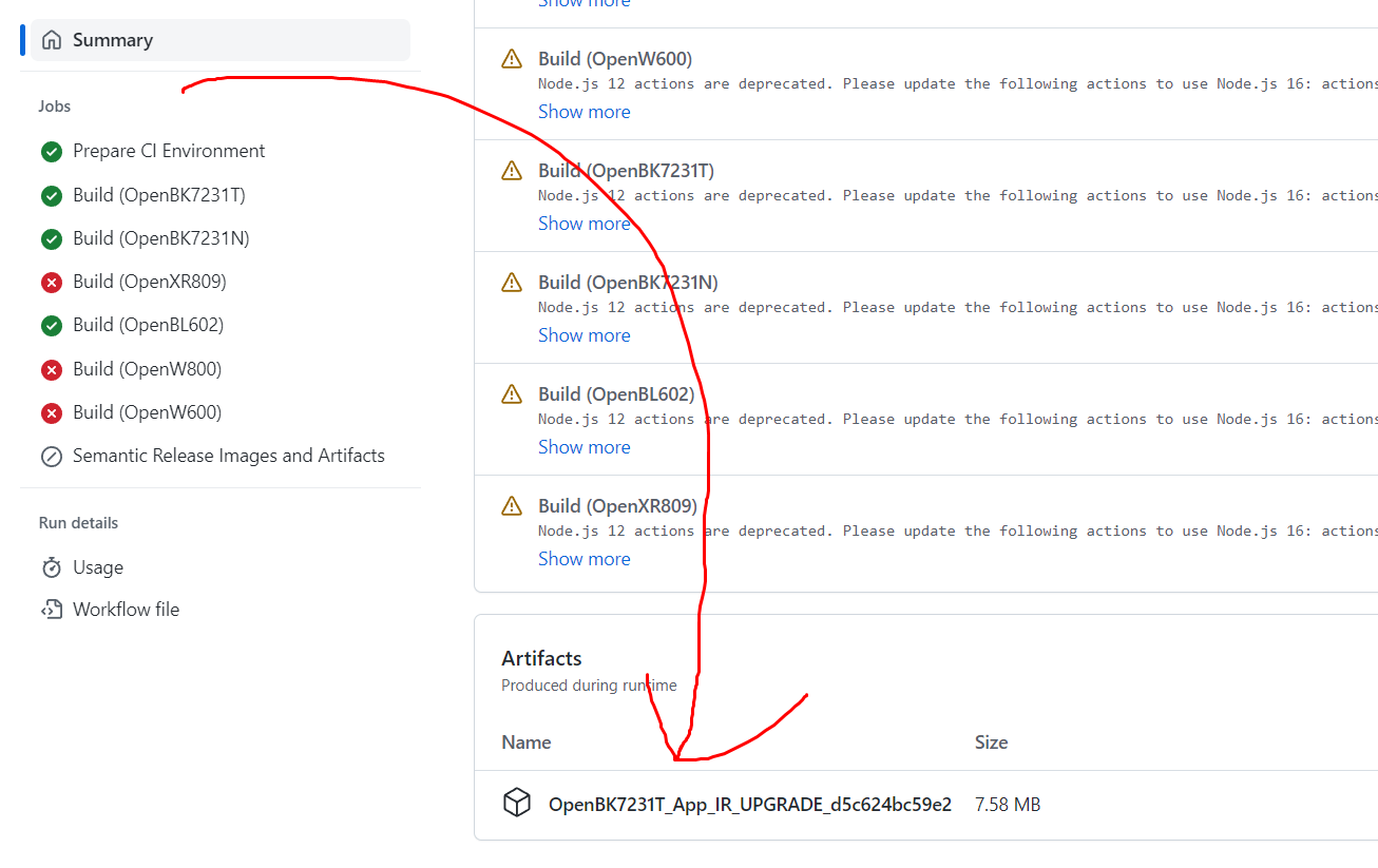

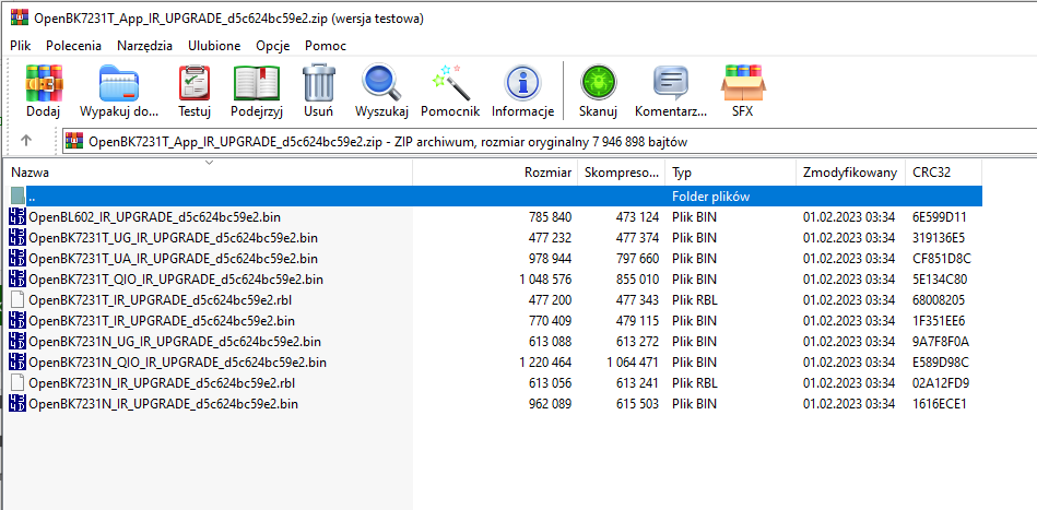

    @Digga remember that our online builds are working even in pull requests, so you don't have to setup anything to get binaries.
    We also support Docker build:

    Well, if you fork repository ,you will also get builds working, even without "poluting" the PRs.
    For example, like that user, doing IR stuff:
    https://github.com/vfonov/OpenBK7231T_App/tree/IR_UPGRADE
    If you go to the run:
    https://github.com/vfonov/OpenBK7231T_App/actions/runs/4060663402
    And look down here:
    you will get that file:
    Everything is built online. Very easy and quick for testing.

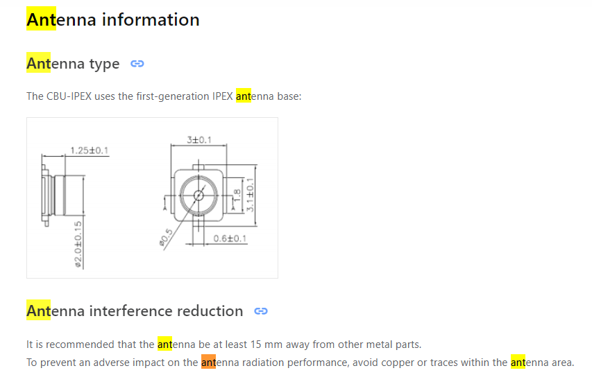

  • Adding a wire antenna to extend CBU range
    #27 20465971
    smoku83
    Posts: 23
    Rate: 7
    Yesterday I received this device and after connecting it, it turned out that the wifi range is lost, because the electrical box is 50m away from the building with wifi. I know that you are dealing with something else in this topic, but I want to ask if you can solder an antenna to the CBU somewhere in the form of a few centimeters of copper wire to increase the range a bit, if so, where? Thanks
    Regards
  • #28 20466116

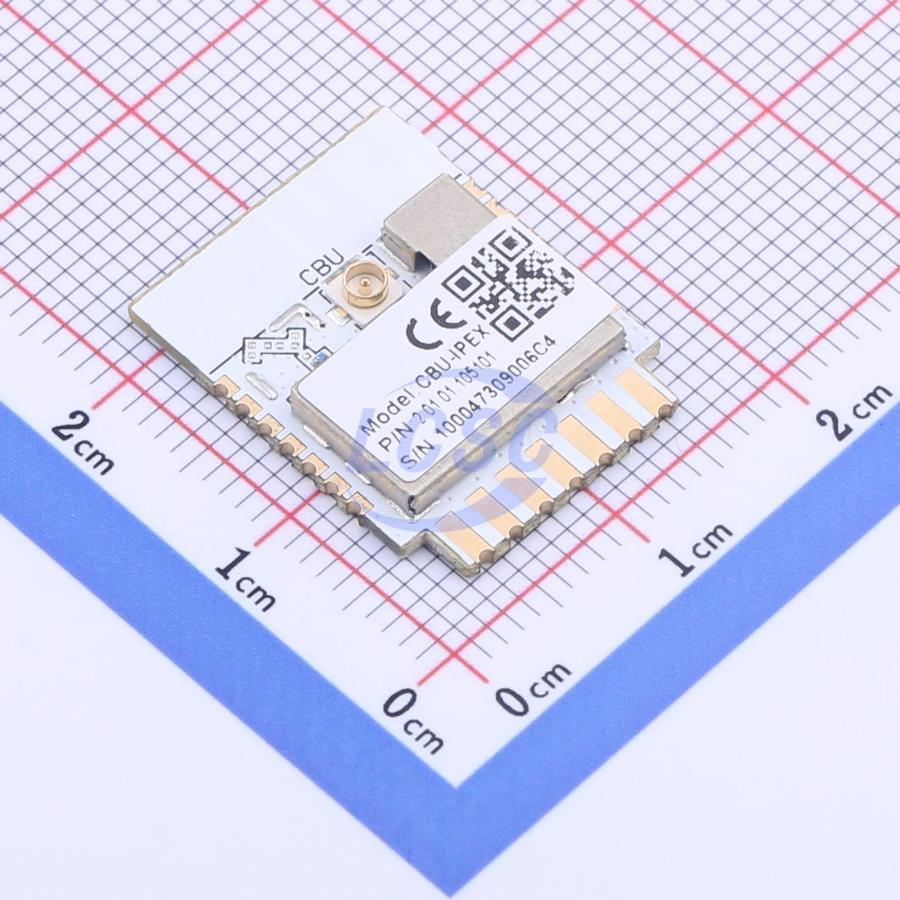

    Posts: 14754
    Rate: 12876
    I'm afraid that only CBU-IPEX has a connector for a mini antenna, but I don't think it will help at 50m anyway...
    A regular CBU has only a pad in this place, there is no soldered connector ....
  • #29 20466928
    smoku83
    Posts: 23
    Rate: 7
    Great really thanks a lot
    Regards
