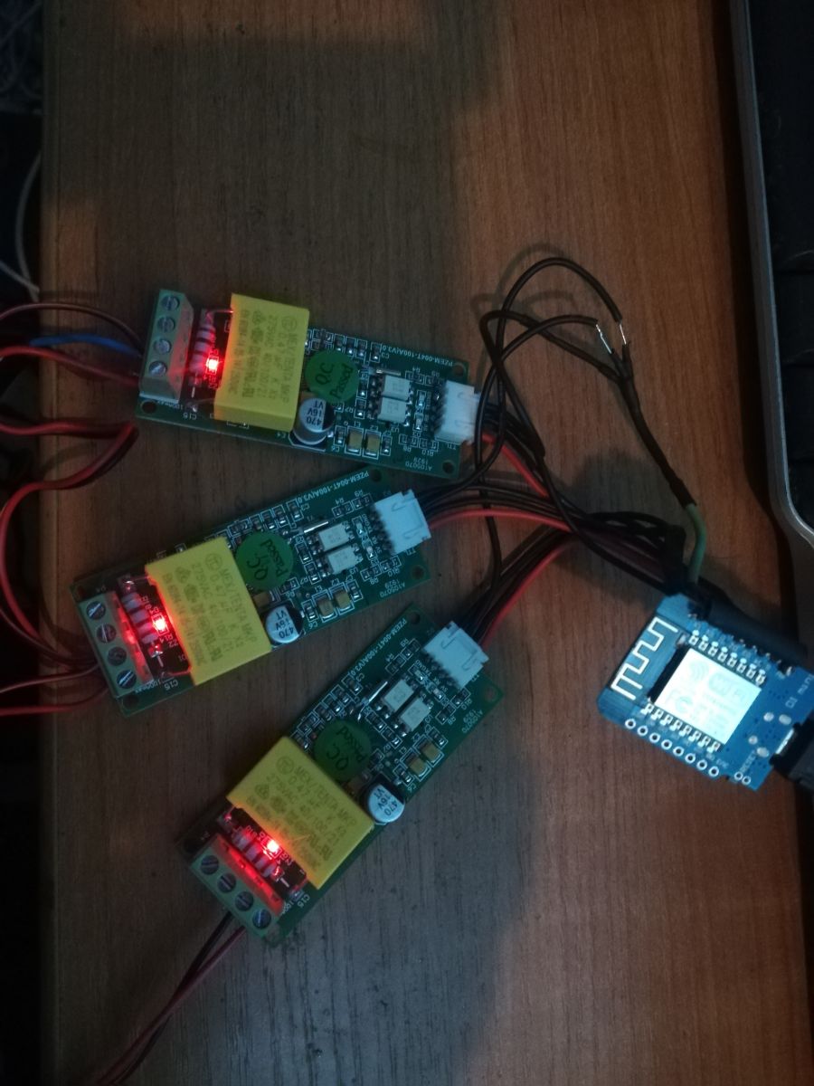

    Yes, there is no wi-fi. The module itself communicates via UART with ESP8266. It may even be ESP-01
    I recommend version 3.0 because it works well on LVTTL and has flashing LEDs where you can immediately see if there is communication. Previous versions had to be slightly modified. So change the resistors on optocouplers.
    In addition, version 3.0 shows the frequency of the network.
    It is connected simply: rx-tx tx-rx mass and 3.3V power supply. With more PZEM-004 connected to one UART, you need to give the BAT45 diodes according to the diagram somewhere on the github. When I find it.
    The basic configuration is to paste the following line into the template configuration:
    For version 3.0 it will be:
    {"NAME": "HW-655 PZEM", "GPIO": [0.62.0.98.0.0.0.0.0.0.0.0.0], "FLAG": 0, "BASE": 1}
    Or manual selection in the configuration of the generic module in Tasmota.
    Thanks to PZEM-004T we get readings:
    Voltage, current, active, reactive, apparent power and cos phi. In addition, it counts the kilowatt hours today and total. After mqtt we send ourselves wherever we want.
    How would I help you.
    This is what it looks like. It's an older version that doesn't show the frequency.

    Yes, that's this drawing. When the connection of many on one UART was just beginning and there were problems, I did on three separate ESP-01. It works fine now. But ESP-01 are cheap so I got used to it and I still do.
    Of important things, for the readings to be correct, the PZEM power supply must be from the same phase on which the current transformer is placed. Otherwise the indications of power and cos phi are incorrect. Obvious obviousness, but I was deeply surprised to see cos phi at 0.2.
    And this is an example of data sent to Influxdb and displayed in Grafana:

    Ok, to be precise, the PZEM-004 has two power supplies. One main via AC terminals which also measures voltage and phase shift angle. The second power supply is a low-voltage power supply only for optoisolation systems.
    By making three plays side by side, we have to supply each piece from a different phase. Then we put the current transformer on the same phase as it is connected to the AC terminal. From the low voltage side, it does not matter, because it only supplies optocouplers. I power them from a common 3.3V power supply from which I power all PZEMs and ESP8266.

    Also remember to connect three PZEM-004 to one UART, you must first connect each one separately and set each other address. Only when each of them has its own address can they be fastened together.
