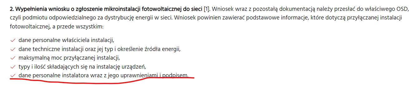

    Maybe I misspelled it, but my point was that when you do the report to the EC, there is a point like the installer's statement and at this point there is such a matter as "Declaration that I have the authorization to perform the micro-installation covered by this report:", i.e. if you do not have the rights you will he needed a person with such powers.
    Do you understand written text? The fact that there is a column DOES NOT MEAN THAT IT MUST BE FILLED IN. Just because there is a place for "X" DOES NOT MEAN THAT YOU NEED TO INSERT IT.
    Laws and regulations constitute law in Poland and not a private company form.

  • DSO application must be signed by qualified installer
    #38 19026579
    toolpusher
    Posts: 799
    Help: 35
    Rate: 210
    To report to the DSO, you need the authorizations from what your colleagues write, eg E. So the application to the DSO must be signed by a person who has qualifications.
    As for the "my current" program, you only select self-assembly and that's it. The fund does not check this at the stage of submitting the application, although in the definition of the fund, self-assembly is assembly on a property whose owner has the appropriate permissions.

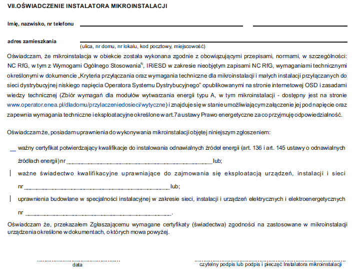

    By the way... Can I connect such an installation only to the meter/connection that is in my name or can I also help, for example, at my parents' place? Of course, I mean bureaucracy because, as I mentioned above, I only have SEPs (our supplier is ENERGA).
    Added after 16 [minutes]:
    Screenshot of a regulation point regarding the application for connecting a photovoltaic micro-installation to the grid.
    I found this point in the regulations.

    People wrote here on the forum that with only the simplest SEP they had no problems with accepting the application. But it is not known whether all ZEs treat it the same way. This quote does not indicate what specific permissions these should be, so by default, basic permissions should be enough.
