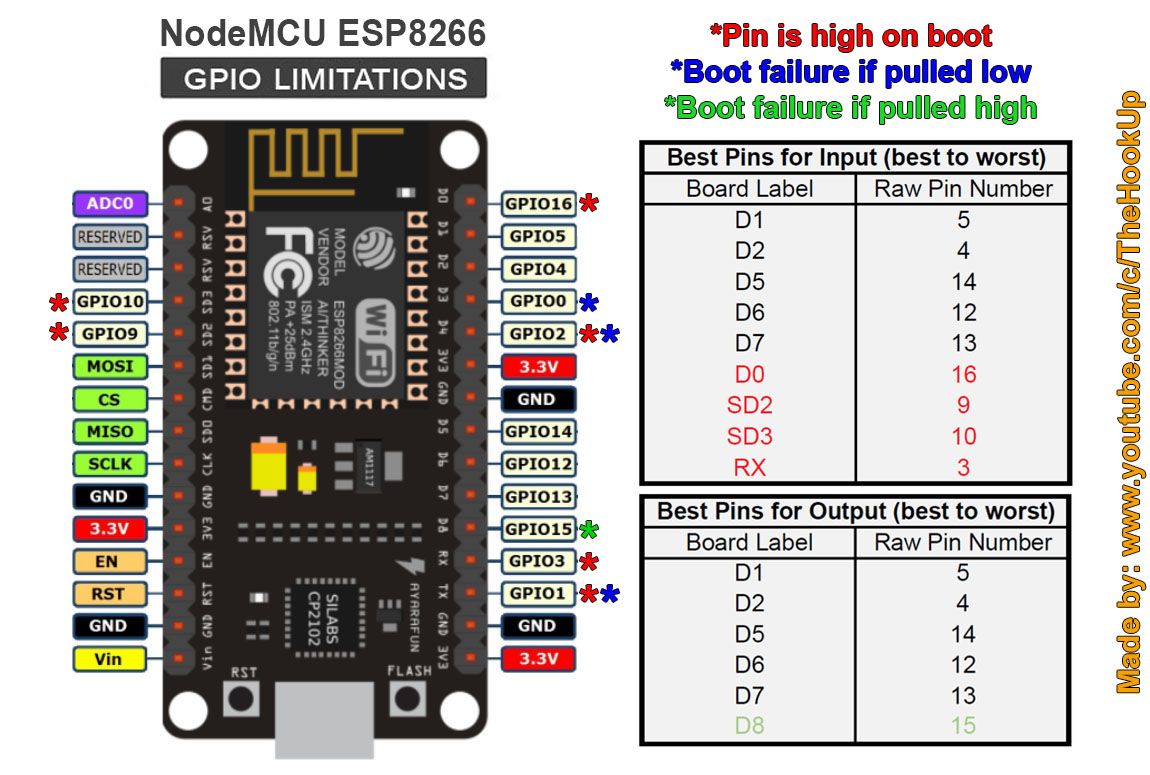

    Perhaps this will direct you:
    ESP-07- The programme only works when the board is connected via a converter to USB. .
