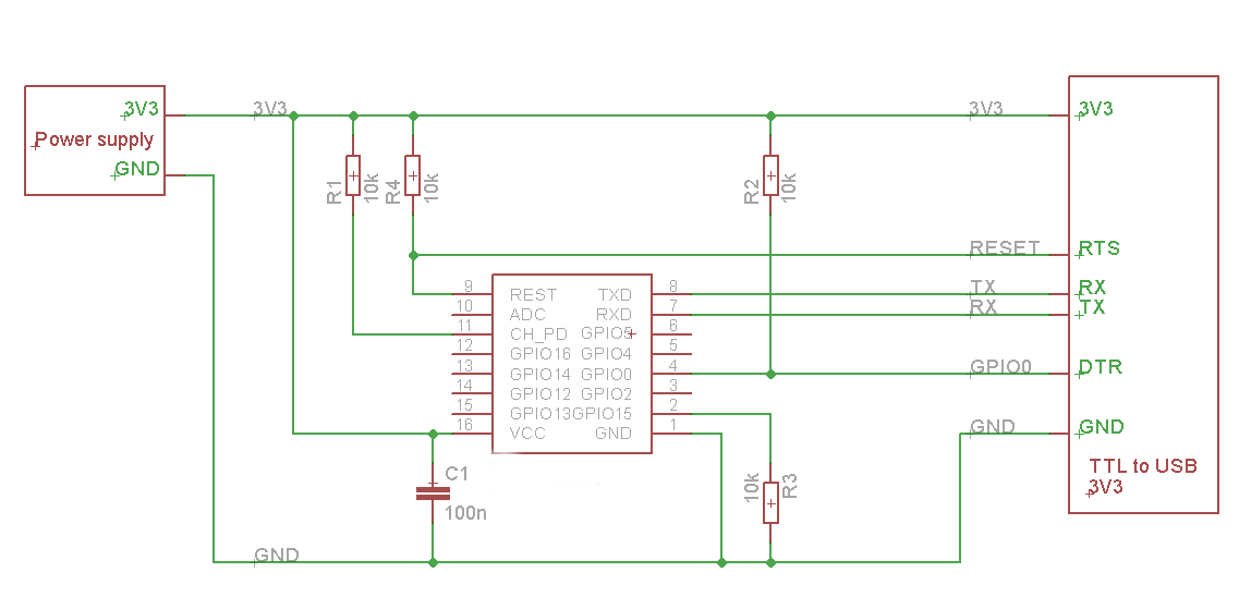

    khoam wrote:
    Do you have the REST and EN (CH_PD) pins connected via a resistor to 3V3?
    Yes I have these pins connected via 10K resistors to 3.3V.
    mmaker wrote:
    GPIO15 should be connected to ground all the time through a 10k resistor, not just during firmware upload. GPIO0 should be shorted to GND during upload.
    GPIO15 I have connected to GND permanently but without resistor. GPIO0 I have via a 10K resistor to 3.3V and directly from GPIO I have a small switch connected to GND
    I enter UART programming mode by short-circuiting GPIO 0 to GND and applying power to the ESP, both LEDs light up then and something tells me the blue one should be flashing....

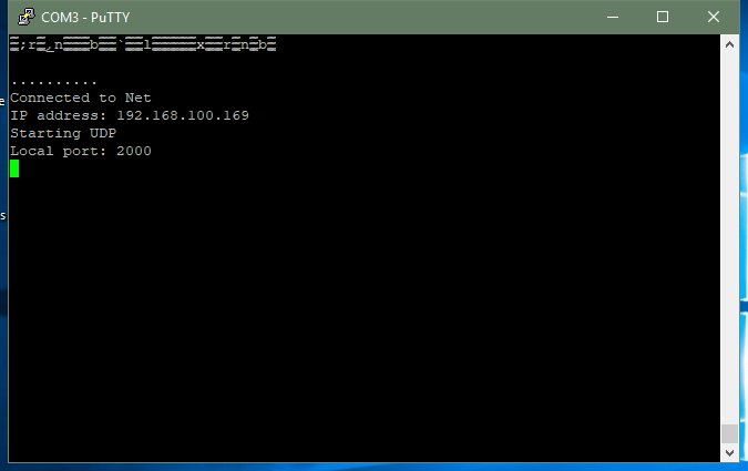

    Hmm actually I can't remember if I managed to apply 5V to any of the pins because the board only has the pins needed for UART transmission and programming connected, the rest is not connected and as far as I can remember everything worked as expected until the very end. I have TX and RX connected OK because when starting the previous skit with ESP on Putty I have:
    ESP-07 does not respond to flashing - what could be the reasons? .
    Connecting the second module I have UART -> WIFI -> UART communication between them.

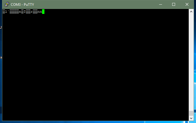

    If I short-circuit the GPIO0 pin to GND and apply power to the module then I receive bushes sent by the module continuously - Putty at 115200 baud
    any other setting of other BAUD gives the same results and this on both modules :) I don't know what else I could be doing wrong

    Of the many ESP8266 ac I have found the ESP-07 to be dead, you may have just experienced this. It stopped programming a year ago, but there are messages to let you know, and it's not like nothing is happening. It uploads, it uploads, then the errors and error message fly (Arduino + core 2.5 + full messages enabled while compiling and uploading). I tried again last week and ONCE managed to upload the blink at 9600 speed, but the rest are failures.
    Buy yourself a board for 2PLN for the ESP8266, or make some connections yourself 15 through a 10k resistor to GND, 0 10K to VCC, CH_PD 10k to VCC, RST 10k to VCC, you can apply voltage by holding the button and shorting 0 to GND or having the chip already powered up you do RST while holding GPIO0 shorted to GND. Enable full messaging when uploading and retype the text the Arduino throws out.

    Hello Gentlemen, a foolish man was born and I think a foolish man will remain. I apologise in advance for the confusion and admit my mistake. I swore that everything was ok in the connections but it wasn't! I looked at the PCB adapter pattern on the computer 5 or 6 times, I even checked the connections to see if everything was ok and it turned out that it wasn't ok and that was from the beginning.... And today freshly I look at the PDF, cycle and there it is, everything works. The cause was shorting to GND the wrong GPIO to ground. Forgive me the error :cry: .
