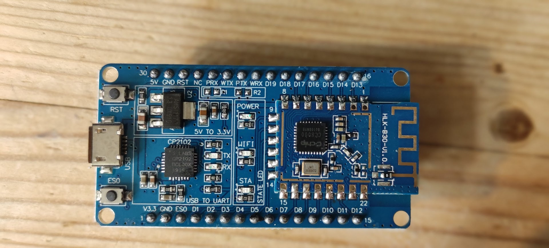

    HLK-B30 pinout and SPI flashing map
    #1 21586747
    Posts: 5220
    Help: 448
    Rate: 917

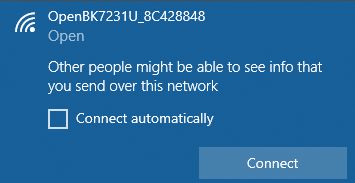

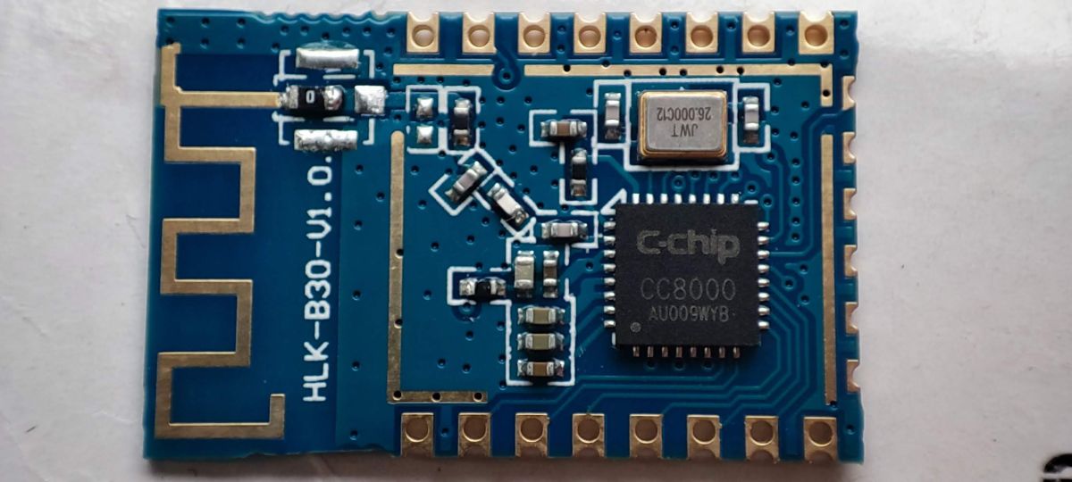

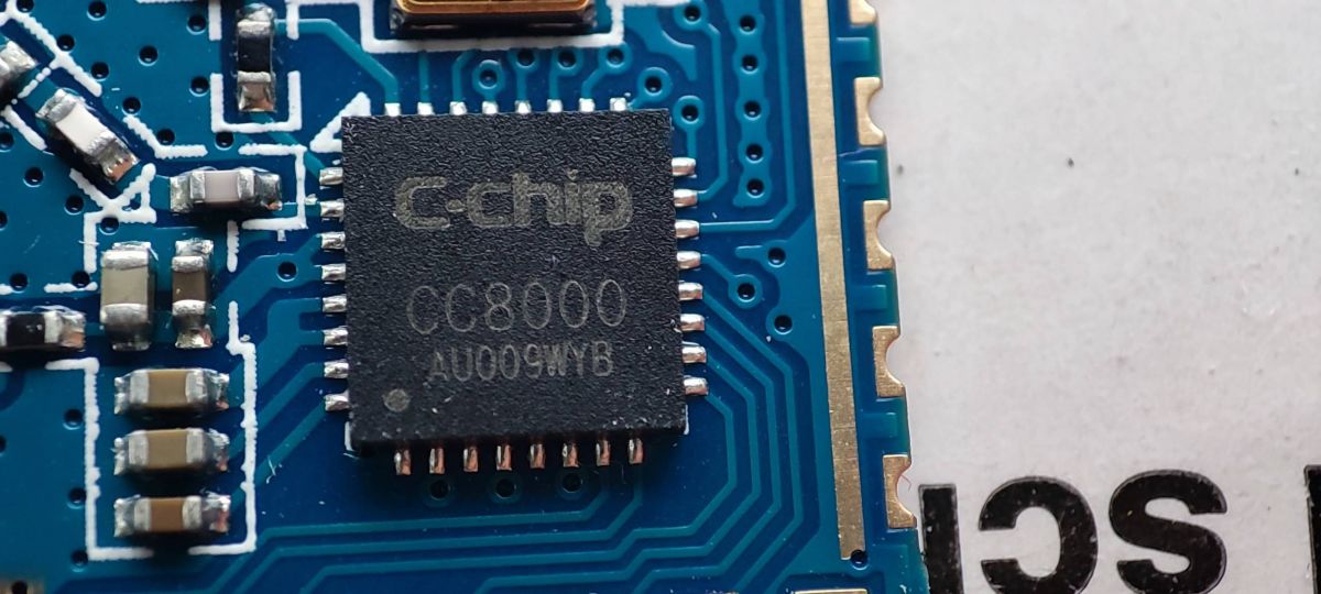

    There are a few posts around that reference the C-Chip CC8000/BK7231U chip and that it can be found on the Hi-Link HLK-B30 development board, but experiments with it appear mixed in with several other threads, so here's a thread dedicated to the HLK-B30 and now with OpenBK7231U.
    Hi-Link HLK-B30 Development Board with C-Chip CC8000 and OpenBK7231U Firmware
    Hi-Link HLK-B30 Development Board with C-Chip CC8000 and OpenBK7231U Firmware Hi-Link HLK-B30 Development Board with C-Chip CC8000 and OpenBK7231U Firmware Hi-Link HLK-B30 Development Board with C-Chip CC8000 and OpenBK7231U Firmware

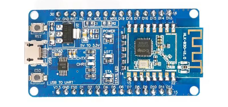

    PinPin NameTypeDescriptions
    1CENIChip enabled, highly effective
    2P26_PWM5I/OP26,PWM5
    3P24_PWM4I/OP24,PWM4
    4P23_TDO_F_S0I/OP23,ADC3
    5P22_TDI_F_SII/OES0, enter at command mode / restore factorysettings, please pull up if not used, same as P28
    6P21_TMS_F_CSI/OP21
    7P20_TCK_F_SCI/OP20
    8VBATP3.3V power supply
    9P28I/OEnter at command mode / restore factory settings, please pull up if not in use, same as P22
    10P16I/OP16
    11P17I/OP17
    12P14I/OP14
    13P15I/OP15
    14P6_PWM0I/OP6,PWM0
    15GNDPGND
    16P7_PWM1I/OP7,PWM1
    17P8_PWM2I/OWiFi indicator light
    18P9_PWM3I/OP9,PWM3
    19P1_URAT2_RXDI/OP1,UART2
    20P0_UART2_TXDI/OP0,UART2
    21P10_UART1_RXDI/OP10,UART1, For upgrading, command settingand transparent transmission
    22P11_UART1_TXDI/OP11,UART1, For upgrading, command setting and transparent transmission

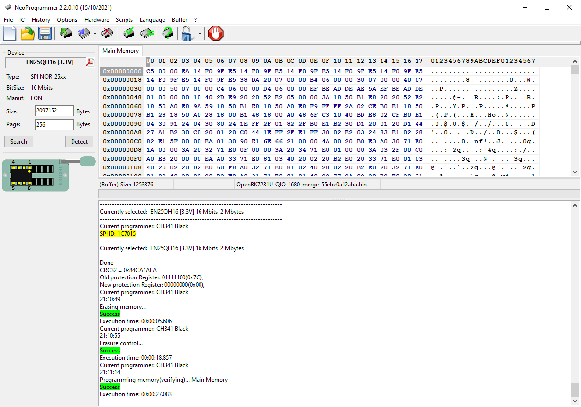

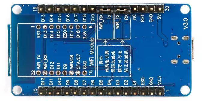

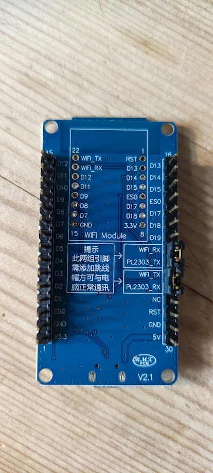

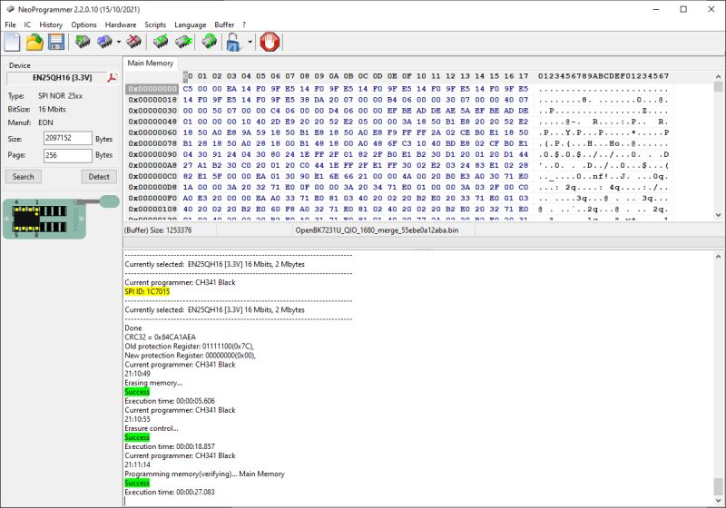

    Pin mapping for SPI flashing with CH341A/Python method - needed if writing bootloader from 0x0. BK7231U is like BK7231T - no rom. Note that on v2.1 of the board D16 is incorrectly labelled as "ESO". In v3.0 (pictured above) D16 is labelled correctly.
    HLK-B30CH341A
    RSTD2
    D17SCK
    ESO/D16 (between D17 and D15)CS0
    ESO (between GND and D1)MOSI
    D15MISO
    GNDGND
    2mb EN25QH16 flash detected in NeoProgrammer when in SPI mode

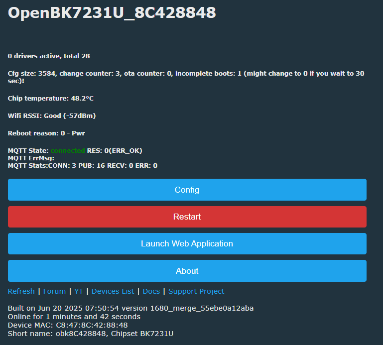

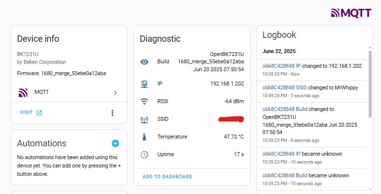

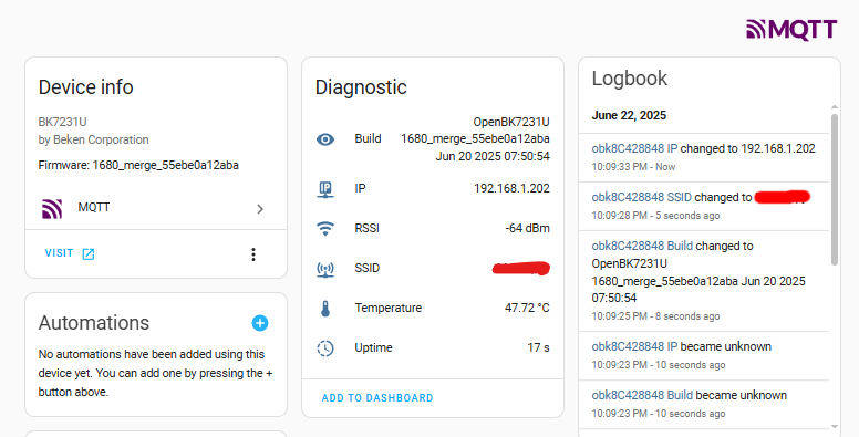

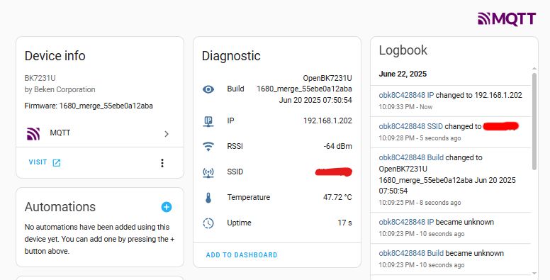

    OpenBK7231U_QIO_1680_merge_55ebe0a12aba.bin from https://github.com/openshwprojects/OpenBK7231T_App/pull/1680 flashed in its entirety from 0
    • HLK-B30-©¦½¦µ¦¥-Á+¸-Ú_V1.04.pdf (2.17 MB) You must be logged in to download this attachment.
    • hlk-b30.pdf (1.72 MB) You must be logged in to download this attachment.

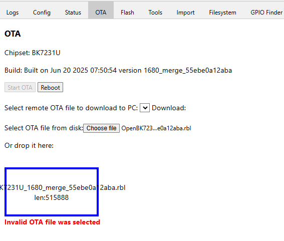

  • OTA update succeeds on HLK-B30 board
    #2 21586752
    Posts: 5220
    Help: 448
    Rate: 917
    OTA test success. this was with quick GUI page
    web app OTA filtering for .img not .rbl currently

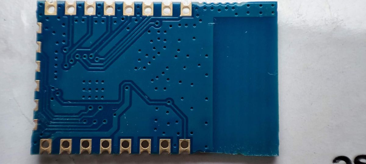

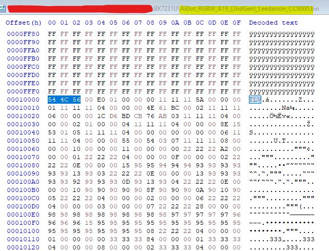

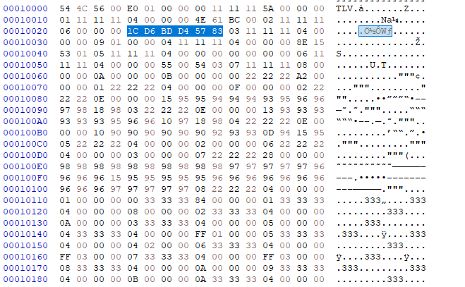

    To make sure that MAC and calibration data is correct TLV must be moved from 0x1FE000 to 0x1E0000 on BK7231U.

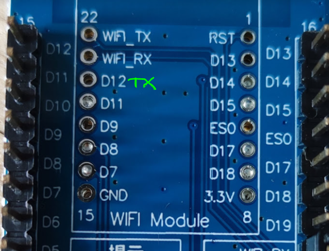

  • v2.1 board mislabels D16 as ESO

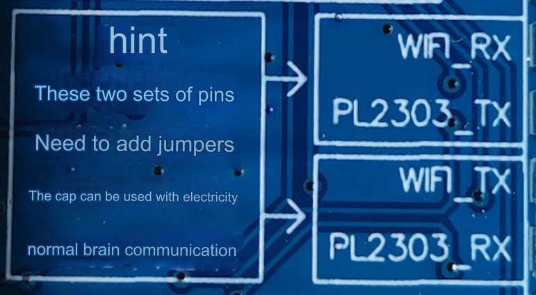

    adding v2.1 pics from https://www.elektroda.com/rtvforum/topic3941318.html#21047417
    for ref debug log has been from TX2 (D12/P0)

  • UART flashing requires preserving TLV at 0x1E0000
    #8 21589202
    Posts: 5220
    Help: 448
    Rate: 917
    could give it a go? Maybe start by taking a full backup from 0x0 and I test your bootloader with the BK7231U release, make sure it boots and see if OTA works?
    also, not sure if this would be an issue for a full freeing from cloud for your device.
    that assumes you'll only be able to flash over UART though so cannot replace bootloader. Do you have CH341A?
  • #9 21589360

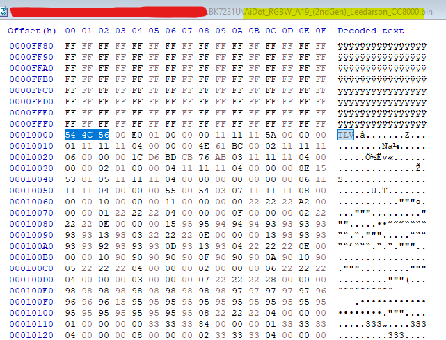

    ah yes, I remember now. The other Leedarson dump we have is just as chatty on log out.
    Well, your 2mb backup boots just fine.
    with OpenBK7231U_UA_1.18.125.bin renamed to OpenBK7231T_UA_1.18.125.bin and flashed with EF in T mode
    then OpenBK7231U boots. BL still silent. It is BK7231U_1.0.6, however.
    Device has the same generic mac as my QIO flashed example on HLK-B30 - C8:47:8C:42:88:48 - not the mac your factory fw is seen with - 1c:d6:bd:d4:57:83
    Looks like TLV is at 0x10000 in your fw - your original mac can be seen in there:
    regarding TLV location, the same is true of the other AiDot Leedarson dump:
    So I guess if these types prove popular they may justify a release build to cater for the odd TLV location, with ref to:

    Is TLV header where it is now gets overwritten?
    We can't simply change where it is located, since OBK config and flash vars are dependent on its location.
    And perhaps bootloader log is on UART0?
  • #12 21589584
    Posts: 5220
    Help: 448
    Rate: 917
    ah OK OK
    Here is dump of HLK-B30 with original Leedarson fw + OBK + those two OTAs mentioned above and the mac address change attempt
    original TLV remains

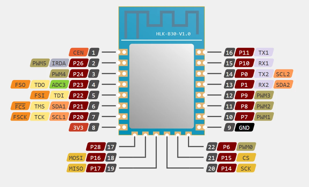

  • Clarified HLK-B30 GPIO mapping and label inconsistencies

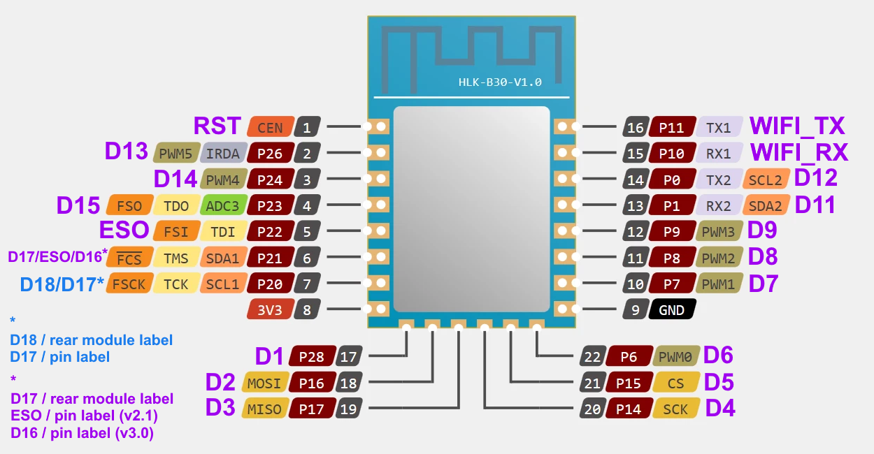

    #23 21627951
    Posts: 5220
    Help: 448
    Rate: 917
    clarification to make mapping to GPIOs in OpenBK7231U if using HLK-B30 a bit easier
    Pinout diagram of HLK-B30 module with color-coded GPIO and signal labels
    The inconsistencies in the D18/D16/D17/ESO labelling between module holes, pin header labels and board revisions is frustrating. Think this is correct.
    Following the logical numbering pattern on from ESO it probably makes sense that P21 is meant to be D16 and P20 is meant to be D17.

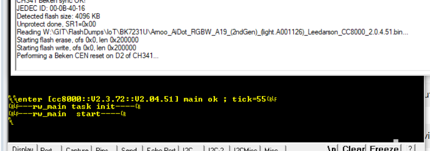

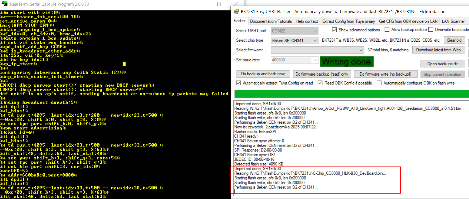

  • SPI-flashed CC8000 firmware boots RT-Thread and calibrates
    #24 21707295
    Posts: 14768
    Rate: 12911

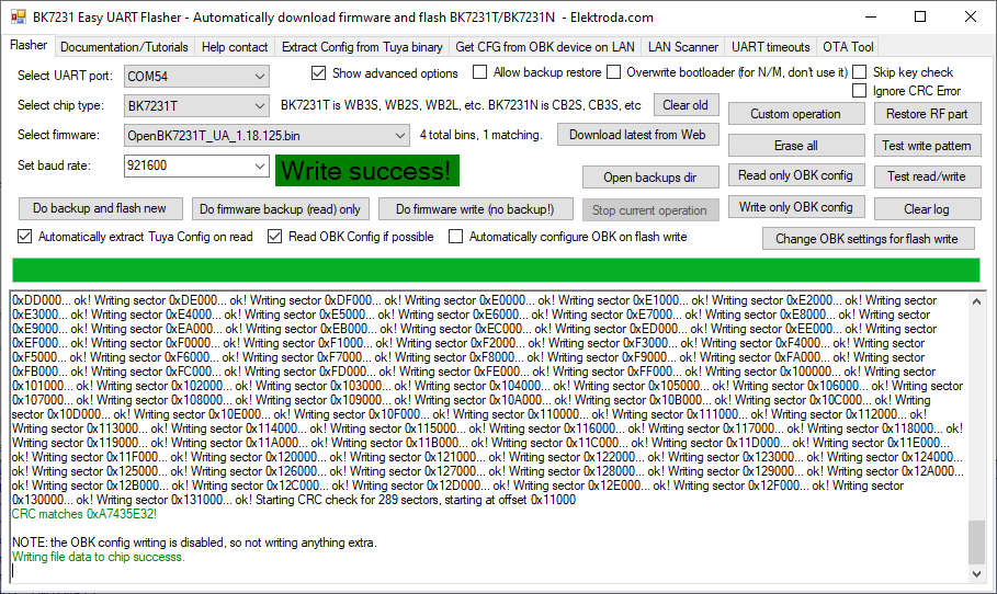

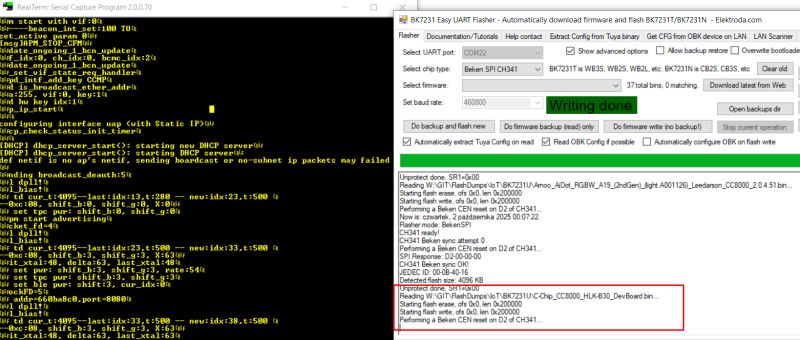

    I am playing with my BK7252 camera board, I flashed Arnoo_AiDot_RGBW_A19_(2ndGen)_(light.A001126)_Leedarson_CC8000_2.0.4.51.bin to it via SPI and got this on TX2:
    Terminal showing firmware boot log for CC8000 chip
    Also flashed this C-Chip_CC8000_HLK-B30_DevBoard.bin:
    RealTerm and BK7231 Easy UART Flasher interfaces with completed firmware write
    õ:ퟄ�û訢ÿe¤†>
    V(0.1.4)
    CPSR:0x000000D3
    R0:0x3396E676
    R1:0xFE7BFFB6
    R2:0x9CFEF80B
    R3:0x9EFD4765
    R4:0x034DA3A1
    R13:0xF2FAD7C9
    R14(LR):0xB4FB121B
    [I/FAL] Fal(V0.4.0)success
    [I/OTA] RT-Thread OTA package(V0.2.4) initialize success.
    go os_addr(0x10000)..........
    - RT -     Thread Operating System
     / | \     3.1.0 build Apr  8 2021
     2006 - 2018 Copyright by rt-thread team
    [FUNC]rwnxl_init
    [bk]tx_txdesc_flush
    [FUNC]calibration_main
    get rfcali_mode:1
    tssi_th:b-125, g-100
    [rx_iq]rx_amp_err_rd: 0x026
    [rx_iq]rx_phase_err_rd: 0x007
    [rx_iq]rx_ty2_rd: 0x000
    *********** finally result **********
    gbias_after_cal: 0x17
    gav_tssi: 0x0
    gtx_q_dc_comp:0x201
    gtx_i_dc_comp:0x1ff
    gtx_i_gain_comp:1010
    gtx_q_gain_comp:1023
    gtx_phase_comp:497
    gtx_phase_ty2:512
    gtx_ifilter_corner over: 0xf
    gtx_qfilter_corner over: 0x10
    gtx_dcorMod:0x8, gtx_dcorPA:0x8
    gtx_pre_gain:0x10
    g_rx_dc_gain_tab 0 over: 0x80808080
    g_rx_dc_gain_tab 1 over: 0x84808480
    g_rx_dc_gain_tab 2 over: 0x8a788c7c
    g_rx_dc_gain_tab 3 over: 0xa06c9470
    g_rx_dc_gain_tab 4 over: 0xa068a068
    g_rx_dc_gain_tab 5 over: 0xa0669f66
    g_rx_dc_gain_tab 6 over: 0xa268a166
    g_rx_dc_gain_tab 7 over: 0xa16aa168
    grx_amp_err_wr:0x1ed
    grx_phase_err_wr:0x003
    flash txpwr table:0xf
    dif g and n20 ID in flash:2
    dif g and n40 ID in flash:4
    read txpwr tab from flash success
    temp in flash is:280
    xtal inital:280, 70, 16
    lpf_i & q in flash is:12, 12
    xtal in flash is:48
    xtal_cali:48
    --init_xtal = 48
    -----pwr_gain:12, g_idx:12, shift_b:0, shift_g:0
    -----[pwr_gain]12
    rwnx_tpc_pa_map_init
    [FUNC]ps_init
    [FUNC]func_init_extended OVER!!!
    tcp_port=1221762145
    tcp_port=63957
    lwIP-2.0.2 initialized!
    igmp_mac_filter add 224.0.0.1 01:00:5E:00:00:01
    register station wlan device sucess!
    register soft-ap wlan device sucess!
    beken wlan hw init
    drv_pm_init
    [D/FAL] (fal_flash_init:63) Flash device |             beken_onchip | addr: 0x00000000 | len: 0x00200000 | blk_size: 0x00001000 |initialized finish.
    [D/FAL] (fal_flash_init:63) Flash device |         beken_onchip_crc | addr: 0x00000000 | len: 0x00200000 | blk_size: 0x00001000 |initialized finish.
    [I/FAL] ==================== FAL partition table ====================
    [I/FAL] | name       | flash_dev        |   offset   |    length  |
    [I/FAL] -------------------------------------------------------------
    [I/FAL] | bootloader | beken_onchip_crc | 0x00000000 | 0x00010000 |
    [I/FAL] | app        | beken_onchip_crc | 0x00010000 | 0x00110000 |
    [I/FAL] | download   | beken_onchip     | 0x00132000 | 0x000c4000 |
    [I/FAL] | param1     | beken_onchip     | 0x001f6000 | 0x00004000 |
    [I/FAL] | param2     | beken_onchip     | 0x001fa000 | 0x00004000 |
    [I/FAL] | param3     | beken_onchip     | 0x001fe000 | 0x00001000 |
    [I/FAL] | param4     | beken_onchip     | 0x001ff000 | 0x00001000 |
    [I/FAL] =============================================================
    [I/FAL] RT-Thread Flash Abstraction Layer (V0.4.0) initialize success.
    Enter normal mode...
    app_init finished
    [Flash]id:0xb4016
    flash_init end
    ap ssid=-HLK-B30_3EE3,12345678-
    [DRV_WLAN]drivers\wlan\drv_wlan.c L940 beken_wlan_control cmd: case WIFI_INIT!
    _wifi_softap: ssid:HLK-B30_3EE3 key:12345678
    ap init ok
    ble start no ble name
    ble name:BK7231BT-01, 45:33:4c:cc:3e:e3
    -----rw_main task init----
    -----rw_main  start----
    gapm_cmp_evt_handler operation = 0x1, status = 0x0
    gapm_cmp_evt_handler operation = 0x3, status = 0x0
    STACK INIT OK
    ble create new db
    ble_env->start_hdl = 0x7
    gapm_cmp_evt_handler operation = 0x1b, status = 0x0
    CREATE DB SUCCESS
    start watch dog
    rt_hw_wdg_start time=10000 threshold=5000
    iSockFD=4
    ip addr=660ba8c0,port=8080
    TCP ERROR: tcp client connect server error! -1
    msh />sending broadcast_deauth:5
    Soft_AP_start
    [saap]MM_RESET_REQ
    [bk]tx_txdesc_flush
    [saap]ME_CONFIG_REQ
    rw_msg_send_me_config_req ps_on is 1
    [saap]ME_CHAN_CONFIG_REQ
    [saap]MM_START_REQ
    [csa]csa_in_progress[0:0]-clear
    mm_add_if_req_handler:0
    hapd_intf_add_vif,type:3, s:0, id:0
    apm start with vif:0
    ------beacon_int_set:100 TU
    set_active param 0
    [msg]APM_STOP_CFM
    update_ongoing_1_bcn_update
    mm_set_vif_state_req_handler
    vif_idx:0, ch_idx:0, bcmc_idx:2
    hapd_intf_add_key CCMP
    add is_broadcast_ether_addr
    sta:255, vif:0, key:1
    add hw key idx:1
    uap_ip_start
    configuring interface uap (with Static IP)
    dhcp_check_status_init_timer
    please use rtthread dncp start server
    [DHCP] dhcpd_start: ap
    [DHCP] aaaaaa=fe10a8c0,ffffff
    [DHCP] aaaaaa=192.168.16.254,255.255.255.0
    [DHCP] dhcp_server_start(): starting new DHCP server
    [DHCP] dhcp_server_start(): starting DHCP server
    def netif is no ap's netif, sending boardcast or no-subnet ip packets may failed
    cal dpll!
    cal_bias!
    do td cur_t:4095--last:idx:13,t:280 -- new:idx:23,t:500
    --0xc:08, shift_b:0, shift_g:0, X:0
    td set tpc pwr: shift_b:0, shift_g:0
    appm start advertising
    socket_fd=4
    cal dpll!
    cal_bias!
    do td cur_t:4095--last:idx:23,t:500 -- new:idx:33,t:500
    --0xc:08, shift_b:3, shift_g:3, X:63
    init_xtal:48, delta:63, last_xtal:48
    td set pwr: shift_b:3, shift_g:3, rate:54
    td set tpc pwr: shift_b:3, shift_g:3
    td set ble pwr: shift:3, cur_idx:0
    iSockFD=5
    cal dpll!
    cal_bias!
    do td cur_t:4095--last:idx:33,t:500 -- new:idx:38,t:500
    init_xtal:48, delta:63, last_xtal:63
    iSockFD=5
    Wi-Fi network list showing secured network HLK-B30_3EE3 highlighted

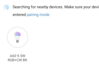

    BK7231T_QIO_WB2L_ROOMLUX B15515 A60_2024-31-8-20-42-37.bin on Tuya BK7252U doorbell
    N was tried here but I could do it again https://www.elektroda.com/rtvforum/topic4092465-270.html#21647772
    it even shows for pairing
    Pairing screen showing bulb A60 9.5W RGB+CW BK detected

Method What it can change Proven in thread Main limitation
CH341A SPI from 0x0 Bootloader + full flash Yes Requires pad-level wiring
UART flashing App firmware only Yes Cannot replace bootloader
OTA from OpenBK7231U Download/app area Yes Web UI currently filters for .img
ESPHome UART/OTA path App + later OTA Yes Needs correct calibration/TLV setting

  • The HLK-B30 board exposes a 3.3 V supply on VBAT, and the tested module used an EN25QH16 2 MB SPI flash detected by NeoProgrammer. [#21586747]
  • OpenBK7231U OTA on HLK-B30 initialized its download slot at 0x132000 and closed near 0x1AF400, then rebooted successfully. [#21586752]
  • The stock partition layout shown by a later CC8000 dump used bootloader 0x00000000–0x00010000, app 0x00010000–0x00110000, and download 0x00132000–0x000C4000. [#21707295]
  • Debug output on HLK-B30 was confirmed on TX2 / D12 / P0, while nothing appeared on the USB-serial path tied to P11 in that test setup. [#21587742]
  • A working SoftAP example came up as 192.168.4.1/24 with SSID OpenBK7231U_8C428848, showing that the flashed firmware could fully boot and expose a config AP. [#21589558]
How do I flash OpenBK7231U on a Hi-Link HLK-B30 with the C-Chip CC8000 using CH341A SPI from address 0x0?
Use SPI, not UART, if you need a full image from address 0x0. 1. Wire CH341A to the HLK-B30 pads using the tested mapping, including RST, SCK, CS0, MOSI, MISO, and GND. 2. Put the board in SPI mode and confirm the EN25QH16 2 MB flash is detected. 3. Write the full merged image, such as OpenBK7231U_QIO_1680_merge_55ebe0a12aba.bin, starting at 0x0. This path is required when you also need to write the bootloader, because BK7231U has no ROM boot fallback in this context. [#21586747]
What is the correct HLK-B30 to CH341A pin mapping for SPI flashing, including the mislabeled D16/ESO pads on board revisions v2.1 and v3.0?
The tested mapping is: RST→D2, D17→SCK, ESO/D16 between D17 and D15→CS0, ESO between GND and D1→MOSI, D15→MISO, GND→GND. On v2.1, D16 is mislabeled as ESO. On v3.0, that label was corrected. A later clarification notes that the D18/D16/D17/ESO silkscreen remains inconsistent across holes and headers, so verify pad position, not only the printed label. [#21586747]

It happens because OpenBK7231U may not read the device’s original TLV or calibration data from the offset used by that CC8000 firmware. In the tested Leedarson dump, the factory MAC stayed visible in flash, but OpenBK7231U came up with the generic C8:47:8C:42:88:48 instead of the original 1C:D6:BD:D4:57:83. That means the firmware booted, but it did not consume the original MAC source correctly. [#21589558]
What is TLV on BK7231U/CC8000 firmware, and why does its flash location matter for MAC and calibration data?
"TLV" is a flash data structure that stores device-specific values, key characteristic data such as MAC address and RF calibration. Its location matters because firmware reads those values from a fixed offset. One thread note says BK7231U should move TLV from 0x1FE000 to 0x1E0000 for correct MAC and calibration handling, while some Leedarson-based CC8000 dumps appear to keep the relevant data around 0x10000 instead. If firmware looks in the wrong place, it boots with defaults. [#21586895]
How can TLV data be copied or moved so OpenBK7231U keeps the original MAC and calibration values on CC8000 hardware?
The practical fix is to read the original TLV or calibration block from its existing offset and write it to the offset OpenBK7231U expects. The thread narrowed this to either adding separate read, erase, and write commands in the web app, or implementing one device-side function that reads TLV, erases the destination, and writes it back in one step. That approach was proposed after confirming the original TLV remained intact in flash. [#21590069]

Which UART pin on the HLK-B30 carries debug output for CC8000/OpenBK7231U, and why might the bootloader stay silent on other UART pins?
The confirmed debug log came from TX2 on D12/P0. A later test also states that nothing appeared on the USB/CP210x path tied to P11, while output was visible on D12/P0. The bootloader can therefore look silent if you monitor the wrong UART. One reply also asked whether the bootloader log might be on UART0, which matches the observed need to probe a different serial pin than the obvious USB header. [#21589591]
How does OpenBK7231U UART flashing compare with SPI flashing on CC8000 devices when the bootloader cannot be replaced over UART?
UART flashing is enough to test or deploy OpenBK7231U on CC8000, but it cannot replace the bootloader. SPI flashing can replace both bootloader and application from 0x0. One expert summary in the thread states: “bootloader can't be flashed via UART on BK7231U/T/S.” In practice, UART worked by renaming the U image to a T name for Easy UART Flasher, while SPI remained the only path for full low-level recovery or bootloader experiments. [#21589997]

What should I back up from a Leedarson CC8000 bulb before experimenting with OpenBK7231U, and which backup formats include the useful bootloader and calibration data?
Back up the full flash from 0x0 before testing anything. The thread explicitly recommends a full backup first, then checking whether the bootloader and TLV or calibration data are present. A 2 MB .bin dump is the most useful because it can include bootloader, app, and device data in one image. The user also had a UARTProgram .img, but the later analysis focused on the 2 MB backup as the one that “boots just fine” and exposes the original MAC in flash. [#21589558]
Which HLK-B30 GPIO labels correspond to the actual P20, P21, and related pins in OpenBK7231U, given the confusing D18/D16/D17/ESO board markings?
The later mapping clarification says the board silkscreen is inconsistent, but the logical numbering suggests P21 should be D16 and P20 should be D17. That matters because HLK-B30 labels differ between module holes, header labels, and revisions like v2.1 and v3.0. If you configure OpenBK7231U only from the printed D labels, you can assign the wrong GPIO. Use the clarified diagram and continuity checks where possible. [#21627951]
