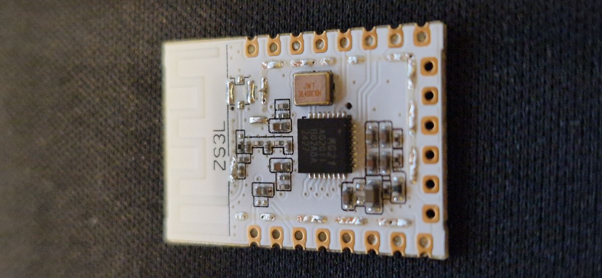

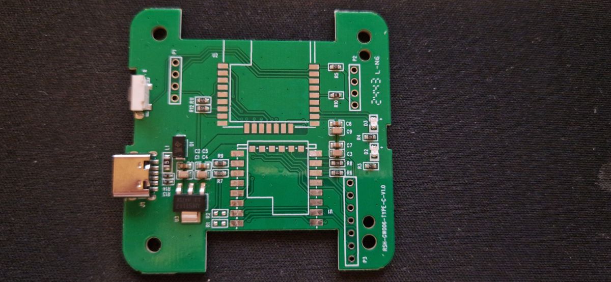

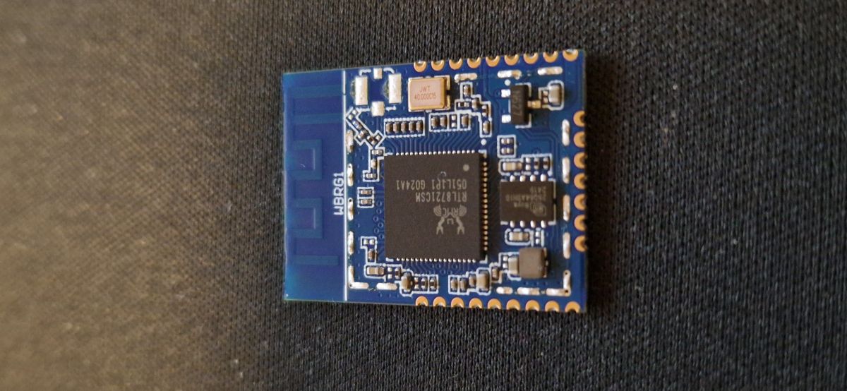

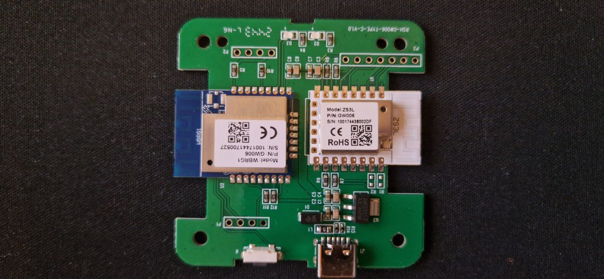

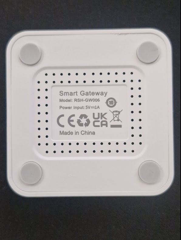

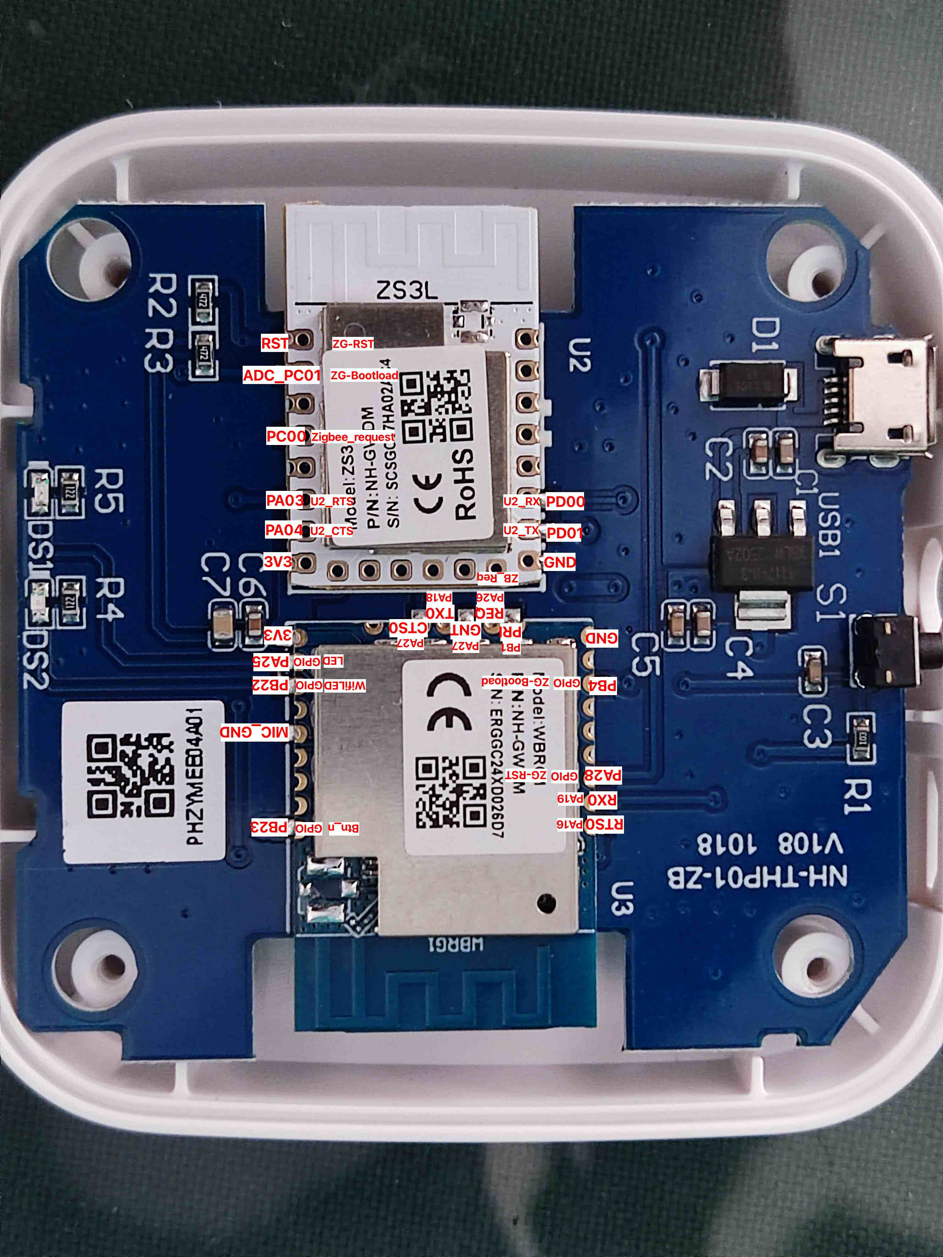

    Teardown pictures of the device:
    Device has 4 small screws hidden under the rubber feet
    Smart Gateway RSH-GW006 to OBK Conversion: Tools, Files, Setup, and Integration Guide

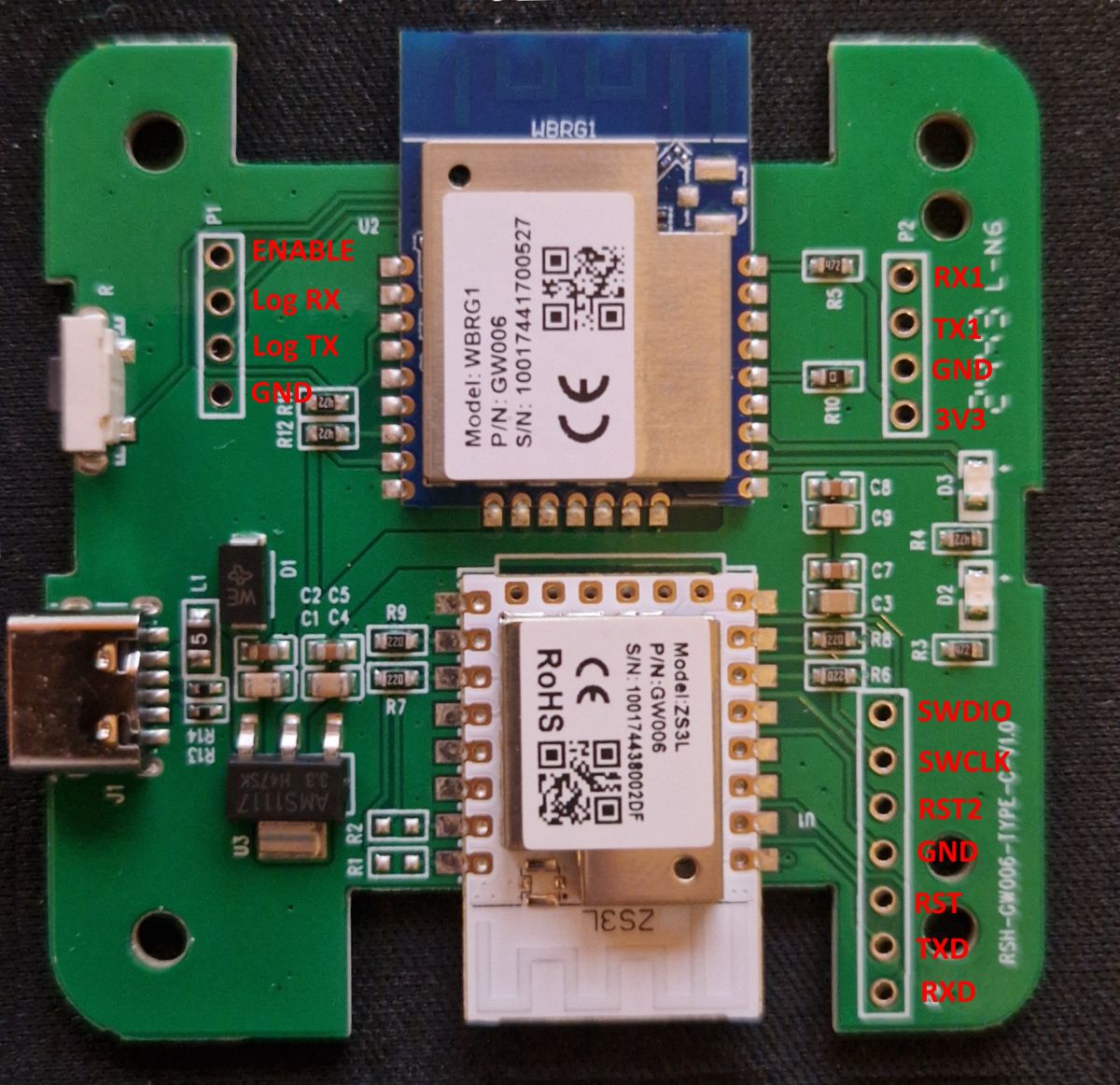

    Board pinout:

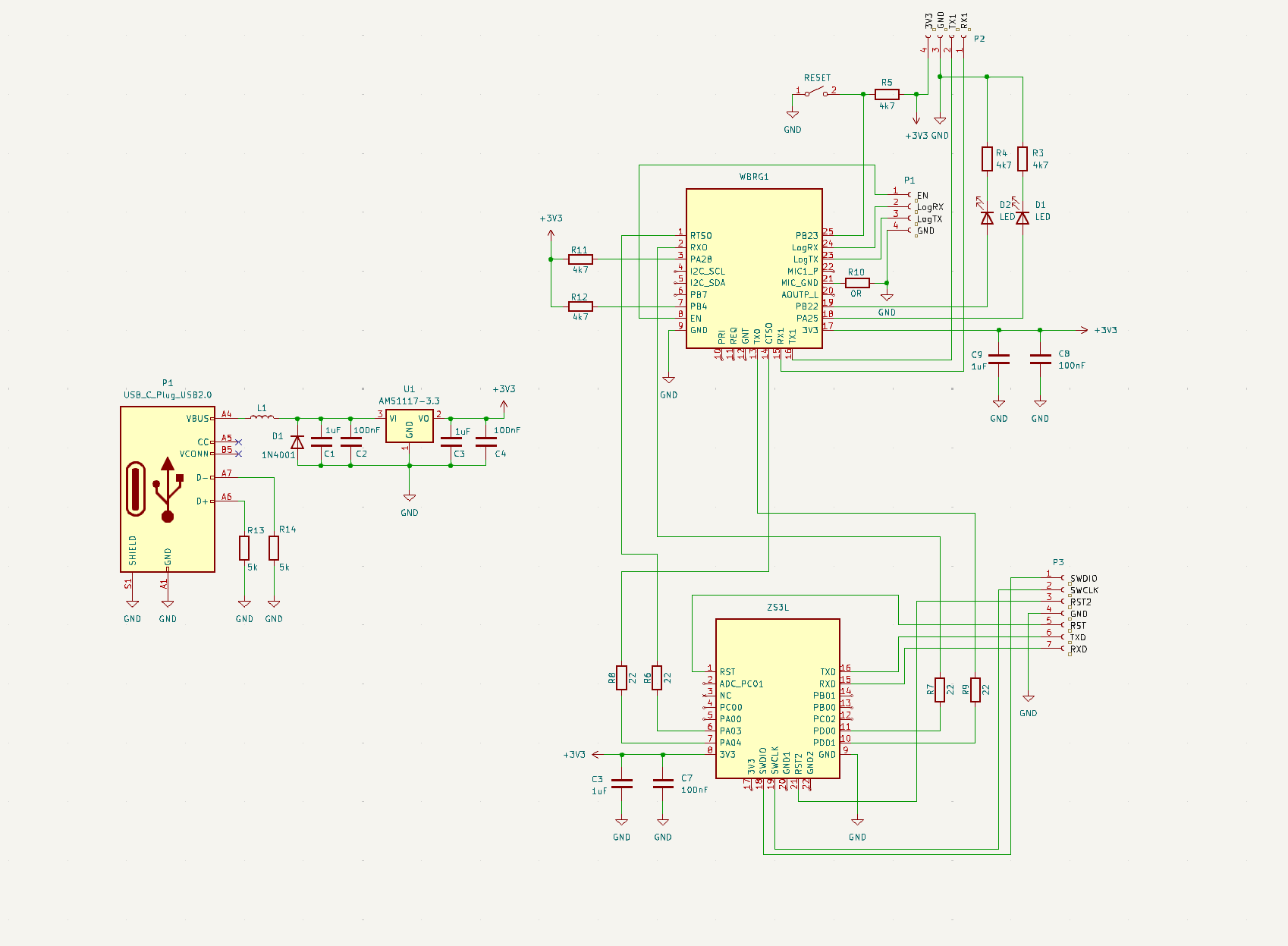

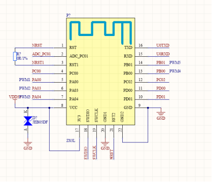

    Board schematic:
    IMPORTANT!!! in order to set the WBRG1 module into download/bootloader mode, connect UART (GND, 3V3, Rx and Tx) to P1 , pull ENABLE pin to GND, pull LogTX pin to GND via 2k2-4k7 resistor, disconnect ENABLE pin, then disconnect the resistor from LogTX line - device will be in bootloader mode!!

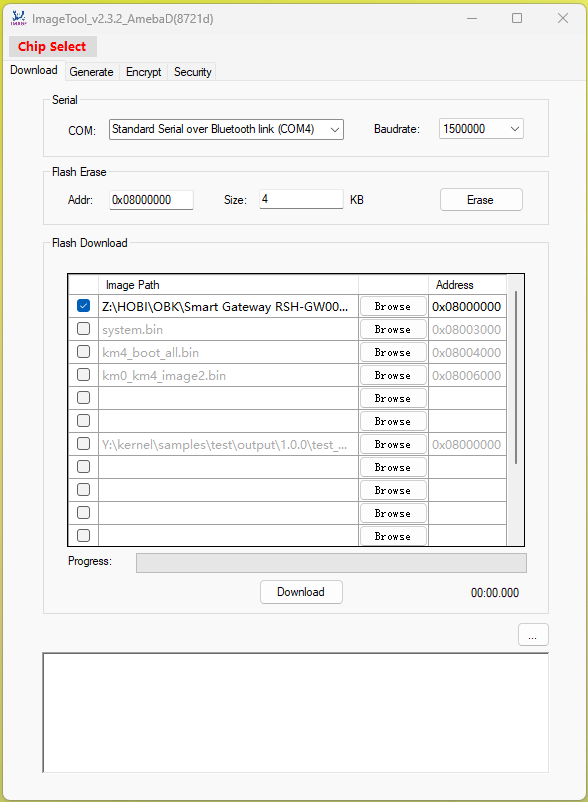

    AmebaD image tool named Ameba-ImageTool_v2.3.2_AmebaD.zip attached. Use the latest build file and add it to the first field as in the picture, don't change anything else, put the device in bootloader mode and click "Download" button. Reboot the device afterwards and it will should appear in you WiFi list as every OBK device does. Connect to it and via address 192.168.4.1 configure to your needs.

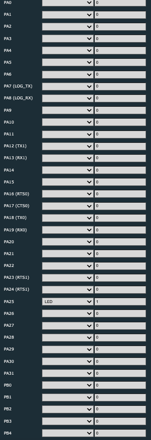

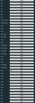

    Pin setup for OBK:
      "pins": {
        "25": "LED;1",
        "54": "WifiLED;0",
        "55": "Btn_n;0"

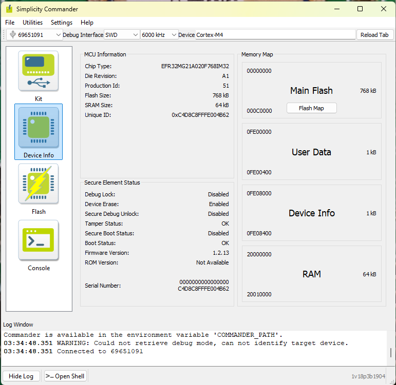

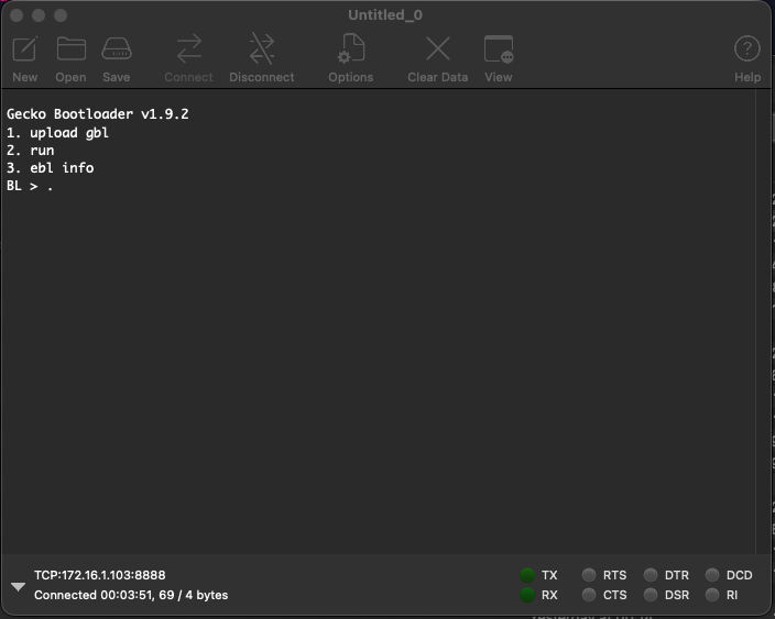

    Simplicity commander for flashing ZS3L module via J-Link (also attached) - https://www.silabs.com/documents/public/software/SimplicityCommander-Windows.zip

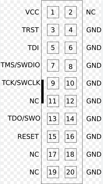

    J-Link Pinout and link for first AliExpress listing if you need one - https://www.aliexpress.com/item/1005006412575470.html
    Another method to flash ZS3L is with universal-silabes-flasher that can be found here (also attached) - https://github.com/NabuCasa/universal-silabs-flasher
    universal-silabs-flasher --device socket://<OBK_IP>:8888 flash --firmware zs3l_zigbee_ncp_8.2.0.0_115200.gbl
    ***I tried all possible combinations and tools but could not flash ZS3L via UART, if I find the solution I will update the post.

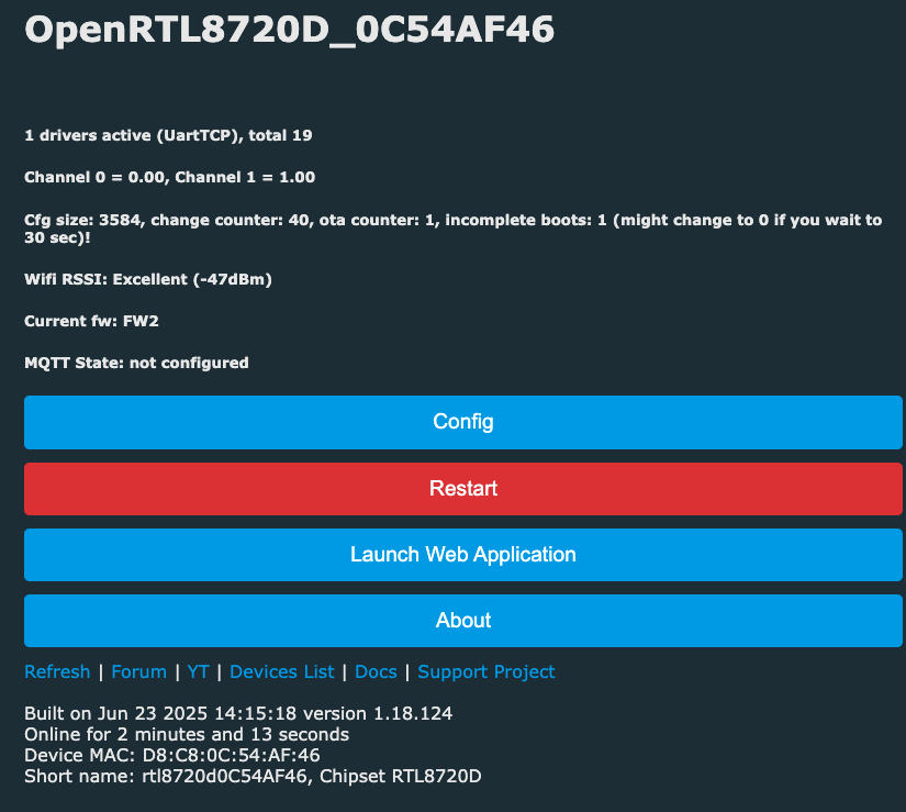

    Latest build can be found here, look for RTL8720D UART flash - https://github.com/openshwprojects/OpenBK7231T_App/releases/

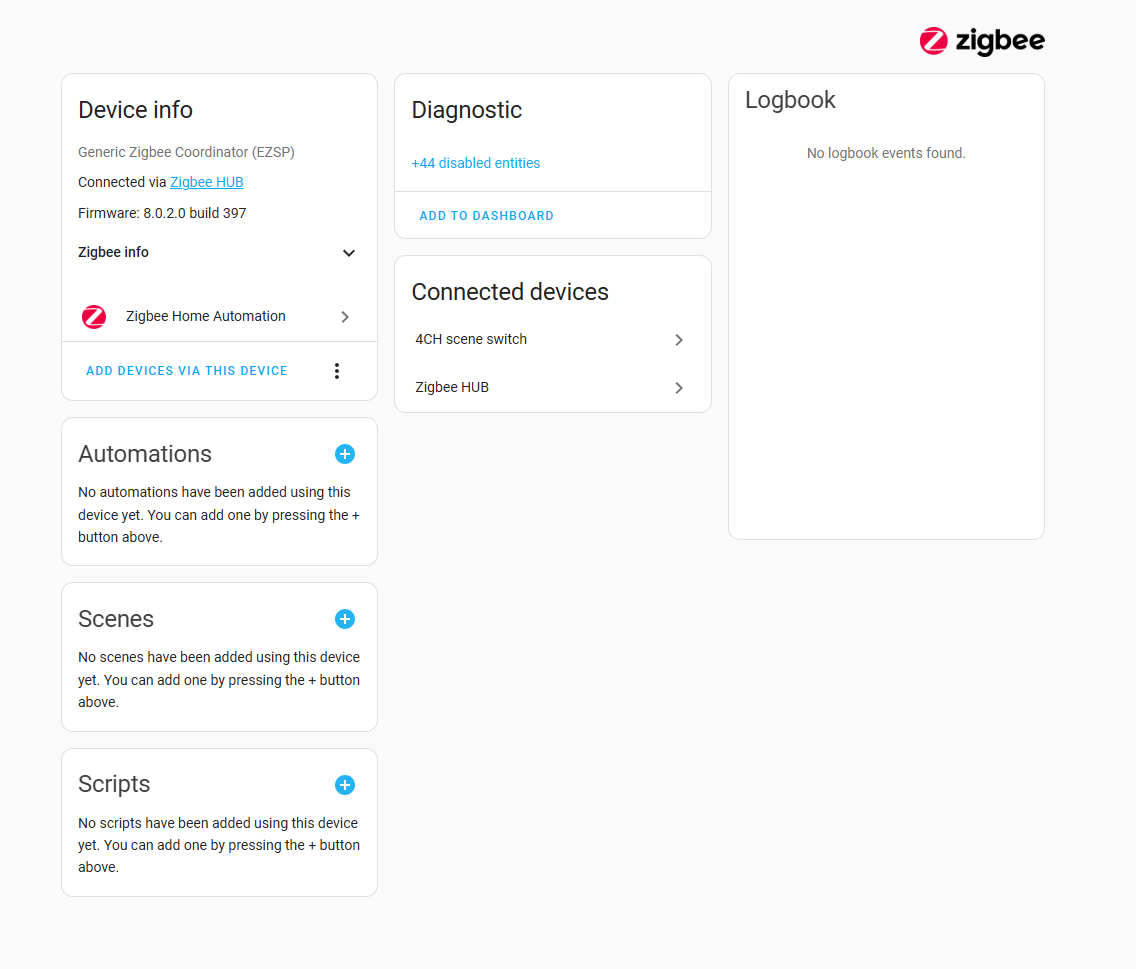

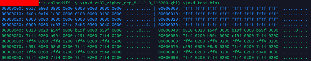

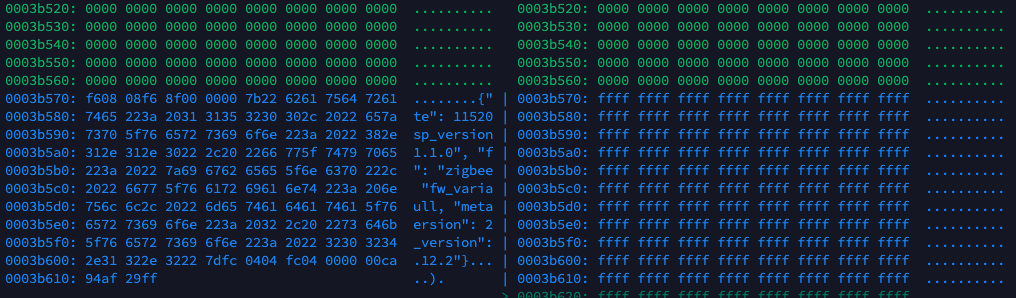

    TESTED - ZS3L FW 8.0.2.0 located here - https://www.elektroda.com/rtvforum/download.php?id=1253241
    UNTESTED newer firmware's attached and named
    firmware-build-zs3l_zigbee_ncp_8.1.1.0_115200.zip
    and
    firmware-build-zs3l_zigbee_ncp_8.2.0.0_115200.zip

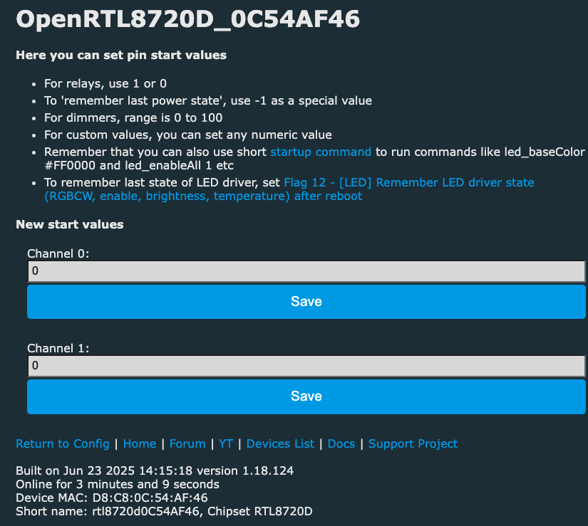

    After flashing:

    autoexec.bat
    startdriver uarttcp 115200 512 1 1
    SetChannelLabel 1 "Bridge Connection"
    SetChannelVisible 1 0
    SetChannelType 1 OpenClosed_Inv

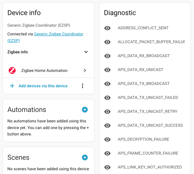

    Setup and basic HA integration:
    Use ZigBee Home Automation (ZHA) integration, it can be found under Setting -> Devices & services -> Add Integration in the bottom right corner of the screen.
    When adding a device for port select:
    tcp://<OBK_IP>:8888
    meaning whatever IP OBK has been assigned by DHCP on your network or if statis IP is set use that
    and if you flashed the latest ZS3L firmware select Hardware flow control, if not leave it as is, default it no selection

    Firmware for WBRG1 is a release version of OpenRTL8720D. Stable, i've got a month uptime.
    Firmware for ZS3L attached. Built with HW flow offload. Can be updated right through TCP (even if not always on the first try).
    My autoexec.bat
    • firmware-build-zs3l_zigbee_ncp_8.0.2.0_115200 (1).zip (1.13 MB) You must be logged in to download this attachment.

    Spent entire night troubleshooting communication problems only to discover that 1 out of 11 UART's I have can actually work fine with 1500000bps setting.... 😐
  • ZS3L firmware update via TCP and Z2M compatibility issue
    #10 21589890
    insmod
    Posts: 1432
    Help: 168
    Rate: 455
    @DeDaMrAz
    You posted wrong 8.1.1.0 firmware (not for ZS3L).
    I successfully updated my ZS3L via TCP from 8.0.2.0 to 8.2.0.0
    universal-silabs-flasher --device socket://192.168.1.132:8888 flash --firmware zs3l_zigbee_ncp_8.2.0.0_115200.gbl
    2025-06-26 10:59:40.221 DESKTOP-QRMSCIH universal_silabs_flasher.flash INFO Extracted GBL metadata: NabuCasaMetadata(metadata_version=2, sdk_version='2025.6.0', ezsp_version='8.2.0.0', ot_rcp_version=None, cpc_version=None, fw_type=<FirmwareImageType.ZIGBEE_NCP: 'zigbee_ncp'>, fw_variant=None, baudrate=115200)
    2025-06-26 10:59:40.222 DESKTOP-QRMSCIH universal_silabs_flasher.flasher INFO Probing ApplicationType.GECKO_BOOTLOADER at 115200 baud
    2025-06-26 10:59:42.406 DESKTOP-QRMSCIH universal_silabs_flasher.flasher INFO Probing ApplicationType.EZSP at 115200 baud
    2025-06-26 10:59:44.715 DESKTOP-QRMSCIH universal_silabs_flasher.flasher INFO Detected ApplicationType.EZSP, version '8.0.2.0 build 397' (8.0.2.0.397) at 115200 baudrate (bootloader baudrate None)
    2025-06-26 10:59:51.919 DESKTOP-QRMSCIH universal_silabs_flasher.flasher INFO Probing ApplicationType.GECKO_BOOTLOADER at 115200 baud
    2025-06-26 10:59:51.985 DESKTOP-QRMSCIH universal_silabs_flasher.flasher INFO Detected bootloader version '1.9.2'
    2025-06-26 10:59:51.985 DESKTOP-QRMSCIH universal_silabs_flasher.flasher INFO Detected ApplicationType.GECKO_BOOTLOADER, version '1.9.2' at 115200 baudrate (bootloader baudrate 115200)
    zs3l_zigbee_ncp_8.2.0.0_115200.gbl  [####################################]  100%
    My Z2M (2.1.1) version couldn't handle 8.2.0 firmware. After update to 2.4.0 it wasn't fixed.
    [2025-06-26 11:02:20] error:    z2m: Error: Adapter EZSP protocol version (17) is not supported by Host [13-16].
    Works in latest-dev container.
    It can be downgraded with universal-silabs-flasher by adding --allow-downgrades
    universal-silabs-flasher --device socket://192.168.1.132:8888 flash --firmware zs3l_zigbee_ncp_8.1.1.0_115200.gbl --allow-downgrades
    2025-06-26 11:12:05.413 DESKTOP-QRMSCIH universal_silabs_flasher.flash INFO Extracted GBL metadata: NabuCasaMetadata(metadata_version=2, sdk_version='2024.12.2', ezsp_version='8.1.1.0', ot_rcp_version=None, cpc_version=None, fw_type=<FirmwareImageType.ZIGBEE_NCP: 'zigbee_ncp'>, fw_variant=None, baudrate=115200)
    2025-06-26 11:12:05.413 DESKTOP-QRMSCIH universal_silabs_flasher.flasher INFO Probing ApplicationType.GECKO_BOOTLOADER at 115200 baud
    2025-06-26 11:12:07.463 DESKTOP-QRMSCIH universal_silabs_flasher.flasher INFO Probing ApplicationType.EZSP at 115200 baud
    2025-06-26 11:12:09.613 DESKTOP-QRMSCIH bellows.ezsp WARNING Protocol version 17 is not supported, using version 14 instead
    2025-06-26 11:12:09.704 DESKTOP-QRMSCIH universal_silabs_flasher.flasher INFO Detected ApplicationType.EZSP, version '8.2.0.0 build 191' (8.2.0.0.191) at 115200 baudrate (bootloader baudrate None)
    2025-06-26 11:12:11.852 DESKTOP-QRMSCIH bellows.ezsp WARNING Protocol version 17 is not supported, using version 14 instead
    2025-06-26 11:12:16.907 DESKTOP-QRMSCIH universal_silabs_flasher.flasher INFO Probing ApplicationType.GECKO_BOOTLOADER at 115200 baud
    2025-06-26 11:12:16.949 DESKTOP-QRMSCIH universal_silabs_flasher.flasher INFO Detected bootloader version '1.9.2'
    2025-06-26 11:12:16.949 DESKTOP-QRMSCIH universal_silabs_flasher.flasher INFO Detected ApplicationType.GECKO_BOOTLOADER, version '1.9.2' at 115200 baudrate (bootloader baudrate 115200)
    zs3l_zigbee_ncp_8.1.1.0_115200.gbl  [####################################]  100%
    8.1.1.0 works
    8.2.0.0 will be supported in next Zigbee2MQTT update (required changes are already merged in dev branch).

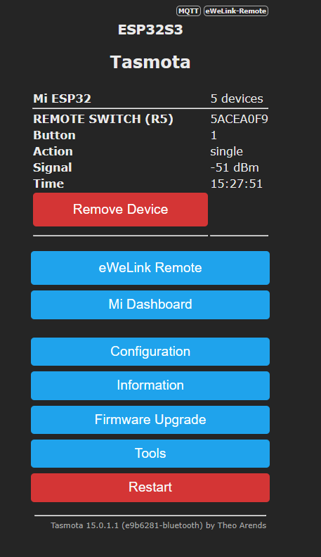

    P.S. two more topics I want to add as I am dealing with them right now are adding a BT proxy for HA via ESP32 and eWeLink remote for their BT devices via Tasmota integration.
    BT Proxy teaser picture 🙂
  • ESP32-C3 Bluetooth limitations and GW pin mapping

    Single core ESPs, like ESP32-C3 is worse for bluetooth than ESP32 and ESP32-S3. They might miss some advertisements packages.
    I once tried to use ESP32-C2, and it didn't work. As soon as bluetooth turned on, wifi connection was lost. Perhaps it works now, but to even enable it on 2MB device was a pain.
    Pins for my GW
    PA25 is red led (i use it for zigbee connection status, linked to channel 1)
    PB22 is blue led (i use as WifiLED)
    PB23 is button (i use as Btn_n)

    >>21590159
    insmod wrote:
    Pins for my GW
    Yes I forgot that part, thanks.
    I got several of those small ESP32 boards incoming, so I'll try them all and post results when that thread is created, idea is to hide BT proxy inside (or outside as the board is tiny) a charger that will also power the GW so I got al the devices covered.
    @p.kaczmarek2
    BTW I've noticed that the webapp can't set the pin roles at least on this RTL device?
    Added after 2 [hours] 23 [minutes]:
    I will certainly test that but for now I picked an S3 from the bin and it is working nicely, only draw back is module gets a bit toasty 🙂

    I need some help getting Zigbee out of ZS3L. I purchased one of Tuya MOES gateways, NH-THP01-ZB, and mapped the pin connections using a continuity meter.
    Interior of an electronic device with Zigbee and Wi-Fi modules on a PCB board
    1. I soldered lines to the WBRG1 and flashed Openbeken, all working, and set up the autoexec.bat and pins for LEDs and the button, all working.
    I thought that was the difficult part, but unfortunately, the ZS3L seemed to be my downfall.
    2. I can flash ZS3L using universal-silabs-flasher and was able to dump the contents using gdb and an ST-LINK V2 and confirm the entire BGL is in the ZS3L flash with only gbl header and footer difference (unfortunately, I don't have a Segger J-LINK compatible probe and cannot use Commander to flash with).
    But the flashing was sporadic and did not always get a response for Bootloader detection, then I found this article Link, where it mentions
    This helped me determine that there are three other pins connected between the ZS3L and WBRG1. I defined some pins in OpenBeken to pull high as Relay and then got a more consistent bootloader toggle those, which is even visible in CoolTerm. I am unsure how to correctly connect and use these 3 pins (RST, ADC_PC01, PC00), and I cannot get Zigbee to work.
    Terminal running Gecko Bootloader v1.9.2 with active TCP connection
    Some of these pins are even in the reference design of Tuya - Link
    Diagram of a microcontroller module with Bluetooth and power components
    Code: Bash
    I trimmed the bootloader code from the beginning of the dump to have the lines align with the BGL, I was pleased to see the flasher worked.
    Side-by-side hex comparison of two binary files using colordiff and xxd
    Hex editor screenshot showing encoded JSON data and memory fields
    When I test Zigbee, do I have the 3 pins incorrectly high and low, I tried all combinations ...... Maybe I am doing some silly.
    Code: Bash
    Unfortunately I don't have the original code from WBRG1 and ZS3L :-(

    Otherwise, I will have to wait until I can get a proper J-Link tool to use Simplicity Commander, which is my last hope then.
    OpenRTL8720D user interface showing device status and control options
    OpenRTL8720D device configuration interface with start values for channels
    Microcontroller GPIO pin configuration list with functions and logic values

    The only way I can get into the Bootloader is by pulling high PB4 and PA28 to force a bootloader. Dunno if this is saying something......
    Pressing 2. run is either running or hanging. After pressing it, CoolTerm is not responding. But nor is Z2M working :-(
    Pressing 3. ebl info does nothing, and according to the documentation, it just throws the same Gecko Bootloader v1.9.2. menu.
    Link
    See section 2.1 page 3
    PS. I will have to wait for a J-Link tool to flash the backup, but I will keep that file, thanks. Unless there's another way......
  • Stock ZS3L firmware restores EZSP operation
    #28 21655556
    diepeterpan
    Posts: 22
    >>21654884
    I found the following stock firmware for the NH-THP01-ZB and its ZS3L, and I flashed it, yielding some promising results.
    https://github.com/user-attachments/files/16552069/zs3l_ncp-uart-hw_EmberZNet6.5.5.0_stock.zip
    Code: Bash
    After flashing that firmware, it started to work, but with an old 6.5.5.0 stack, which is only supported in Z2M using the EZSP protocol.
    Code: Bash
    But it's so old that even Z2M could not complete initialization.
    So I decided to give ZHA a try, and it worked. I can join a Zigbee device, and everything works fine.
    Device info and diagnostic panel for Zigbee Coordinator in a smart home app Zigbee TS0201 device panel showing temperature, humidity, and status info.
    Now, to find a firmware for the ZS3L that's newer and working is the challenge; why the other firmwares don't work is a mystery.
