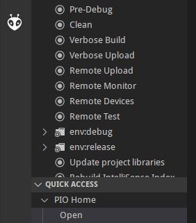

The PlatformIO Home icon may simply appear with a delay after VS Code starts, so wait a bit for the module to load, and make sure the PlatformIO IDE extension finished installing before restarting VS Code [#18527481][#18526369][#18526964] If the house icon still does not show, use the PIO icon in the left sidebar and choose “Open” to access the same functionality [#18525987] If the extension is globally disabled as unsafe, open it in the Extensions view, click the shield/trust option, and trust PlatformIO [#20346994]

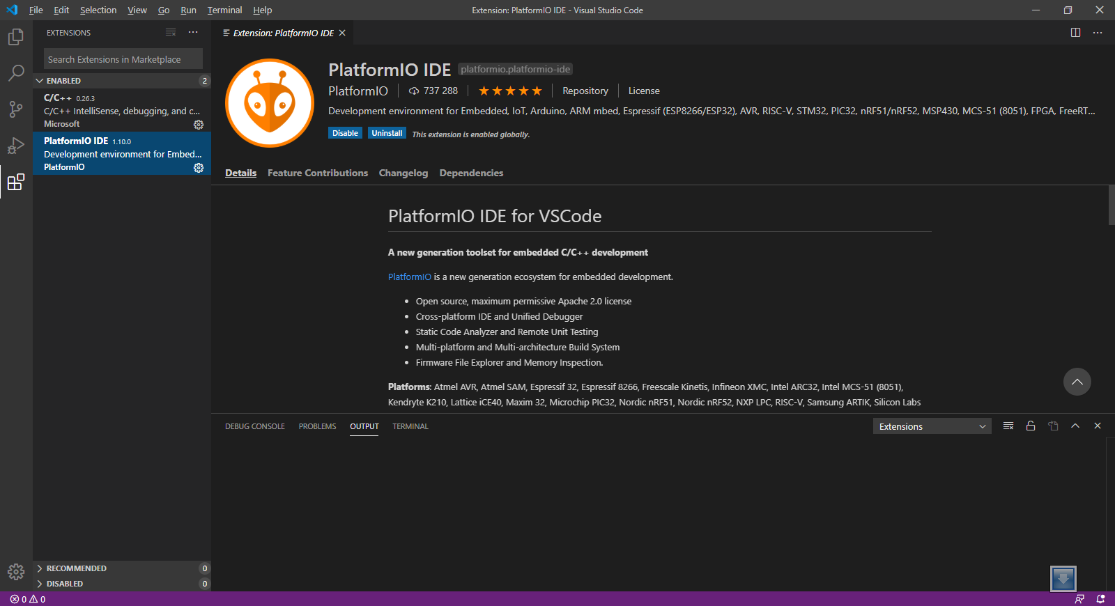

    I installed VSC, then PlatformIO. I seem to have VSC installed, but I don't know how to create a new project.
    According to this description: Quick Start I should have an icon with a house (PlatformIO Home) in the bottom left corner. In my case, nothing like that appears.
    What is wrong?

    Exactly right. It shows up as installed, I'm just missing that house icon on the bottom bar.

    In my case, the icon is not there. This is what it looks like:
    Visual Studio Code + Platformio - Installed, and I cannot create a project. [/img].
    I think I will uninstall the extension, then VSC and try again to install everything one by one.

    I uninstalled, reinstalled. PIO Home appeared, but only once. I imported the project from this topic Link . It imported with errors about header files. Then PIO Home disappeared somewhere. The extension is visible as installed.
    Now it has reappeared. I don't understand any of this, it runs when it wants to.

    OK. Only this PIO Home rarely appears to me in Visual Studio Code. Here's the problem. It has only appeared to me 2 times, and most of the time it is not there.

    During a session it doesn't seem to have disappeared for me yet, but after a restart it hasn't. It has appeared 2 times so far, but with a long delay after starting VSC.

    This icon appears with a slight delay after starting the VSC, simply the module loads and it takes a while, depending on the computer, if it is weak it may take longer.

    I noticed this, but waited over an hour for the extension to run.
    I may try again to uninstall everything one at a time and remove the leftovers from the disk. Then one last try.

    Topic probably out of date but I had a similar issue a while ago.
    It turned out that the PIO extension was deemed unsafe and therefore globally disabled.
    I clicked on it in the Extensions window/list and there was this shield icon. After another click on the shield in the main window I could click to trust PIO. And now it works.

How do I open PlatformIO Home if the house icon is missing?
Use the PlatformIO view on the left Activity Bar. 1. Click the PIO icon. 2. Click Open. 3. Use New Project to create a project. This mirrors the house icon’s functionality and lets you proceed even if the status-bar icon never appears. [Elektroda, khoam, post #18525987]
