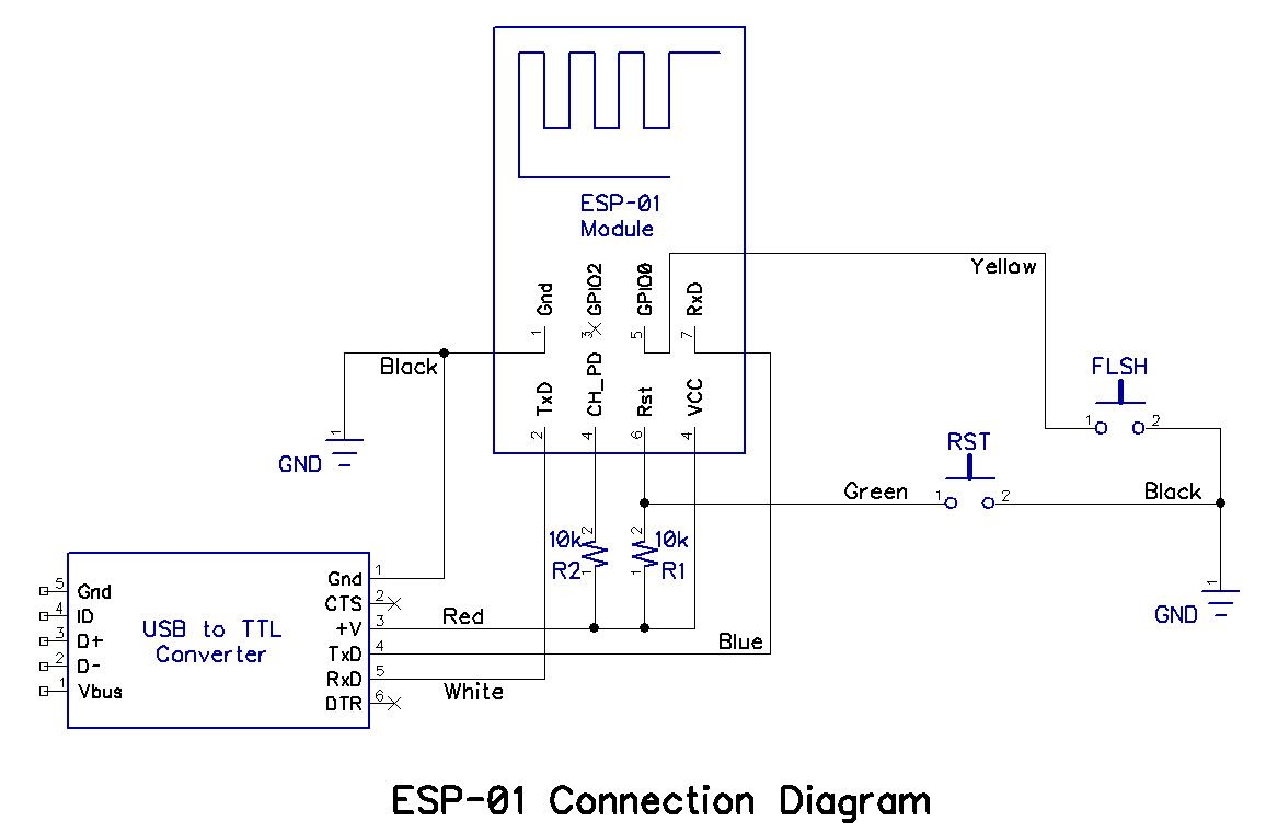

    I have written a simple program to blink the LED. The program has compiled, when I press Upload it doesn't want to connect to the ESP
    "Auto-detected: COM3
    Uploading .piobuild.bin
    esptool.py v3.0
    Serial port COM3
    Connecting........_____....._____....._____....._____....._____....._____...............__________
    A fatal error occurred: Failed to connect to ESP8266: Timed out waiting for packet header
    *** [upload] Error 2"

    I am using a link 1.0 esp module mounted in a socket, so it is connected correctly. When using the arduino it works. The problem occurs when I use the PlatformIO.

    After modification to form:
    [env:esp01_1m]
    platform = espressif8266
    board = esp01_1m
    framework = arduino
    upload_speed = 115200
    monitor_speed = 115200
    monitor_dtr = 0
    monitor_rts = 0
    still message:
    Looking for upload port...
    Using manually specified: COM3
    Uploading .. pio\n_1mfirmware.bin
    esptool.py v3.0
    Serial port COM3
    Connecting........_____....._____.........._____.........._____.........._____....._____.........._____
    *** [upload] Error 2.

    After changing the platform.ini, the programme was uploaded successfully, but it does not start. It does not show any errors.

  • Upload log shows flash completed and verified
    #24 20800473
    Interval
    Level 32  
    Posts: 1731
    Help: 186
    Rate: 441
    Ok, the diode when uploading behaves like when uploading with Arduino, it blinks.

    Ok, I defined the "pin" as 2 and it works. Thank you very much for your time and help.
