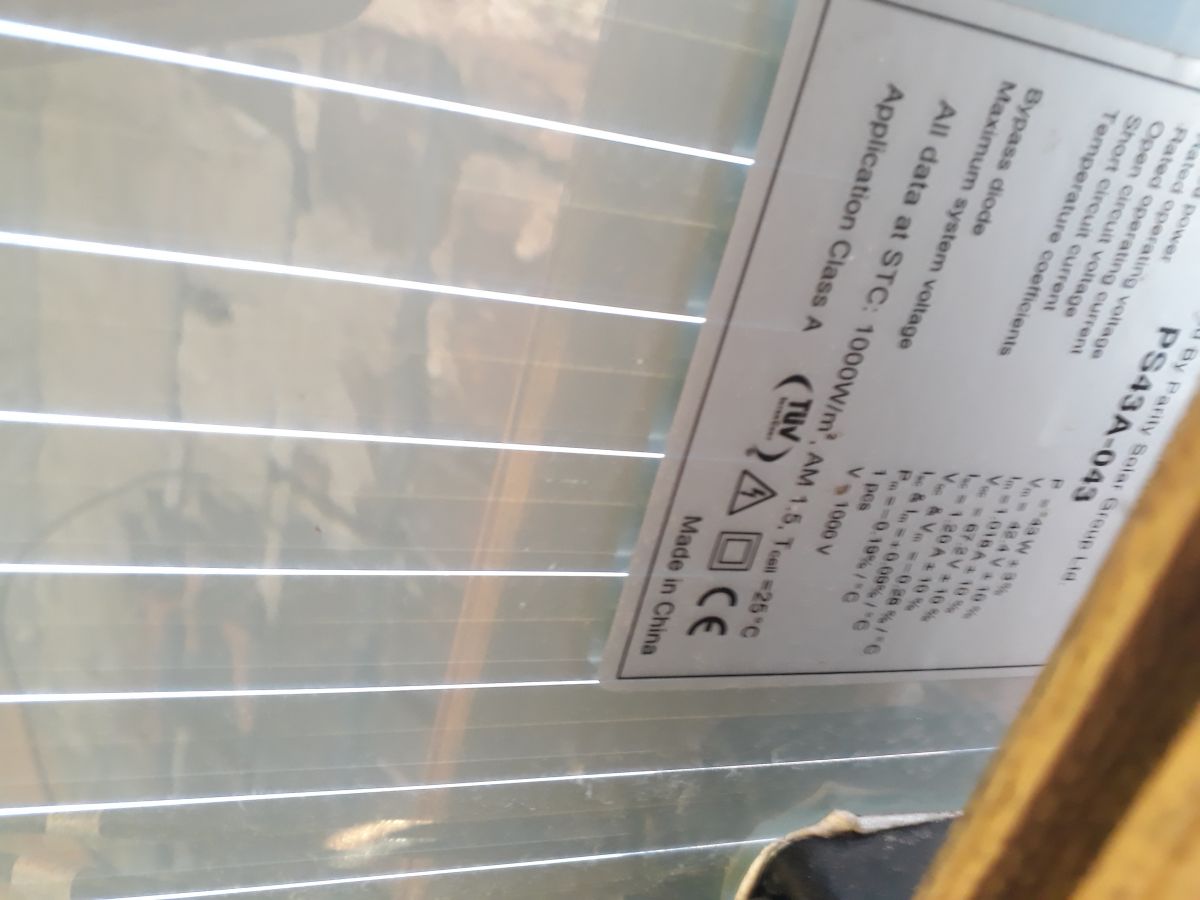

    Hello, I have recently added a windmill to my mini solar farm and the thing is whether I can connect the panels and the turbine to one regulator from the panels. I have 5 panels, I will provide a photo with the parameters below, I have the ML 2420 regulator connected to them, it is 20A with 100V and AGM-100 12V 100Ah battery. panels please help Connecting Photovoltaic Panels to Windmill Using ML 2420 Regulator and AGM-100 12V 100Ah Battery

    Hello, from what I understand, you want to connect the fan to the panel regulator. This is not possible on this controller. You need to look for a hybrid regulator or use a separate regulator for the fan and connect it in parallel to the battery.

    Oh, because I once read that the diodes go to one regulator. Wouldn't those two controllers conflict with each other?

    The M300 at its current price is not a good choice. It will be more advantageous to buy the S300, and this one usually has a charging controller in the set. Then you simply connect the output of the turbine controller to the battery and that's it.

    And one regulator will not work for the other somehow not favorably? And in total, I could easily add one more 100Ah battery? Is it rather too little current to charge?

    Each of the regulators will limit the voltage to the value needed to charge the battery. However, when there is sun, there is no wind and vice versa, we are talking about wind sufficient to drive the turbine so that it can work. Most turbine regulators, when the wind is too turbulent, make an artificial load to slow it down and protect it from damage. In contrast, the panel regulator will simply disconnect the panels if the voltage exceeds the upper value on the battery.
