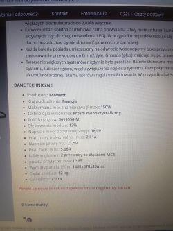

    I have a 150W panel with the following parameters:
    Number of solar cells: 36 (SS50-M)
    Module efficiency: 13%
    Optimum power voltage Vmpp: 18.0V
    Maximum power current Impp: 2.81A
    Open circuit voltage Voc: 21.5V
    Isc short circuit current: 5.08A
    connected to the WP35 30A 12 / 24V LCD charging regulator and 84ah battery.
    Directly to the battery I have a FW03-12 wind controller (300W 12V) and a S-300 wind turbine (300W 12V), the whole system is powered by two dahua cameras and an LTE router with a total power of 32.04 (2.67A) - and so on truth does not expel and provides little energy.
    I would like to add an additional 160W module to the installation, which I already have, I realized that I should connect the panels in parallel and secure them with diodes ...

    Etoo71 wrote:
    I will also stick to the topic :) .
    (...) I would like to add an additional 160W module to the installation, which I already have, I realized that I should connect the panels in parallel and secure them with diodes ...
    e.g. 50V 10A from the positive wires of the panels to the regulator, only compare the voltages of the panels

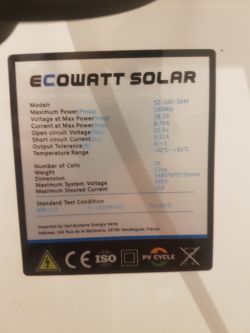

    The first photo with the parameters of the new 160W panel, the second is the specification of the already installed 150W panel.
    Connecting 5W Polycrystalline & 10W Monocrystalline PV Panels with Charging Regulator Connecting 5W Polycrystalline & 10W Monocrystalline PV Panels with Charging Regulator
    How do you see it?

    The voltage is ok. And if the diodes are not with heat sinks, then you need a higher current, so 15-30A.
    These parameters from the second photo do not match each other, the current will be about 8.5A and not 2.81 as in the specification
  • #28 17882638
    Etoo71
    Posts: 25
    Rate: 7
    Earlier, I did not pay attention to it, maybe it is just a specification error on the website, I will send a photo of the plate on the panel right away. In any case, I have two identical 160W panels in emergency. As for the diodes, I think that with the help of the electric one, it will match something, but in fact I have hopes that it is just a problem with the charge regulator.
